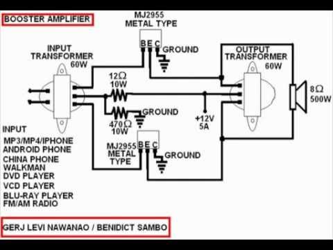

It's Ohm's law. The transformer you want is a step up transformer. That is how my old Motorola booster could deliver decent power into an 8 ohm load from a 12 volt supply. That is why car speakers are almost universally 4 ohms.

Does your booster amplifier is something like below and would you like to share it .may be it will prove usefull for me.It's Ohm's law. The transformer you want is a step up transformer. That is how my old Motorola booster could deliver decent power into an 8 ohm load from a 12 volt supply. That is why car speakers are almost universally 4 ohms.

BOOSTER AMPLIFIER - YouTube
Looks like you have solved it.
