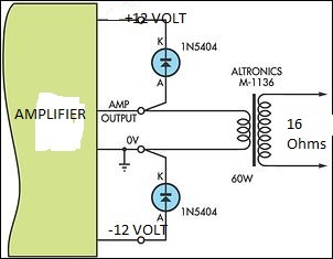

What if I connect such an amp as described by you to a trafo of winding primary:secondary ::1:2 to match it to a 16 ohms load ?I had imagined so.

the impedance ratio is inversely proportional to the turns ratio squared.What if I connect such an amp as described by you to a trafo of winding primary:secondary ::1:2 to match it to a 16 ohms load ?
1:2 turns gives 4:1 impedance.
i.e. connecting a 16ohms load on a 1:2 transformer lets the amplifier see a 4ohms equivalent load.

Thats the point i want to mention. If I will be able to get such a amp which can provide power in the range of 30-50 watt to a 1 ohm load even on bridging. I can fed that power to a 16 ohms speaker via such a trafo described above.This method will somehow solve problem and save me from making a smps to raise the supply voltage.the impedance ratio is inversely proportional to the turns ratio squared.

Nobody said transformers "increase power" but that they turn the horn 16 ohms impedance into something the amp likes.
The 12V amplifier can easily produce 15/16W RMS into 4 ohms, if you use it bridged.
A 2:1 turns ratio transformer, which means 4:1 impedance ratio, can match that 4 ohms amp to one 16 ohms horn.
Of course, such speaker impedance matching transformers (usually autotransformers) do exist, but are not widely available, I´d guess that even less in India.
