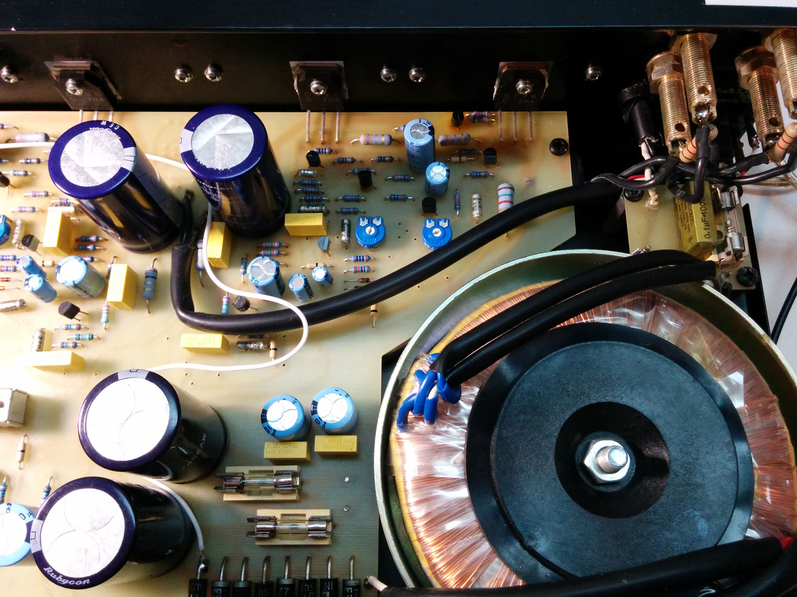

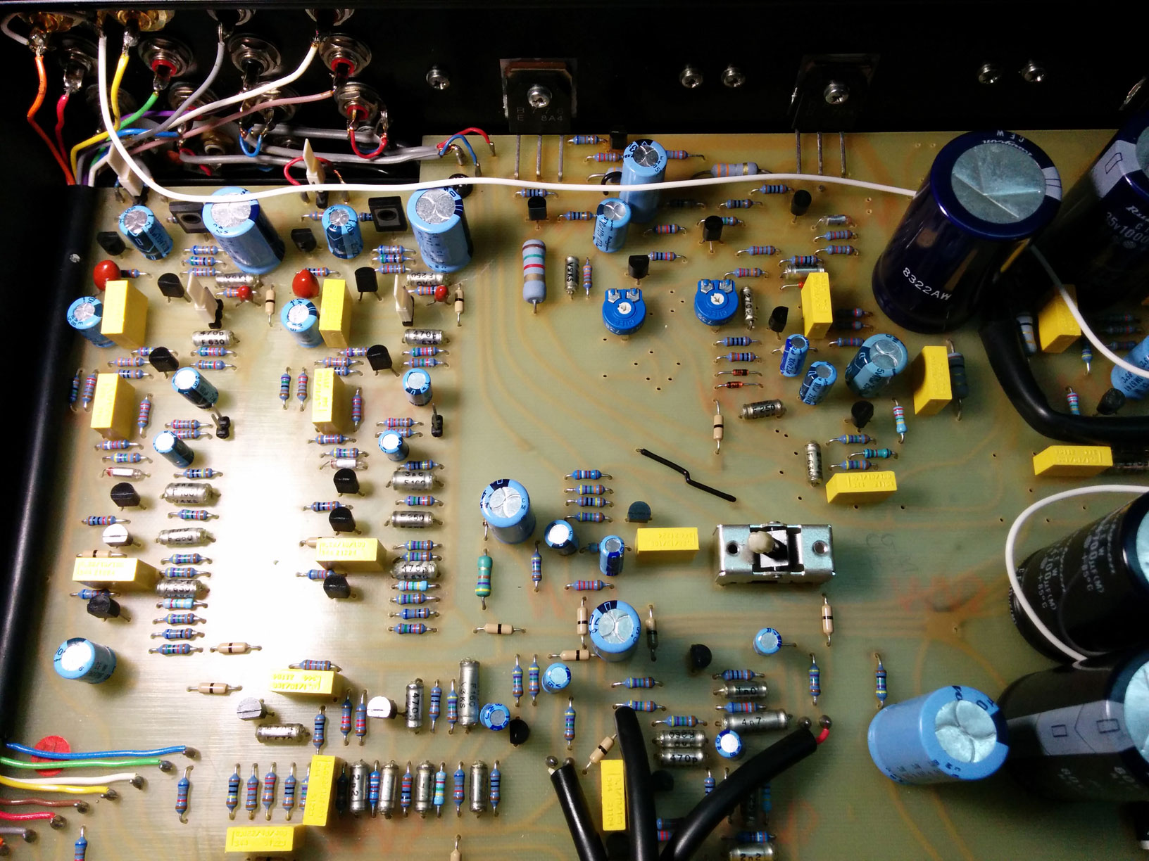

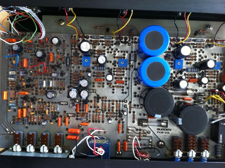

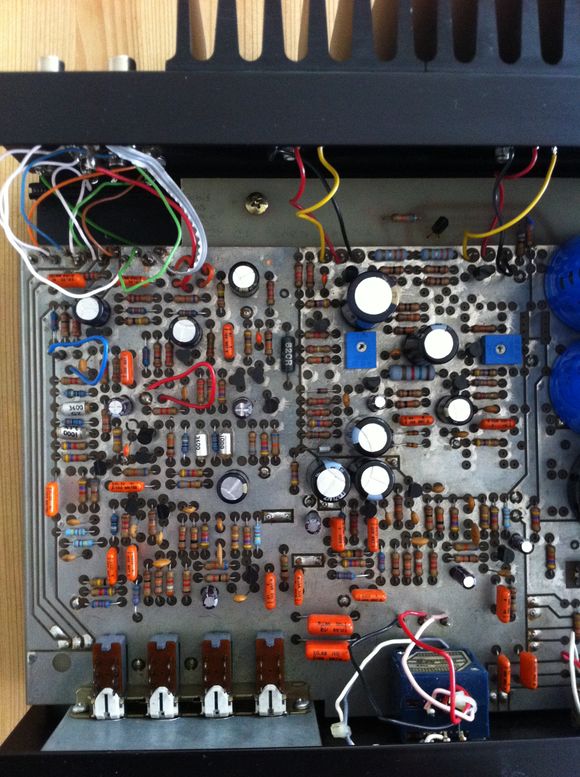

After a long time, finally some pics of my A28 with brand new caps :)
Many thanks to Nikolay for the 2 blue BC caps 10000uF/40V, and to Patrick for his helping hand with Mouser order. Nice to see concerned DIYer's :up:
I've encountered some troubles due to caps size and "extended" existing holes for them to fit in.
Be carefull when you desolder components, PCB traces are IMHO very "weak".
The amp is sounding fine, but the right channel is much warmer than the left.
Could someone point me to what to check and "howto" :cool:
Thanks for your help
Regards
Phil

Hello Phil,
The temperature difference is due to improper biasing of the output stages. You have to adjust the 4.7 k blue trimmer, for each channel, until you can read approximately 300 mA on your ammeter that should be connected to the fuse holder contacts. Do not forget to remove the fuse for this measurement. Unless you have two ammeters, do one channel at a time. Make sure you let the amp warm-up for at least an hour and readjust until it stabilizes. When this is done measure the voltage between the emitters of each pair of output transistors to confirm it is approximately the same.
Good luck!
Michel

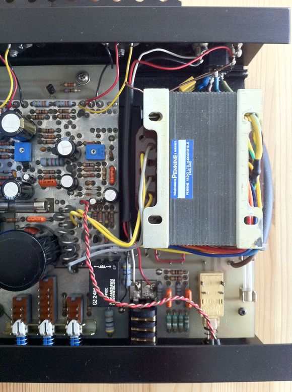

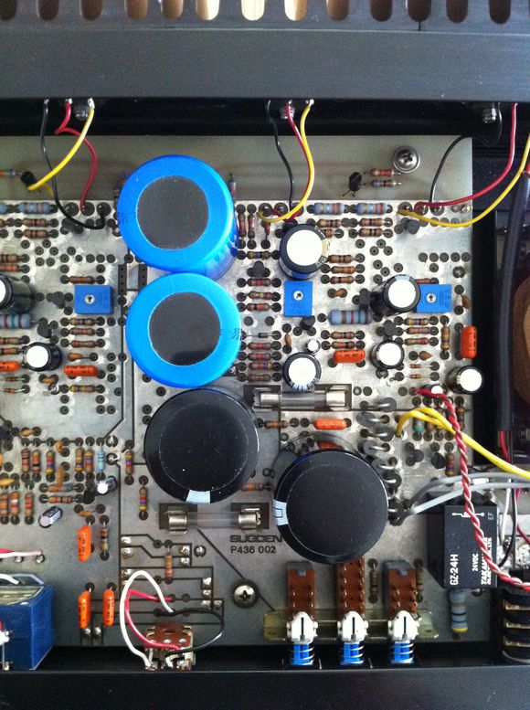

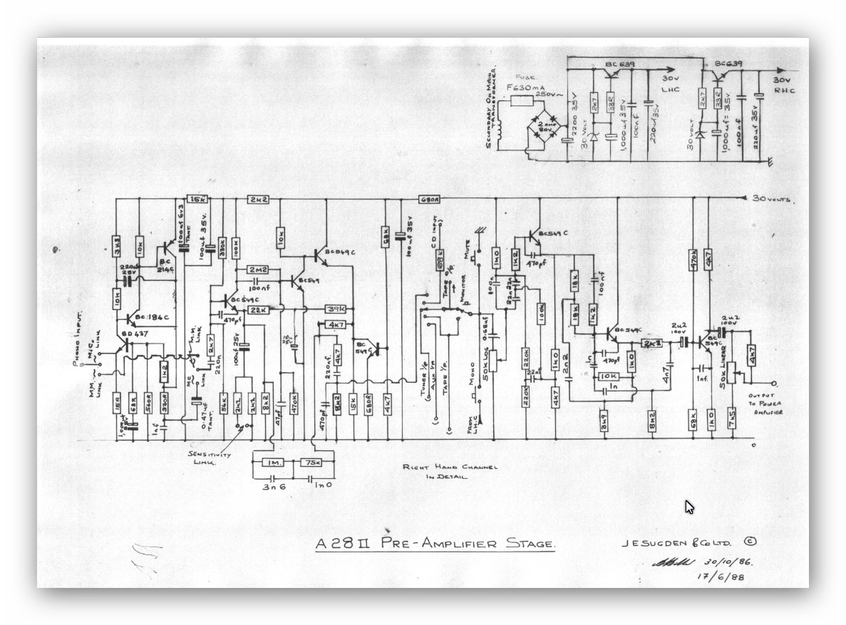

I am struggling with my next steps to try in order to fix the following problem. I was able to adjust idle current at 300 mA and set midpoint to 31.5 volts but I notice that I have some DC voltage on the speaker outputs.
When I turn the power on, the DC ramps up to 8 volts then after a minute it's down to around 10 mV. When I turn the amp off, the DC ramps back up again to around 10 volts and slowly trickles back down to o volts.
Also I notice a hum when I increase the volume with no audio playing in the aux input. I use an ipod in the auxiliary.

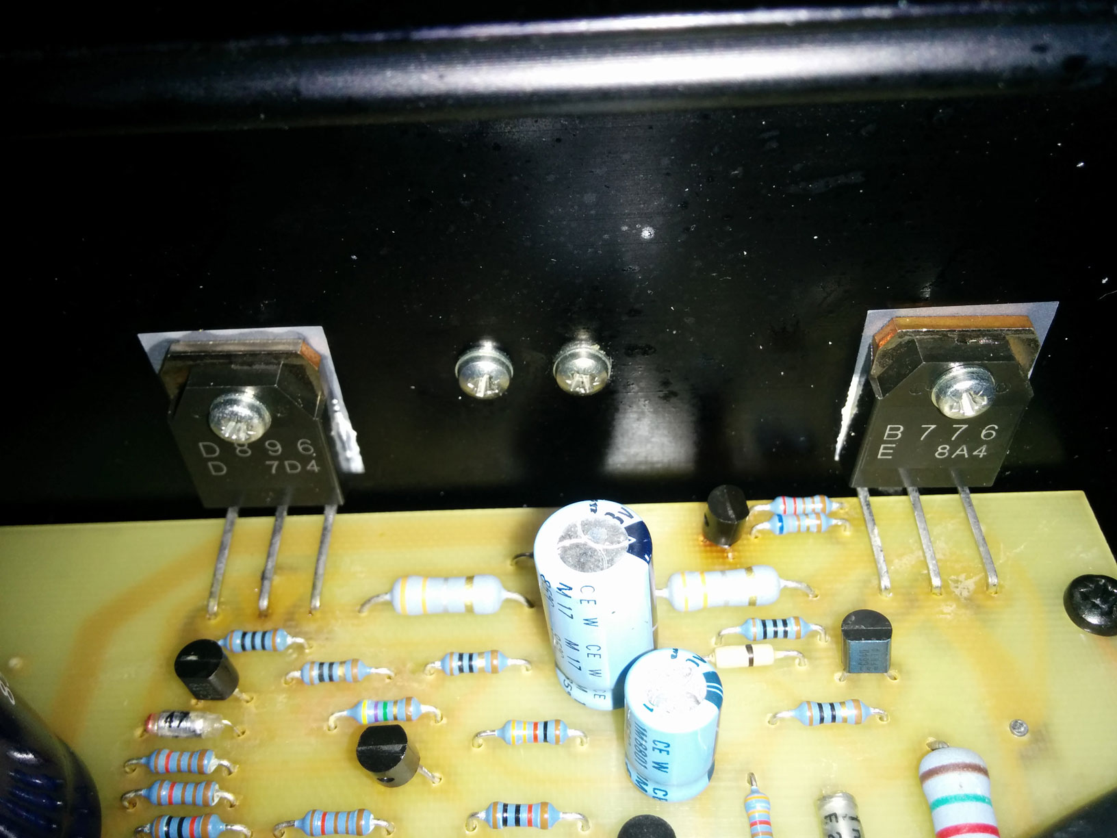

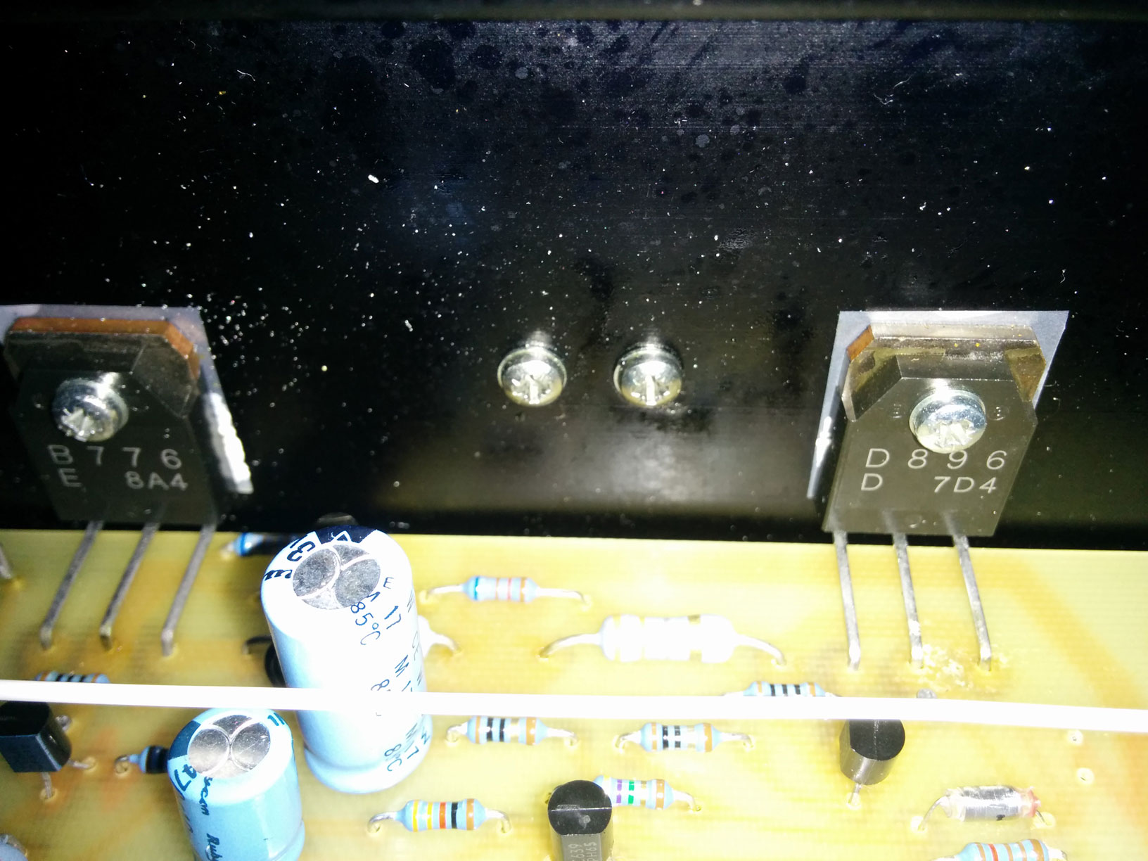

The person that gave me the amp told me that he had some capacitors changed. I am including a couple of photos as visually I cannot tell if they are original caps or not.

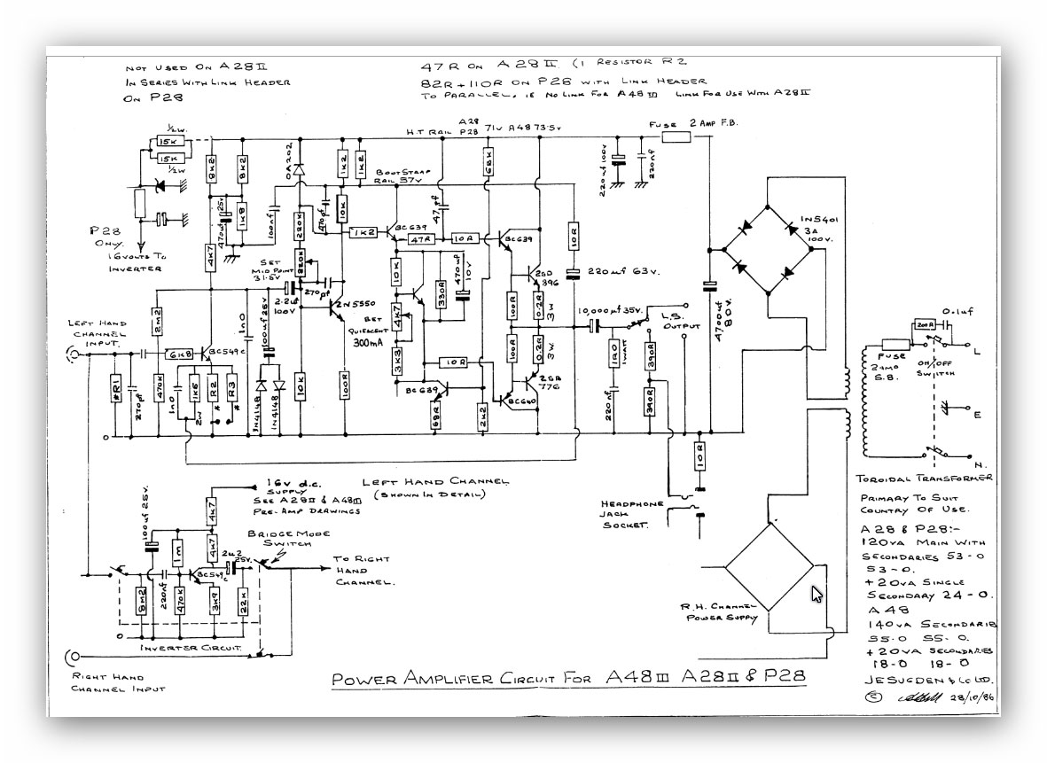

Can anyone pitch in some ideas to check ? I attached preamp and amp circuit.

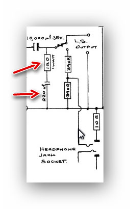

That's a good point ! I notice in the schematics a 1R0 and 220 nF. Should I be replacing the 1K2 with these components ?
Is 1R0 equal to 10 ohms or 1 ohms ? Is the capacitor an electrolyte with polarity ?
The previous owner told me that an audio shop changed the speaker terminals, so they most likely did not replace with the right resistors.
