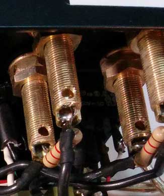

That's a good point ! I notice in the schematics a 1R0 and 220 nF. Should I be replacing the 1K2 with these components ?
Is 1R0 equal to 10 ohms or 1 ohms ? Is the capacitor an electrolyte with polarity ?
The previous owner told me that an audio shop changed the speaker terminals, so they most likely did not replace with the right resistors.
leave those in place - they're Boucherot filter , most probably crucial for amp's stability ;
those 1K2 resistors across speaker terminals - replace themwith 150R-220R
edit: that 1R (R is EU for Ohm) and 220nF (nonpolarized , you can see that from symbol ) are most probably on pcb , being connected pre-switch

Yes I found the 1R0 and 220 nF on the board. I will change the resistor as per your suggestion and get back to you with results.

I tried changing the 1K2 resistor to a 180 ohm resistor and it did not improve anything. Yes I see that route and can use the backswitch to enable my speakers after warm up and disable before shutdown.
Now I need to figure out why I am getting some hum in the speakers.
