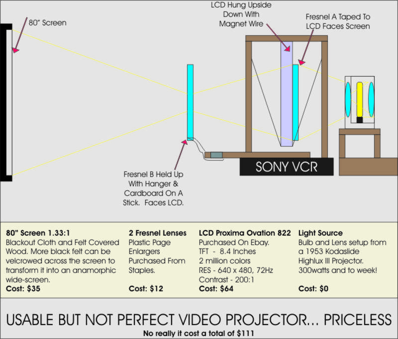

All you newbies pay attention it can be done. It only took me two weeks from first stumbling on the 100inch TV idea to building a working LCD Projector of my own.
Here is how simple it is to get started. Of course perfecting it is a never ending quest.

Makes it sound to simple doesn't it? All my friends are amazed when I tell them what I've built but as I begin to explain the details they say something like "oh yeah, hmm, that makes sense, not to hard" I feel like yelling "I don't see you guys building anything!" But I'm content when I realize I'm the one watching an 80 inch TV and they have to go home to their tiny 25 inch.
I'm searching for a new light source. As soon as I do I'll show you all some screen shots.
