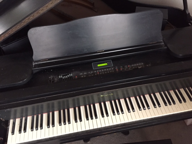

I've done something similar. 1916 PA starck cabinet with a GEM realpiano2. It is a mathematically modeled piano, not a sampled piano. I love the variable damper, etc...
NHT super zero's and a 10" NHT sub is what I use. I modeled so many different speakers, and even chatted back and forth with GEM developers. In the end, the bit of info that really clued me in was this developers statement:
"The output of a digital piano is meant to be reproduced by typical speakers, it is not intended to be reproduced by a speaker that is trying to be a string, or in some way trying to be an instrument."
good quality speakers with great attack (you can see them on my sound board on each side - I had removed the harp) and then a bit of normal sub to bring up the bottom end.
Anything else, and you need to work with your piano manufacturer to actually "take it to the next level."
