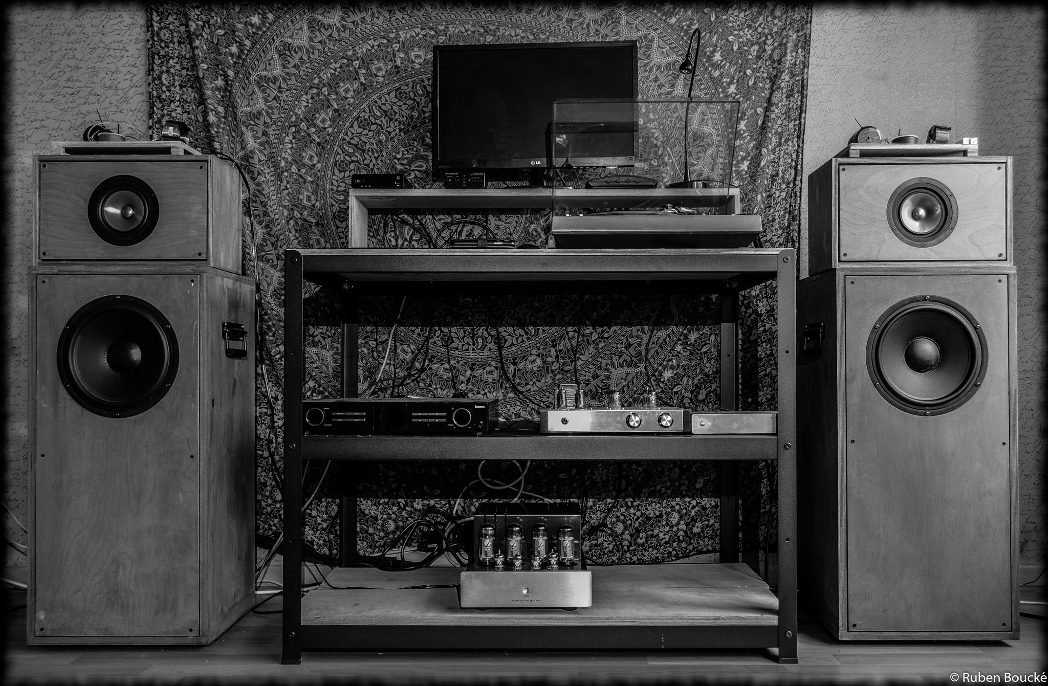

And you can use one driver to cover the sub and woofer part, but they need to be close to the midwoofer and tweeter (one box) and at least in stereo for this application. That is what i do with my waw with an FR driver and a Scanspeak 10" woofer, with an 1st order CR at 250Hz. Not one mono subwoofer somewhere in the corner...
