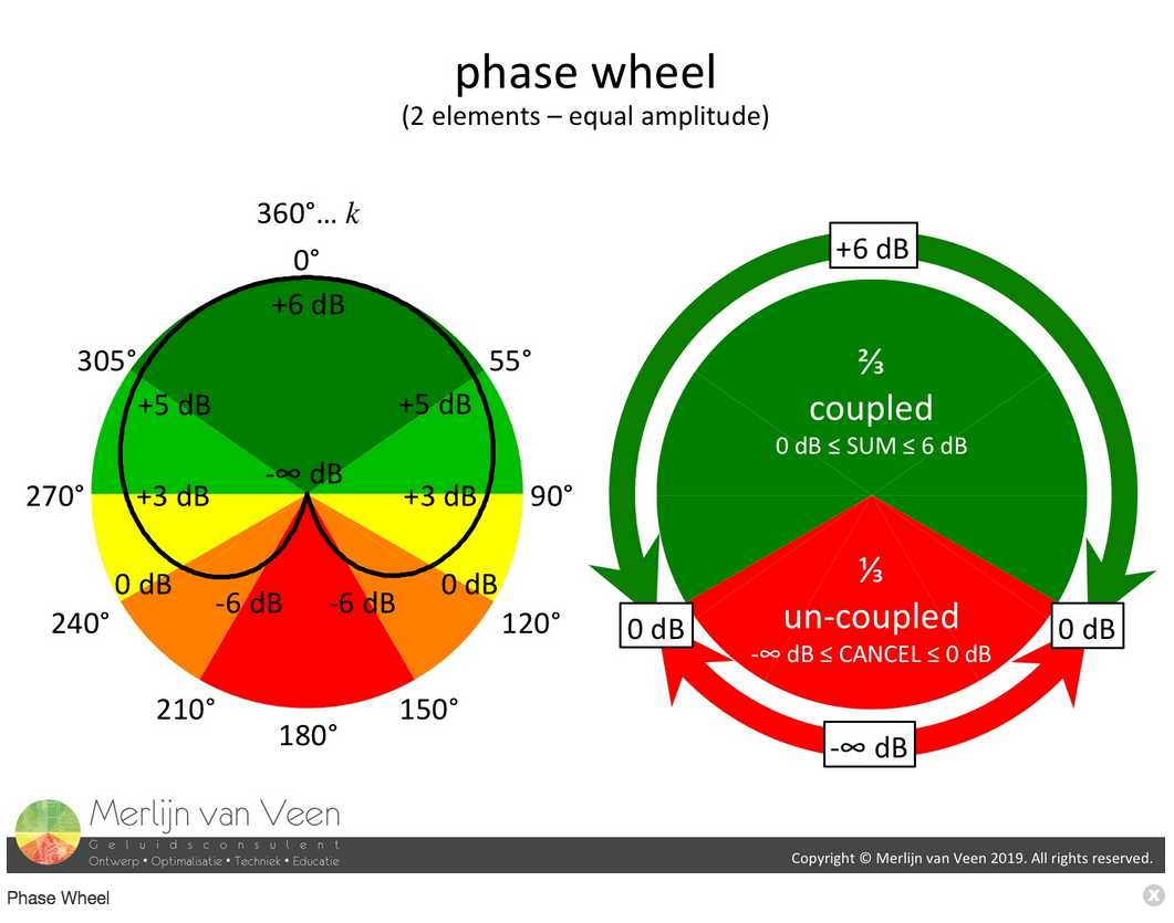

When testing the phase shift of a class D amp with a scope and signal generator, does the amp have to be loaded with a non-inductive resistive load?
Since an inductor can introduce up to 90 degrees of frequency dependent phase shift, you would want to use a non-inductive resistive load to test an amplifiers phase shift.
Moving coil speakers all have inductance which varies with frequency.
Worst case phase shift in class D amps are under 90 degrees, and so far above a subwoofer's pass band (a few degrees ~2kHz, 70 degrees at 20kHz) they would have no effect on the response.
At 0 degree (or 360 degrees, one cycle behind) phase difference, two sources add +6dB, at 180 they cancel.
In between, at 90 or 270 degrees difference, there is still a +3dB gain:
Best of luck phase aligning your system!

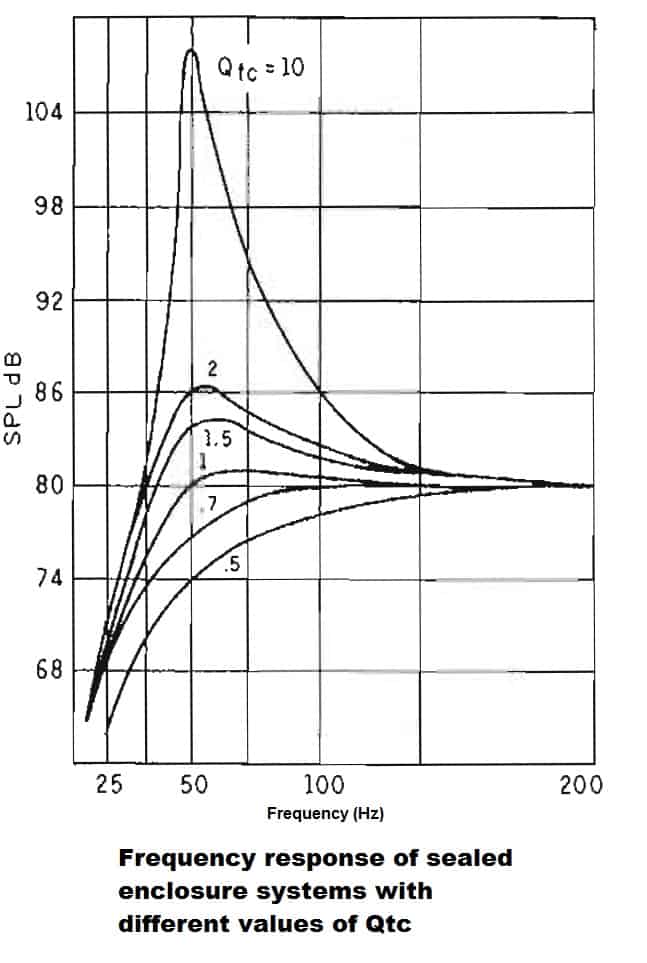

Either the extra space in the box is making the sub sound better (seems like the lower end is better) or the class D subwoofer amp just has better control of the sub.
Now that space where the plate amp was which has the divider, given the plate amp is not there, would that area act to affect the box tuning?
If so I may try to remove as much as I can, but leave maybe a 1" wide piece in the middle to serve as a cabinet brace.
When a driver is put in a sealed box, it's Fs (free air resonance frequency) is raised to Fc (closed box resonant frequency). It's Qts is also raised to Qtc, high values of Qtc cause an underdamped peak in response at Fc, which may be perceived as "boomy", "loose" or "one note", as the response drops steeply below Fc, and "rings" after the signal stops, regardless of amplifier damping control.Either the extra space in the box is making the sub sound better (seems like the lower end is better) or the class D subwoofer amp just has better control of the sub.
A Qtc of 2 will cause a peak of +6dB, values a bit under 1 will have no peak at Fc, and a less steep drop below.
Manufacturers may use inexpensive drivers with weak magnet structures in small cabinets for more "boom for the buck".
A larger sealed cabinet volume will lower the Qtc and the frequency where response starts to drop.
Apparent sealed cabinet volume can be increased by ~15% by adding damping material like dacron or fiberglass, though too much stuffing will reduce apparent volume.
