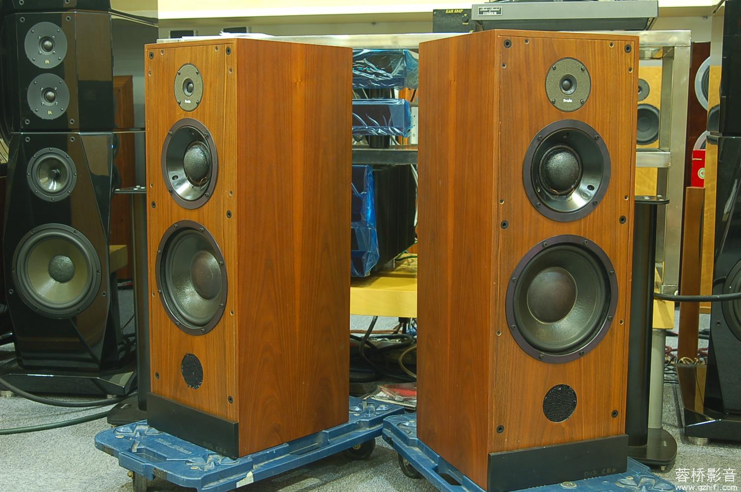

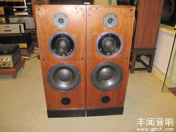

Proac with their EBS 20-30 years ago filled the port with tight packed plastic drinking straws they said to reduce/eliminate port chuffing, does this work before I go the trouble to do it?

I went to the local and got 3 packs plastic 100 per pack, lucky they were only $1 per pack. Put the sig gen on the sub at 30hz got the port noise, grabbed a bundle around 140 straws put a tight elastic band around them bunged them into the port and hey presto half the port noise disappeared, so yes it does work to a degree.
Then checked the other sub, same parameters, no port noise (with no straws)!!!!!!! Took out the straws of the one making the port noise and looked deep into the port and noticed a 2" rubber sealing bung for the speaker wires to the amp box on the back had popped half out, tested again after pushing it back in, NO PORT NOISE!!!!!!!
So if you have port noise, and it's not something wrong like I had, yes it can be reduced with port straws by at least half.
