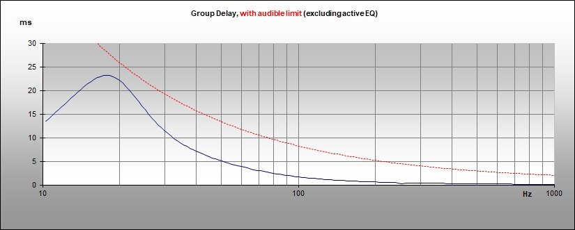

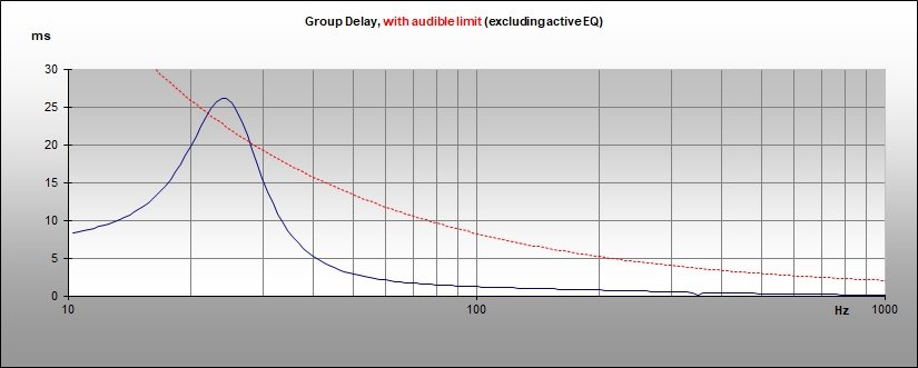

Here is the same driver, enclosure and tuning but with a Bl = 17 (Qts = 0,38) and a Bl = 24 (Qts = 0,19):
Bl = 17 (Qts = 0,38):
With Bl = 17:
Re 5,20 Ohm Qms= 14,09
Le 1,15 mH Qes= 0,39
0,00001 Qts= 0,38
0,00001
0,00001 SPL (max)= 95,24 dB/2.83V/m
Bl 17,00 Tm Mmr (4pi no baffle)= 14,36 g
Mms 105,0 g Mmr (in box)= 21,00 g
Rms 1,55 Ns/m Vas= 228,3 liter
Cms 0,22 mm/N fs = 33,11 Hz
1,00E-06 Rams = 2,89E-07 Ohm*s
d 330 mm Sd = 855,30 cm2
Box
vented
Vb1 155,0 liter Fill matrl: Polyester fill (PET) *note
Filling 15% Fill amount: 83,7 gram
QL 7 Eff.Volume VB' = 161,1 liter
fP 26 Hz Total Q = 0,61 (in closed box)
QP 100 fsbox= 51,49 Hz (in closed box)
#vents 2 pcs. Baffle Step: Baffle Width = 42 cm
diam. 84 mm Calculated Port length = 216 mm
With Bl = 24:
Le 1,15 mH Qes= 0,20
0,00001 Qts= 0,19
0,00001
0,00001 SPL (max)= 98,59 dB/2.83V/m
Bl 24,00 Tm Mmr (4pi no baffle)= 14,36 g
1,00E-06 Rams = 5,76E-07 Ohm*s
Box
vented
fP 26 Hz Total Q = 0,31 (in closed box)
Well, those TSP aren't possible, that's what I suspected. Editing one parameter without the other interacting ones is very convenient for any theory but, unfortunately, doesn't provide any proof for said theory.
Well, the higher Bl lowered the Qes hence Qts. In the end what matters is the result. A lower Q driver an a vented box have a higher port response Q, which results in a higher GD at Fb, that's all.
