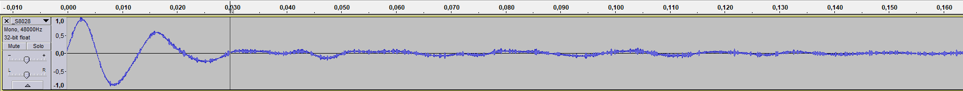

(the measurements made by a sound engineer person):
The first measurement was taken with a completely different environment and also contains reflections.
Okay, what about the Paradigm vs RCF?The first measurement was taken with a completely different environment and also contains reflections.
OK, then YES if you make the frequency response exactly the same using FIR DSP, then the group delays would be identical. This is kind of a dumb case to bring up.
Yes, I agree but I did it to correct the claim.
Maybe we should constrain the discussion to systems where there are no external filters (e.g. no DSP equalization)?
That's not possible because without filters you can't get them to the same fr.
It's hard to say because the time scale is unreadable. The Paradigm measurement frequency is on its resonance, and the RCF is above. The bad decay of the Paradigm does not necessarily mean a high GD. GD and delayed decay are not equal.
