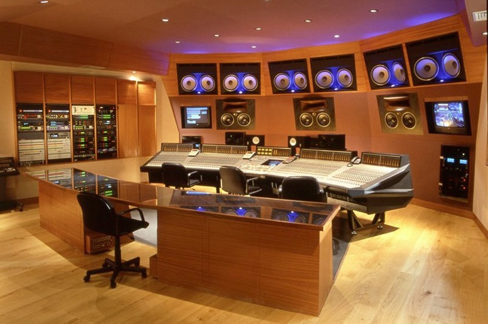

My reference include system implemented with something like that http://www.reyaudio.com/large-e.html
( RIS-1c)
And i might be ignorant maybe, but don't confuse the effect of loudly replayed low end with how it sound/feel despite i was playing things like that ( even produced some tune like this as a hobby) on big system outdoor regularly and compared to system shown up on daily basis in my job ( which was to record/mix 'real instruments' mainly):
So i can testify i stand with my statement and what it imply.
( RIS-1c)View attachment 1207007
..on big system outdoor regularly and compared to system shown up on daily basis in my job ...

Your picture shows quad 12 or 15" speakers with what looks like a 4in / 10cm diameter, maybe at best 6in / 15cm, port. That's somewhere roughly from 1/10th to 1/40th sd port surface area. Modern HiFi speakers tend to feature at least 1/4 sd, PA subwoofers 1/2 sd or more port surface area.

Yeah I also looked at the hole in the picture with huge quad woofer box, it must be wine bottle holder 😀 It really looks too small for a port, it could work for one woofer but four, must be quite noisy if playing any louder.
edit. here is another photo, port is somewhat bigger but looks quite small still. Compare to the mains, there seems to be about as much port for one woofer. https://www.audioheritage.org/vbull...0daca671d6c567&p=318766&viewfull=1#post318766
Here is another: https://www.avforums.co.za/threads/...ita-infra-sonic-system-at-bop.4948/post-58848
mark100 installs proper low velocity ports on his 😉 https://www.diyaudio.com/community/threads/syn-11-a-one-horn-5-way.393087/post-7400021
Kinoshita's are built to order, almost custom so i guess the picture i linked was for an audiophile customer not in need for high output, i don't know.
The one i heard had the wide port as in Bop studio pictures.
Mark make nice loudspeakers we all know. But with all deserved respect from my part he his not Shozo Kinoshita.
It seems you are not aware of who the guy is Tmuikku? I suggest you take a look at who he his and why he his known for ( as well as by who he have been endorsed, hint: founder of Westlake which changed for Kinoshita's in his multi million dollars control room's design when he first heard them... Yes the usual suspect from my side when talking about room acoustic: T.Hidley).
So for one time and with all due respect let me say this to you: if you have not heard them you should not comment on the technical choices made even if they seems strange or seems to go against physic ( as i was astonished by them too when i finally got the authorisation from studio owner to remove the screen which hidden them in the room i used them).
If you look at the use he made from his own horn design ( TD-4001) and drivers ( TH-4001) in his own design there is 'strange' approach too ( wrt what they offered under the 'consumer' brand TAD).

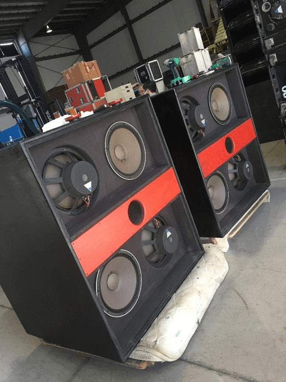

As has been long and well established, for example Maximizing Performance from Loudspeaker Ports - JBL, Infinity - AES, 2002, small port surface area adds compression, harmonic distortion, and turbulence / noise. That's a lot of added forms of distortion.
15" not 12", Tad drivers and mounted in a way to reduce second harmonic distortion by cancelation on an already benchmark driver for low harmonic distortion amongst HE drivers but more generally amongst drivers. For port size i won't repeat what i told to Tmuikku.

Yeah, you never heard the system i linked, don't even made the effort to read about the guy behind it and was able to down it on fire. And you make assumption without even knowing me... Let's say it's for the most laughable in my view.
But i don't know, maybe your a fanboy of the brand you linked ( which might do some very nice thing, don't take me wrong, i can't say as i've never heard it), or someone which like dogma as you seemed to be dishearted (to the point to make assumption on my part and be kinda aggressive) by a point of view which is not yours?
Anyway you doesn't seems to have read my comment or even understood what it implied...
I don't have distortion number to discuss as there is few system like that accessible as multi million dollars control rooms are not that often encountered and measurements made on them are usually well kept secrets. But i can tell you one thing: people investing this amount of money on a system wait for justification of money spent. And results.
Here you can read about the studio pictured in the link i gave about Kinoshita's Rm series loudspeakers, how they are implemented in there too:
https://www.avforums.co.za/threads/...ta-infra-sonic-system-at-bop.4948/#post-58848
And here a bit of history about the place:
https://www.soundonsound.com/music-business/bop-studios-story
I'm sure it'll confirm your suspicious on the stompbox distortion the sub can be! Lol.
The place i heard them wasn't in this range even if more or less based on same loudspeakers ( Rm6 in place of 7mesa) and not non environnement but Hidley's previous design. Despite differences comments made sound familiars to me.

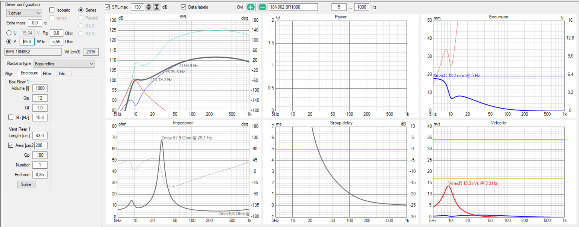

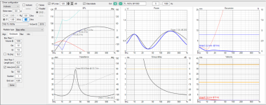

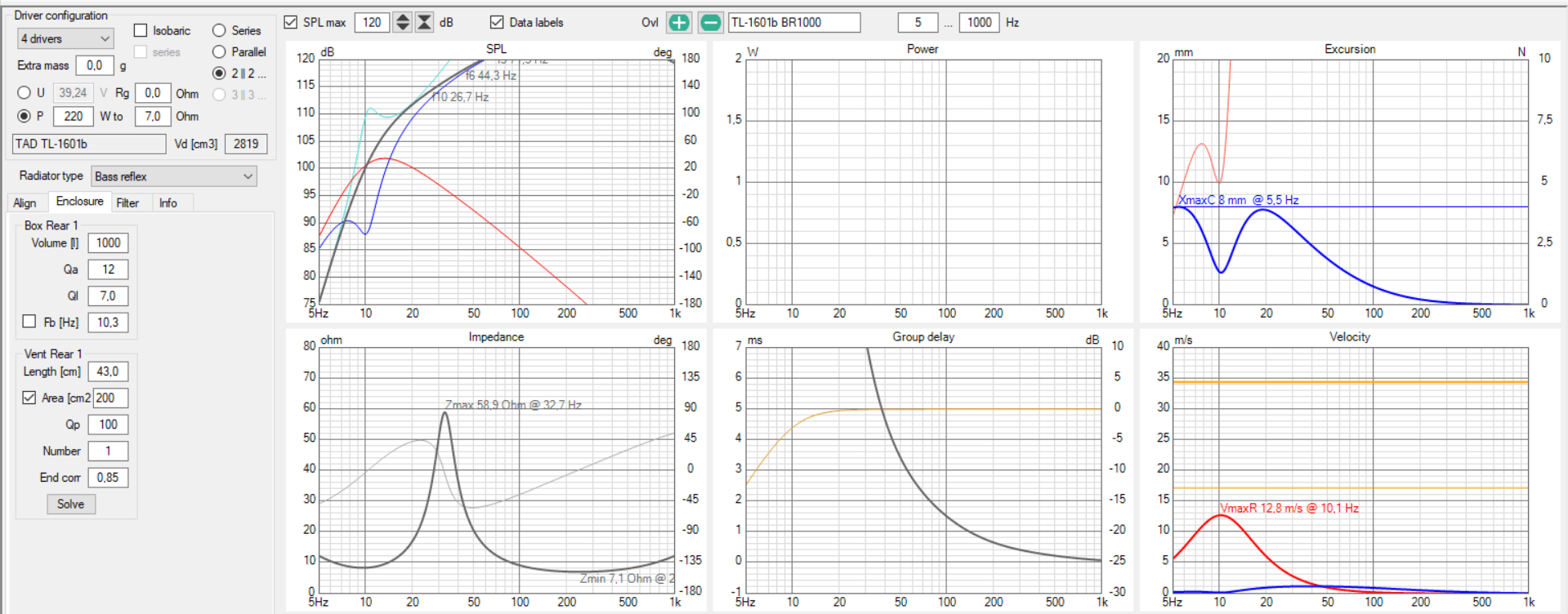

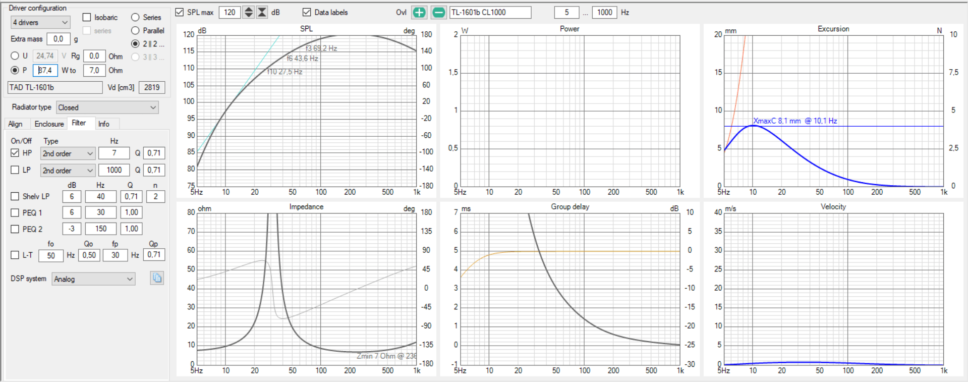

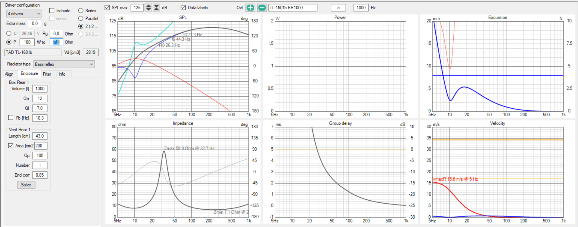

yeah I have no knowledge on Kinoshita, or basically any other designer, and never heard such speaker system. It likely works fine for what it is, seems to be a serious system.

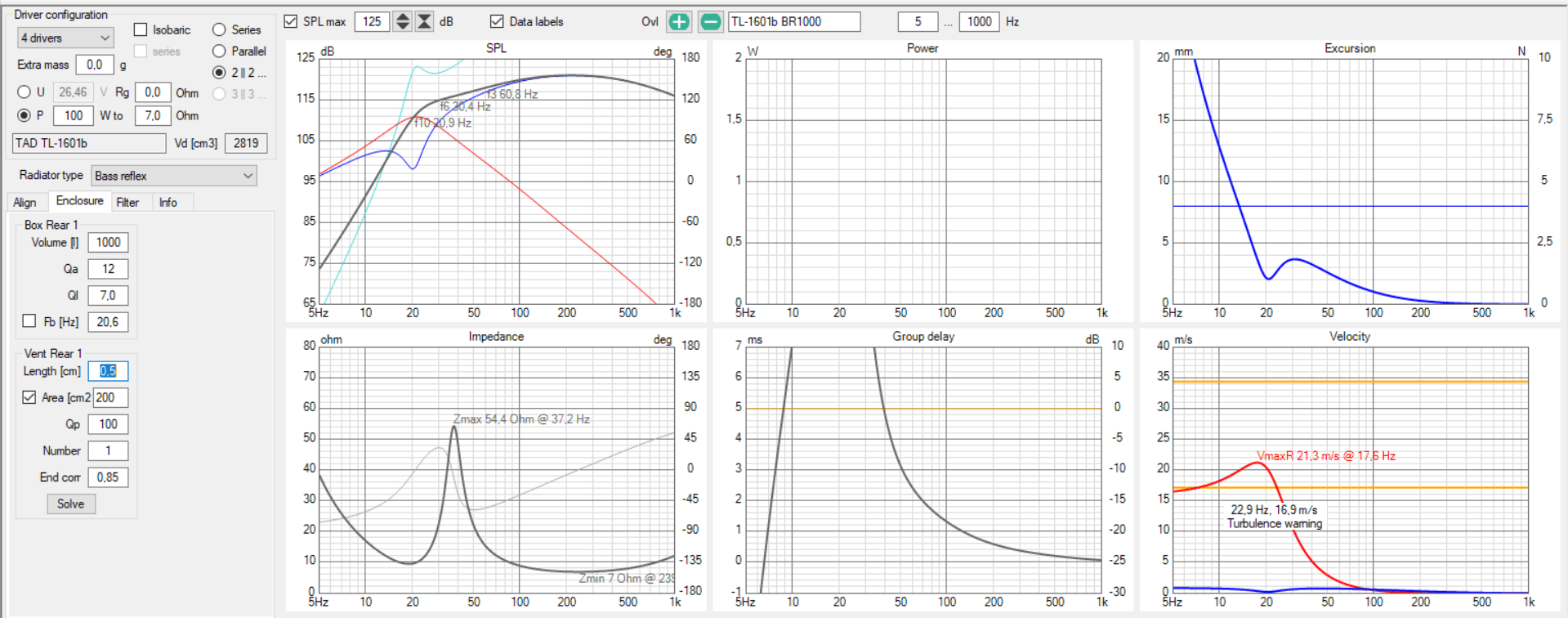

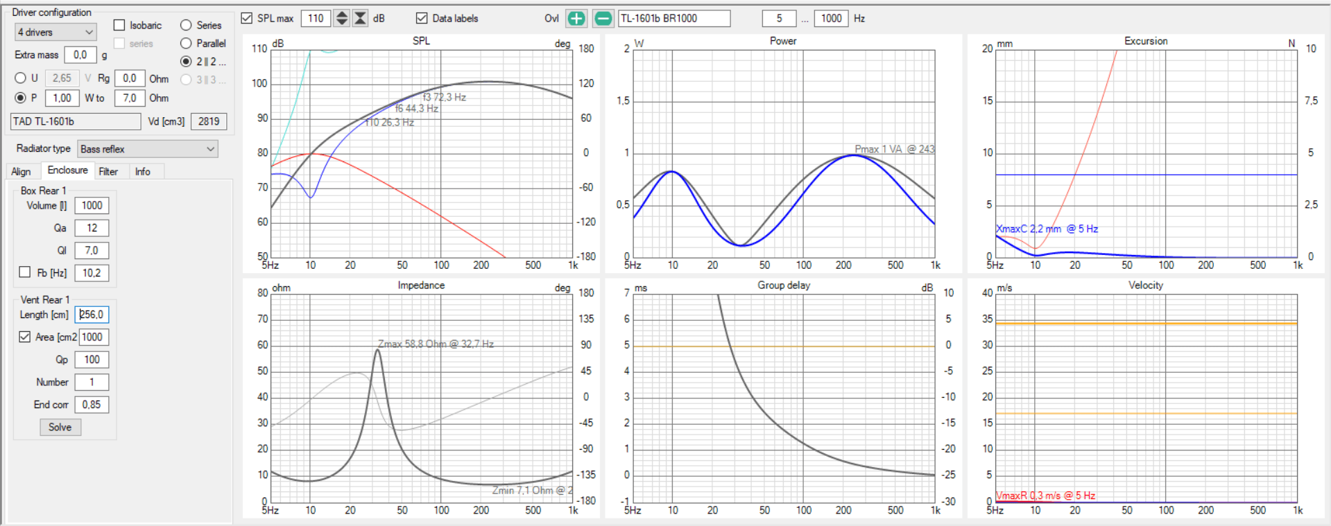

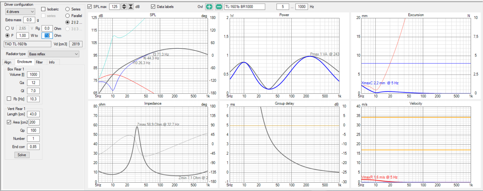

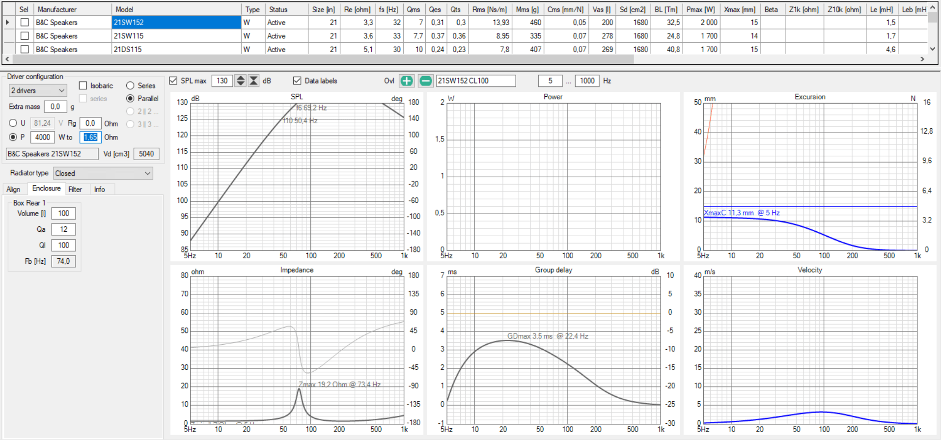

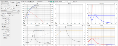

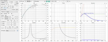

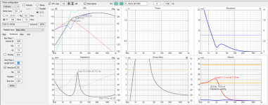

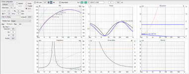

Found out RIS-1C bandwidth is mentioned to be 9-20Hz, internal volume seems to be something around 1000 litres. I don't know which drivers they are, found TAD TL-1601b specs from here http://www.hornstudio.de/1601b.pdf so using those to guestimate the speaker.
Plotting with VituixCAD enclosure tool using approximate of 1000l enclosure and 200cm2 port area and roughly 10Hz tuning, four TL1601b, the port length is modest around 50cm or so, not sure what the tuning should be so just questimating. If the port area is increased to 1000cm2 it would need to be several meters long for same tuning, so that's likely why it was chosen to be relatively small, it's more realistic. Port velocity drops as expected so seems that rules of the game are same for everyone 😉
Also, playing with tuning frequency (length of the port keeping area the same), then it seems that higher tuning makes port velocity faster. Turbulence warning in VCAD with 200cm2 port, adjusting port length longer so that tuning goes lower, and port velocity seems to drop. Perhaps because it's below drivers resonance or something?

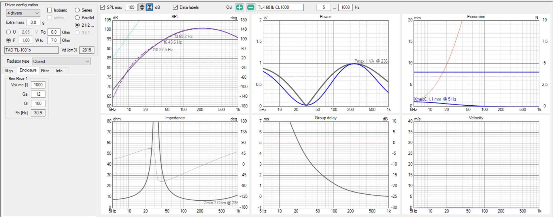

Then, using 1000 closed box the response is almost the same, even better on the infra frequencies, note the turquoise line on SPL graph which shows max SPL before xmax/power limit. Makes wonder why use port at all? So, perhaps they used different woofer, or modified one for this very special use case, or perhaps it is wine bottle holder?😀 Anyway, interesting stuff.
I wish I had a chance to listen legendary systems like these 🙂 They are most likely best what could be done back then, perhaps best that can be done today, optimized to specific application.
edit.
here is max output with reflex and closed. Reflex goes louder and turbulence warning is not reached. High pass filter is used to get max output around 10Hz on both. Reflex goes roughly 3db louder at 10Hz and perhaps port chuffing is not audible so it's not a wine bottle holder after all.
Reactions: krivium
Playing around with the simulator it takes about 4x 15" drivers, or two 21" to reach 100db at 10Hz with a sealed box. Some modern drivers crammed into a 100litre enclosure can do it, but of course pouring in power.
Then again on a 1000 litre ported enclosure even single 18" can do it, with great xmax though, likely more distortion with great excursion.
Perhaps there wasn't 18" drivers back in the day, perhaps the 15" they used was best that was available and that's what they used. Anyway, to reach 100db at ~10Hz it takes about 4x 15" woofers worth of volume displacement and about 1000litre box to have reasonable vent on it, so it's what needed to be done to reach such performance.
Reactions: krivium

Tmuikku,
Yes the drivers used are TL-1601 but i don't remember if they are B or A, anyway they are the same as the one used in the mains monitors RM series. We could ask @marco_gea i'm sure he knows it.
And he might have more technical info about RIS1C than i could ever give too, idk.
What was told to me by technical director of the place i used them was that port was there for acoustical reason but as in P.A to give a way for drivers to cool down as control room seen potential 2x12hours session a day 365/7 as for most commercial facility.
They were loaded by boundary too in that place: the concrete outer shell helped to bring SPL up and to make the transition to the lower limit of the RM-6 they were associated to. In a way the whole instal was described to me as if it was a three way system and not a 2way + subs. Xover was done actively with a custom analog processor on this one with JMF amps for mains ( remained stock passive xover for them) but i can't remember what was used for the subs ( i think the JMF amps wasn't used as they high passed too high or had been modded to allow larger bandpass).
About drivers size if i remember correctly TAD had one 18" availlable. But i think it was developed for 'The Eagles' sound system so more PA oriented. It might had given advantage about SPL but probably not about distortion on the 'restricted' box volume they ended up with (!) as Kinoshita choosen to use the 15" in push/pull. And not sure there is any real advantage to go past 130dbspl output capability even on heavily damped room as Hidley's one ( the only one i see is headroom still but even at 5 or 6 meter away you still have some marge allowed with 1kw amplifier...).
Now the sound... as i was still able to hear up to 20k @ 25years old i had some issues with the 12khz peak on the CD/horn combo. I already commented on that on many occasion in here. The other issue i had with the 15" TAD woofers is that there is something in them sounding 'cardboard' in the 600/800hz area and it is audible on the outcome. From the Warp monitors i heard ( and RM diy clone efforts with 15") i prefered the 12"carbon Davies drivers Kinoshita used in them: they sounded more 'hifi' to me. At least not 'cardboard' sounding ( especially on kickdrums).
For this particular room there was an issue about diffraction of soffitmounted monitors (an issue often related to previous to Non-Environnement Hidley's design) making the stereo scene width to 'dilate' as you pushed volume. It wasn't helped by the big reflector the AMS/Neve VR legend 60 is.
Bass, dynamic, micro details are flawless once used to their default and strength though. Great for acoustic recordings, whatever style ( done neo metal in there, a lot of Caribbean and African music, seen classical recorded as well as international 80's Hit makers bands - had access to original tapes of some legendary recordings in there, learned a lot from them 🙂 ).
As i had access to another room based on same driver family ( All Tad) with different acoustic design choice but largely inspired by Kinoshita's/Hidley's work ( same horn/cd combo but cut at 10khz to Et703, dual 12" horizontaly aligned + subs, so 4 way all inwall see attached photo) i am 99% sure of what i heard come from.
And yes it works, even if looking weird at first: Shozo Kinoshita know his business. Peoples still raves about his work 50 years later! Ask Docali or Fluid. 😉
And thank you for the sim @tmuikku, it gives some perspective about the technical choices made! Always great to see things verified.
