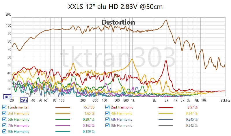

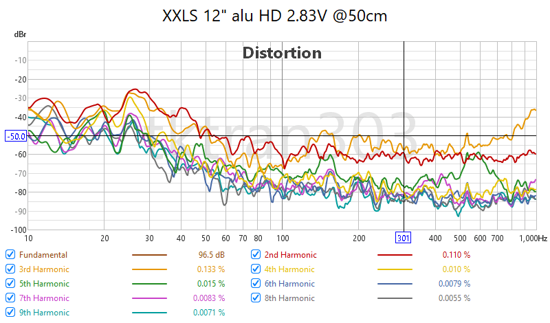

Excellent performance even by 2022 standards.
Here was one of the last variants; the Tymphany Peerless XXLS 12” aluminium cone model 835017 ;
4 ohm nominal impedance; designed for sealed boxes.
Here it is my measurement in a 1 cu ft sealed.
Distortion in absolute SPL-
Distortion in relative terms (dB)

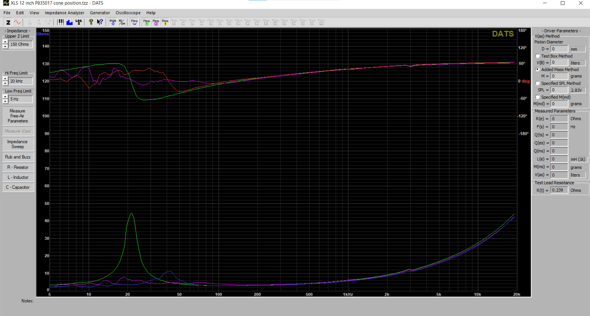

Free air impedance testing
Green- cone in free air ( neutral position)
Pink - cone pushed (and held in)
Blue- cone pulled out (and held out)

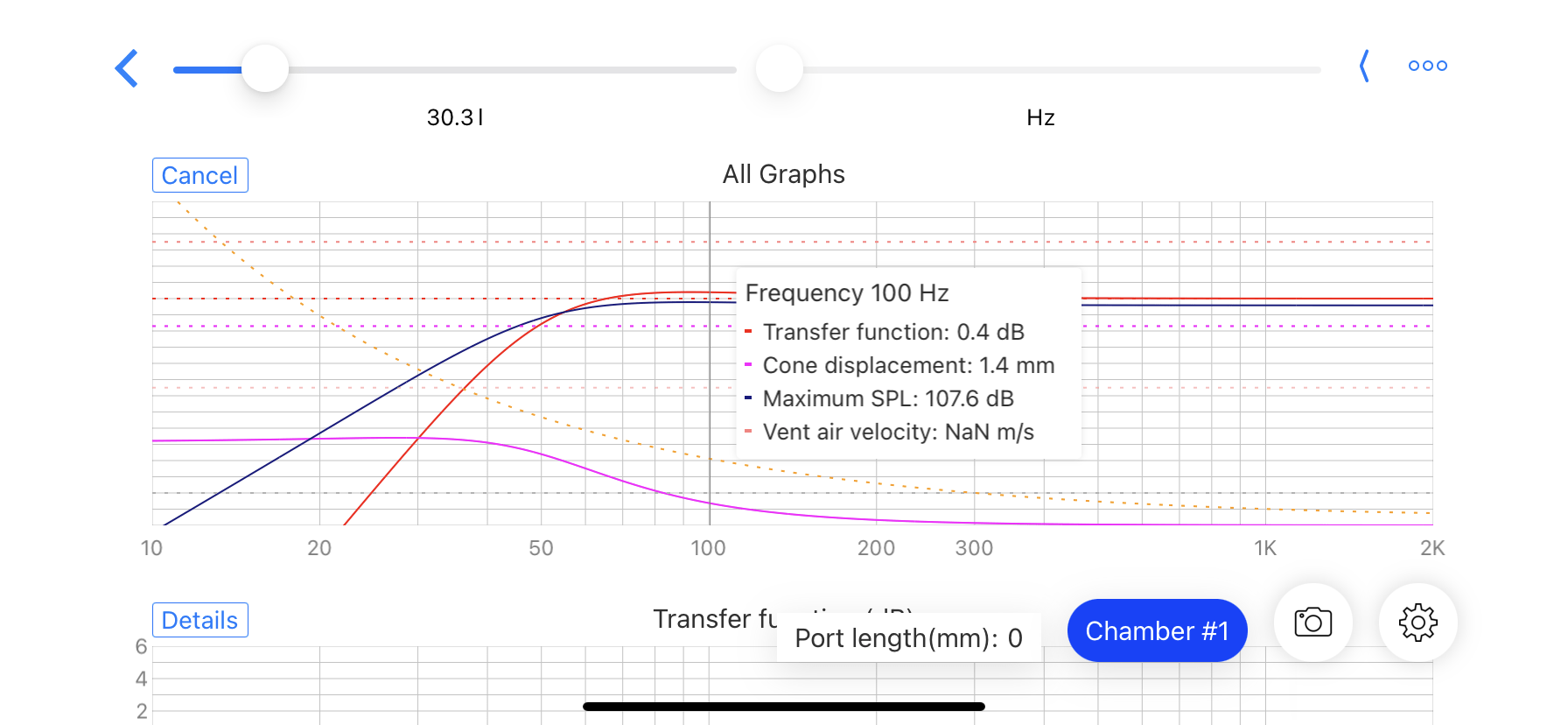

I’m using the 835017 in a 28L sealed cabinet well stuffed with glass wool; with 100W (4 ohm) amp. In half space (2 pi) it looks something like this- which gives it a bit of boost around 100Hz:
But it’s used in my son’s cabinet for his e-drum kit; with the 100W amp only able to push it to a maximum excursion of ~6mm (out of its Klippel rated 14mm x-max) at 10Hz. This gives a dry but punchy sound. He’s only been drumming for less than a year; and I’m no drummer; so I can’t really comment on how good everything is.
BUT, A higher sensitivity 12” designed for a vented box, with ~7mm x-max, in a PA style cabinet, even if it had a little more harmonic distortion (overtones)… well it would give more dynamic range, and perhaps a bit more character. Remember that H2 is precisely one octave higher that the fundamental- so it’s related musically. HD3 is a perfect 5th and HD4 is 2 octaves higher, so they are also related musically. (That’s why THD is poorly correlated with perceptual problems; as it’s 2 largest components are the musically related H2 and H3)
It’s really the H5, H6, H7 and H9 that are not musically related, and all the extraneous noises, like farting/chuffing port noises, whistling under the cone because of lack of pole vent etc that would be apparent.

That XXLS looks super.

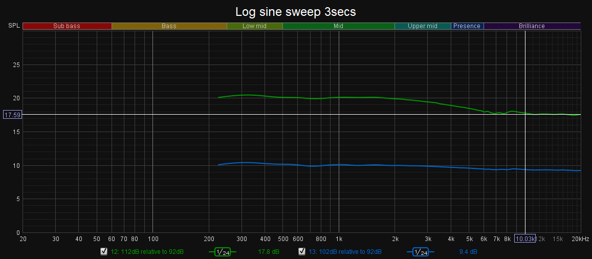

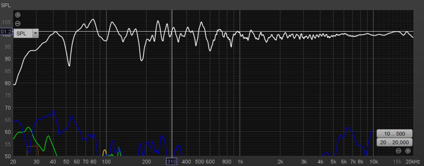

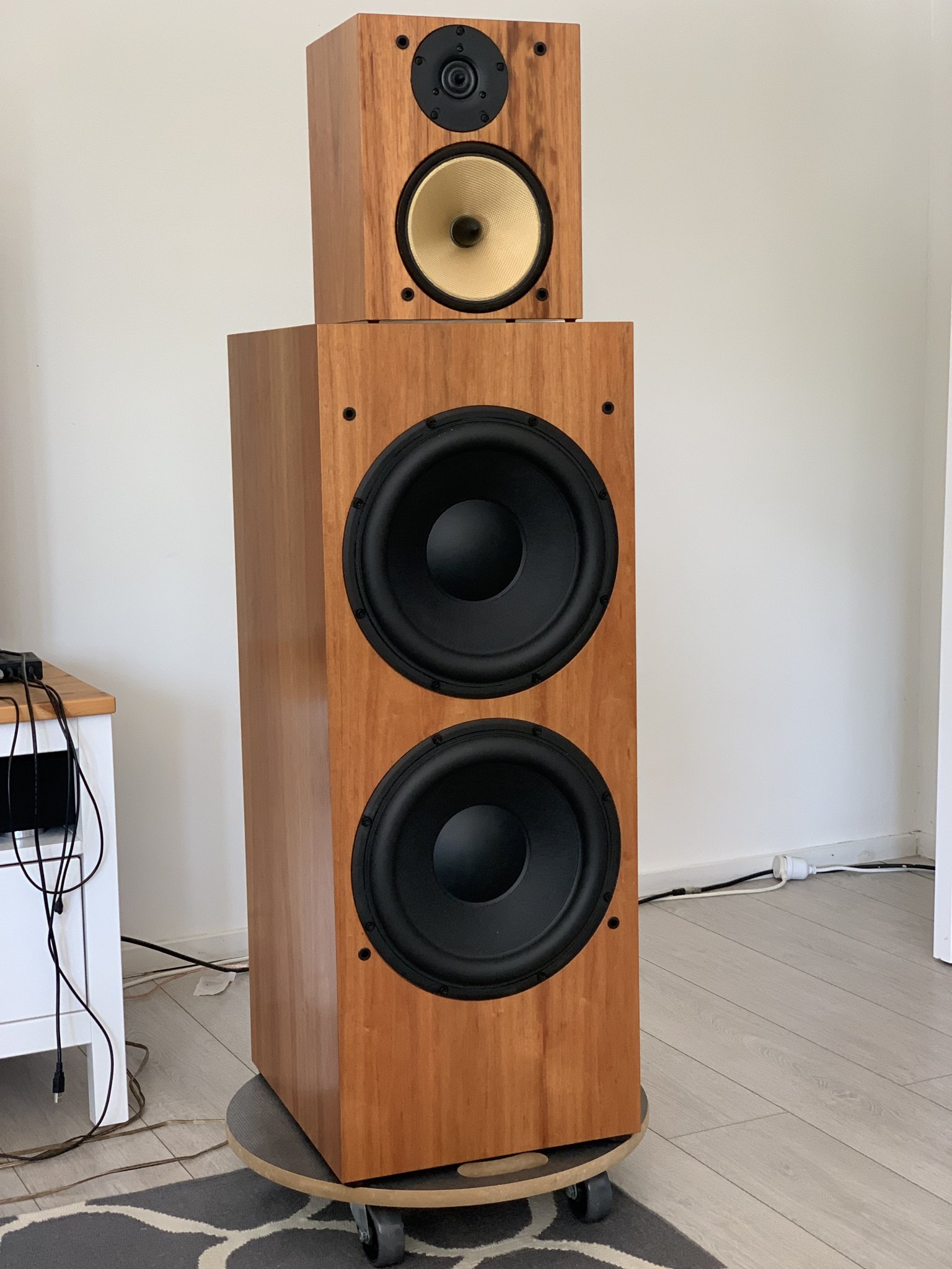

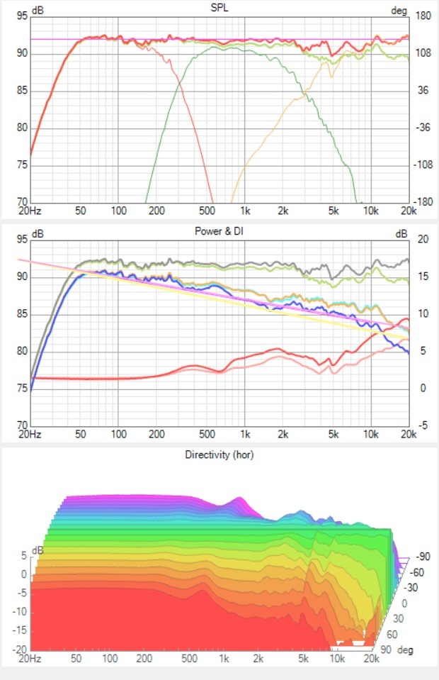

This is actually the project that lead me to choose twin P830845 in the system I designed in 2021 (and current system main system). It’s one of those old fashioned systems that doesn’t go as deep as a home theatre subwoofer, but enough as a music subwoofer (F3 40Hz or less; F10 30Hz or less) has plenty of output due to its high sensitivity (at 92dB/2.83V (4 ohm)) and ability to reach 12mm x-max with a few hundred watts (~350W/4 ohms).
So it can play at live-like levels. (Distortion tested at 86/96/106… and limits were reached at 110dB/1m where… you guessed it… the tweeter started to show signs of dynamic compression. The woofers and midrange were still ambling along)
Unfortunately the woofers (and midrange) are NLA so I haven’t been motivated to document the design, since no one can build it. I think we missed the XXLS party by a decade. It looks/measures as below:

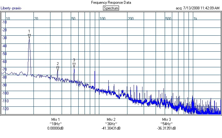

I take it you haven’t heard of our fellow audio nut Monte Kay?
http://www.mfk-projects.com/Home_Theatre/theatre_woofer.html
Here he is, with his TWENTY-FOUR
15” RSS390HF-4 subwoofers in a dipole ‘enclosure’
“Click on the thumbnail above for the distortion performance at 18 Hz with a 2.83 volt per woofer input. This measurement was made at the center of the center row with both woofer columns playing but with only two of three modules. The third modules have not yet been installed. The SPL meter was reading 103 dB for this measurement”
When my system is playing at 102dB@ 1m, the quad of 12” XXLS woofers can manage about 17% H2…
He has a point. How can one say distortion isn’t audible; when you haven’t heard really low distortion?
I’ve never heard 1% (-40dB) distortion for a 18Hz tone…
ASR have tested 263 speakers. And run distortion tests- virtually all of their tested speakers have harmonic distortion that go through the roof (5%/-26dB) below 100Hz, when they test at 96dB, from 30Hz up…

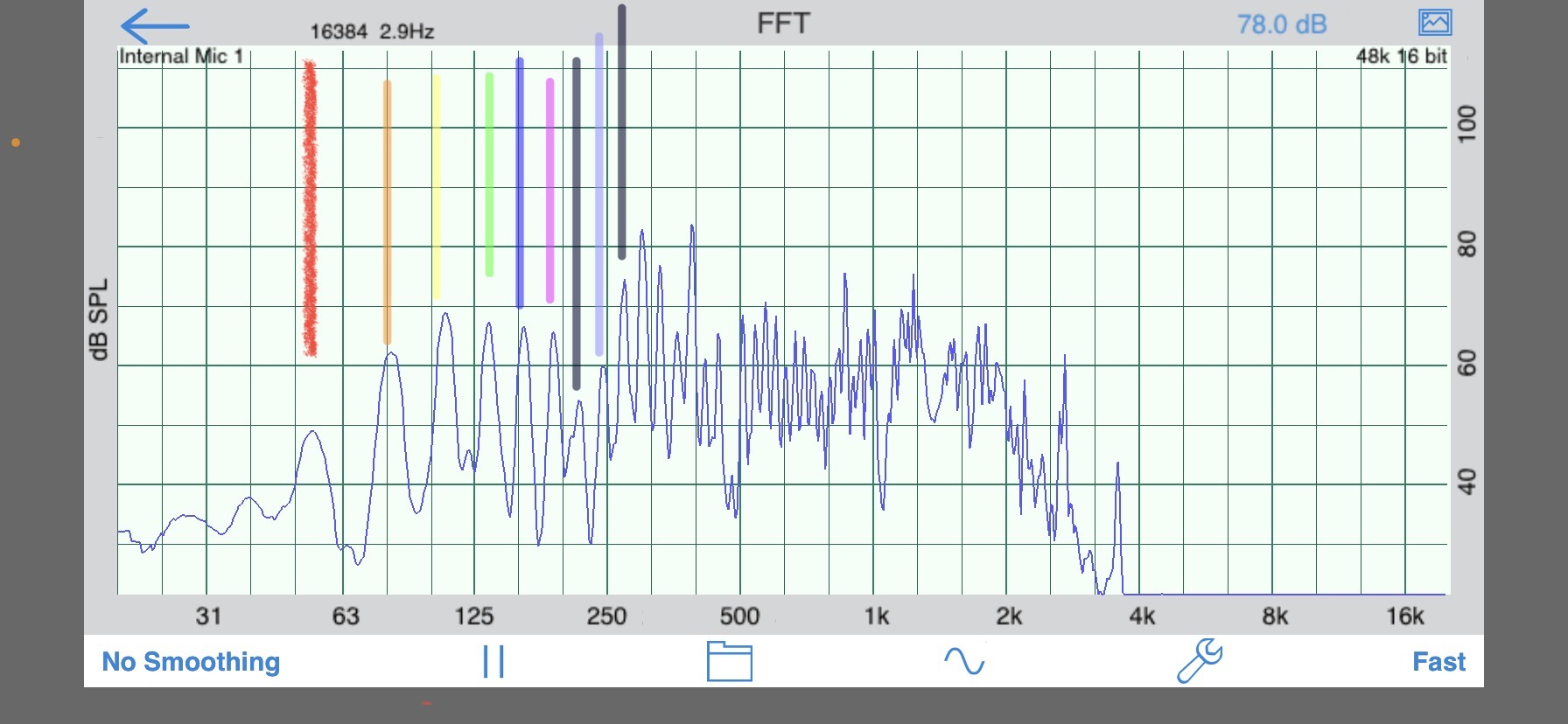

Here’s my partner’s piano, recorded using AudioControl’s RTA (FFT) during the attack phase of a strike of A0 (mic at hammer position)
H2- Red
H3 - Orange
H4 - Yellow
H5 - Green
H6 - Blue
H7 - Purple
H8 - Grey
H9 - light Blue
H10 - Black
That is the rich spectrum of overtones (aka harmonics) that give the piano its rich characteristic sound.
That’s the deepest bass note on the piano - whose fundamental is apparently 27.5Hz… which I’m not sure I can even see…
H2- Red
H3 - Orange
H4 - Yellow
H5 - Green
H6 - Blue
H7 - Purple
H8 - Grey
H9 - light Blue
H10 - Black
