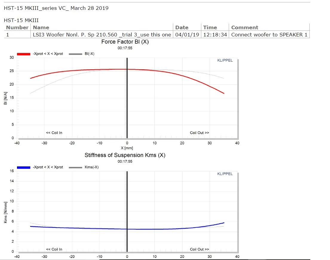

Erin Hardison interviewed Lars Risbo a couple of years ago, and in video Lars deconstructs the original Purifi 6.5” high x-max midwoofer (PTT6.5X). He goes through to explain the motor system, which he and Carsten went to great lengths to optimise. But when they measured it; to their surprise, it only made little difference.
It was not until they went back and looked at the surround. And optimised that, that the distortion really dropped.
Have a look at around 45 mins-
https://www.youtube.com/live/o90AYyceaMI?feature=share
The surround affects the variation in the emissive surface area of the driver. Purifi calls this Sd(x) - the surface area as a function of excursion.

Here a picture/ measurement of one of the more impressive high xmax subwoofers around (older 15" version) , with 39mm xmax each way.
You can see where the linearity drops off.
This driver having 20mm excursion with almost zero loss in field strength over the distance and a unusually linear suspension.
Sadly the Inductance/Le over excursion/position is not included.
Was this the Stereo Integrity HST subwoofer, with a ridiculous amount of excursion?
If so, here’s the rest of the data sheet :
https://stereointegrity.com/wp-content/uploads/2021/05/HST-15-MKIII.pdf
One thing Lars said in there (around 40 mins IIRC) was that (to paraphrase) it’s very hard to look at these things in isolation and applause (or blame) it as being the root cause of distortion.
So the excursion determines the Vd but it is just one factor in the cause of distortion. Because the excursion is affected by the BL linearity, which is affected by the motor design, magnetic strength/direction and the voice coil winding method and number of layers which affects the moving mass with affects the sensitivity.
The cone profile affects the frequency response which is affected by the surround termination which may be affected by the... And so forth.
Doing this all by trial and error takes years. With the advent of software and simulations it now takes weeks instead.
The traditional ( voice coil height - gap length ) / 2 doesn’t fully represent the available excursion, and may overestimate, and sometimes underestimate it.
