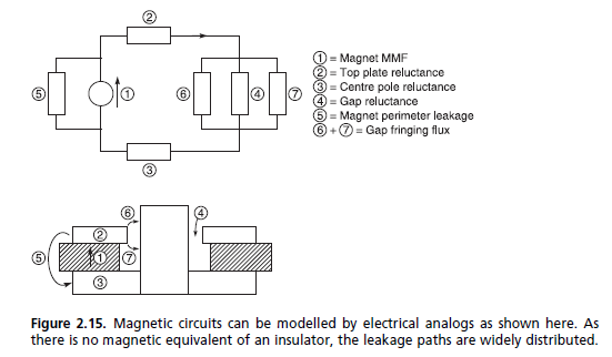

Short term power handling may increase from greater thermal mass of individual wires or the total voice coil. But, in general, the long term power handling is determined largely by the surface area of the coil(ie large diameter=good), efficiency of the thermal conduction paths to the top-plate/pole-piece, and the ventilation or airflow paths built into the motor assembly.…making a driver which can handle 500 electrical watts means using really gross wire gauges in the VC
Unlike magnetic tractive force, for the same magnet and gap area the flux density in the air gap varies linearly with the gap size. The magnetic circuit is analogous to a simple series electrical circuit containing a voltage source(magnet), wires(iron path), and resistor(reluctance of air gap). The magnitude of the current(flux) is determined almost entirely by the reluctance of the air gap which increases linearly with size. I agree it is desirable to keep the gap as tight as possible for increased B, but it doesn’t vanish in an exponential fashion as you increase the gap.… For a given magnet, that enlarges the gap a whole lot and makes BL shrink exponentially faster yet
Mid-band and LF efficiency are both proportional to (BL^2/Re), so you can’t look at just BL.… buying plain brute BL is the wise move …
Re = ρ * L /Aw where:
ρ = resistivity of metal used in wire
L = total wire length
Aw = area of individual wire
If the VC is similar in height to the top plate, a little algebraic manipulation can remove Re and L from the equation, showing efficiency is proportional to (B^2*Vw/ ρ); where Vw is the volume taken up by the VC winding. So for a given Vw, it wouldn’t matter what wire size you use to wind the coil, the efficiency will be the same. What will change is the sensitivity, or how much voltage you need to get a given SPL. Midband and LF sensitivity is proportional to (BL/Re). With efficiency set by B and Vw, wire size and number of layers can be selected to achieve a desirable (BL/Re) ratio such that target SPL can be attained using amplifiers available in the current marketplace. Huh, one thing I hadn't noticed before is that for a given gap size, increasing the diameter of the VC would increase Vw and thus efficiency.
In reality, things are "a bit" more complicated than this simplified view used to illustrate some of the first order relationships between efficiency, sensitivity, and motor parameters. In particular, as the length of the VC is extended beyond the gap to improve BL linearity with stroke, wire size will need to be increased to retain reasonable sensitivity. I'd wager this is the primary reason you see larger gauge wire in long-stroke subwoofers; not pursuit of power handling numbers...although that doesn't seem to stop the marketing department from bragging about it. Another thing to consider is that VC inductance, which increases as the square of the turns & diameter, reduces sensitivity when more turns of finer wire are used. Compromises will need to be made between motor parameters like VC length & diameter, wire gauge, number of layers, amount of shorting material taking up gap space, and performance parameters like Xmax, distortion, power handling, and of course efficiency and sensitivity(including inductance effects).
