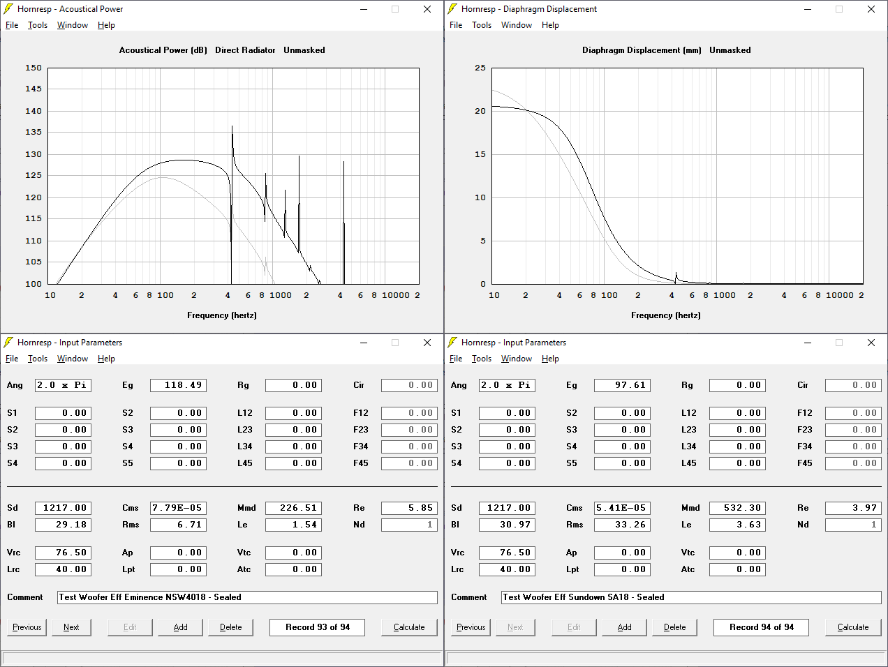

If excursion and SD are the same, shouldn't the amount of dB produced be as well?
Unfortunately the excursion plot doesn't correspond with the dB plot. The excursion plot appears to be from the comparison shown in Post#13. The other issue of course is that in a vented enclosure the total acoustic output doesn't correspond to excursion around the tuning frequency.

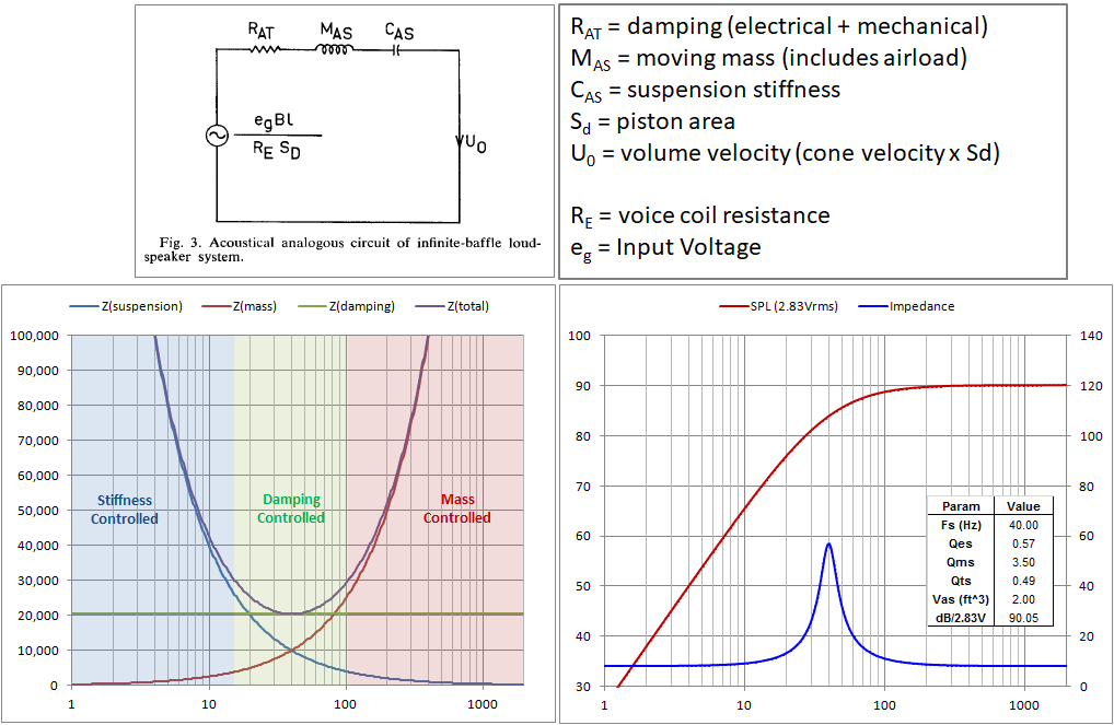

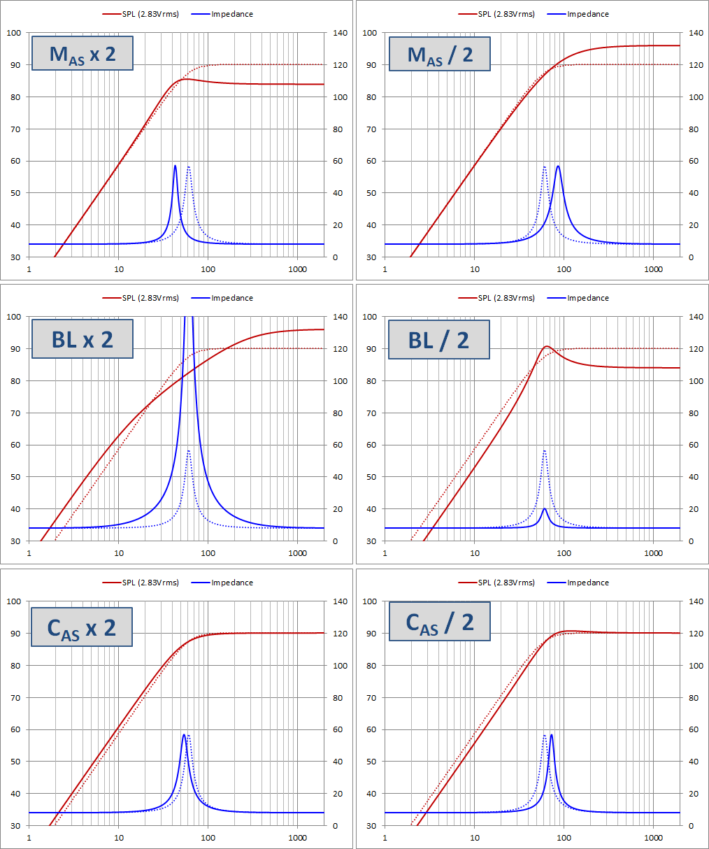

After receiving a few PM questions, I thought it might be helpful to post some of the trend plots I had generated a while back to illustrate how changing the 3 major electro-mechanical parameters of a woofer(mass, suspension compliance, and BL) affect TS parameters, mid-band sensitivity, and response for the same applied amplifier voltage. I grouped a few of the plots in what is hopefully a logical presentation.
Attachment #1: The analogical model of a loudspeaker in an infinite baffle can be simplified down to a series resonant circuit driven by a voltage representing Pressure (ie Force per unit piston area). The current thru the circuit represents volume velocity(ie piston velocity x piston area). The resulting acoustic output is proportional to volume velocity, and can be calculated based on formulas and methods documented in many acoustic texts and AES articles. You can see that the impedance of the series circuit can be divided into 3 regions. For frequencies above resonance, the total impedance(and thus the piston velocity and acoustic output) is almost completely defined by the inductor MAS representing the total moving mass. Below resonance the impedance is almost completely defined by the capacitor CAS representing suspension compliance. For a couple octaves around resonance the resistor RAT representing the total damping in the system is dominate in defining the total impedance. This is where the terms stiffness, damping, or mass controlled comes from. When you change the value of one these 3 major parameters, you will see a change in the corresponding control range. The SPL and impedance for an 8ohm 10” woofer in an infinite baffle were used as a reference.

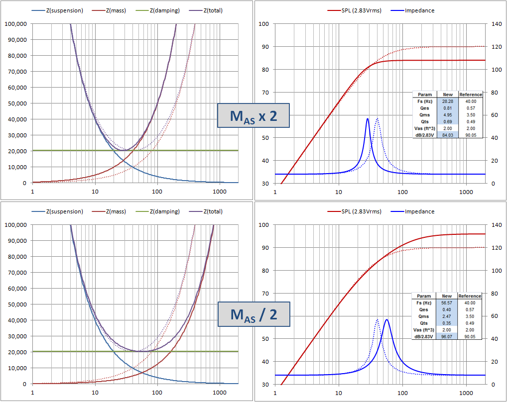

Attachment #2: With drive voltage unchanged, this is the effect of doubling or halving the moving mass. Note that mid-band sensitivity is changed +/- 6dB as expected, but in the subwoofer range there is very little difference. This is likely a major factor at play in the confusion between car/pro woofer sensitivity ratings and acoustic output at subwoofer frequencies when driven by the same amplifier.

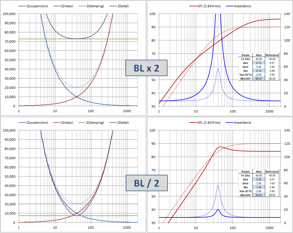

Attachment #3: With drive voltage unchanged, this is the effect of doubling or halving BL or magnet strength. Doubling BL increases mid-band and very low band sensitivity by +6dB, but the electrical part of the damping(RAT) is increased by 4x and overdamps the response around resonance. Happily, as CharlieLaub mentioned, the impedance peak around resonance is increased in magnitude and broadened. So, if you have an amplifier capable of swinging high voltages, you can EQ that range and reclaim the “lost” dBs without burning up the voice coil.

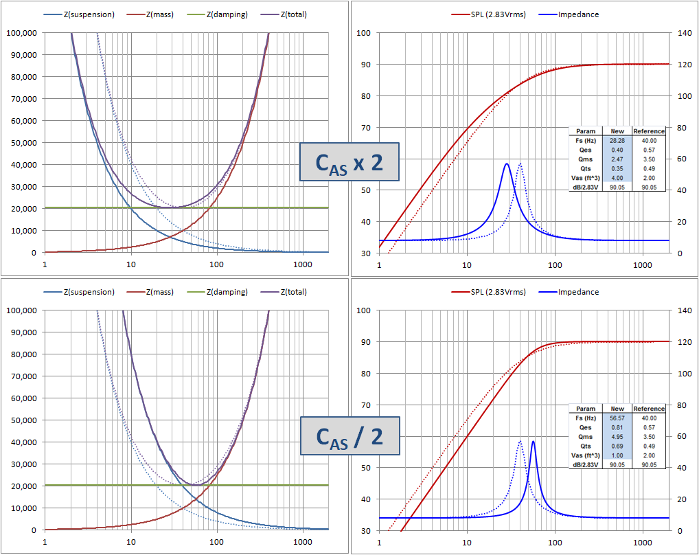

Attachment #4: With drive voltage unchanged, this is the effect of doubling or halving the suspension compliance. Note that response changes are limited to the frequency range below resonance, and is changed +/- 6dB.
Attachment #5: Put the woofer in a 1.5 ft^3 enclosure and the trends are essentially the same for mass and BL, but the effect of compliance changes is less pronounced. This makes sense when you realize that the compliance of the enclosure is modeled by adding an additional capacitor in series with the capacitor representing the suspension compliance. As just a guy mentioned, the enclosure size can have a dominate influence on bass output, especially when it is sized to have compliance < Vas.
The matter of voice coil inductance was excluded from the calculations for clarity. In reality all woofers have some amount of inductance. The higher the inductance the more the response will droop below the ideal non-inductive SPL curves shown in the trend plots.
