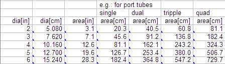

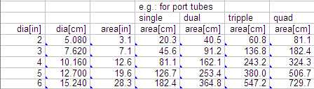

In general, the port should be radiused at both ends, with a small flange being added to the port on the inside. If the port diameter appears to be too small use a larger port tube or use multiple port tubes, it's the cumulative cross-sectional area that matters, e.g.: use two 3" ducts instead of one 4". Find the length using a program like Hornresp or WinISD.

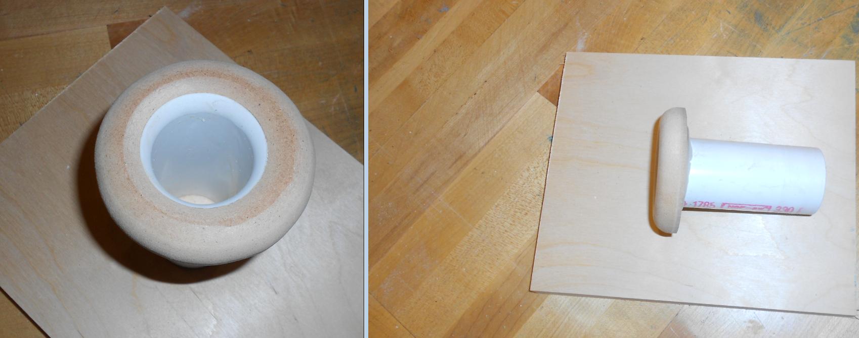

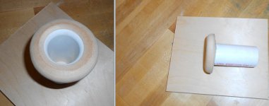

Never would have thought of adding a wood ring to inside port (end) so a flare could be added. Very good...will try that next time.
I'm into flares these days - here's a link to box with a side removed. Tuning was done on bench with the basic size in mind, fine tuning with clamps and experimenting.

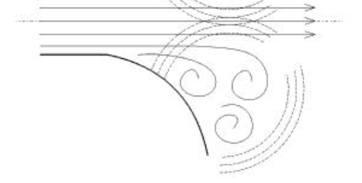

Flare flow separation
Be careful of how you interpret the word flare.
A simple radius is great, at lower SPL's.
At higher SPL's flow separation can occur.
A better "flare" has a simple angle rather than an exponential radius that the flow can not stay attached to.
Big 45 degree angles make good "flares" as do 22 degrees on a side symmetrical "flares".
Look at the screen snip at the bottom.
If the angle approximated by the first 1/3 of the flare shown was continued to the same OD as the spherical flare, then the flow separation and consequential turbulence would never form.
I have read that at high SPL's and excursions, the traditional flare will decrease the effective flow area causing compression.

Is it the turbulence that creates the noise when flow rates are high?
Or is it the laminar flow of an attached flow around the curve that creates the noise when flow rates are high?
Hi AndrewT,
Look for the paper: "Vented-box geometry and low frequency reproduction: the aerodynamical approach" by Morkerken, Parzy, Pellerin and Polack. AES 112th Convention, Munich, Germany 2002 May 10-13.
Or in short, a smooth laminar flow is desirable, and the vortices (turbulence) create the "blowing noise".

Glad Oliver tipped us off about using wood rings and a router to finished the inside of a PVC port. Can remember many times sanding/polishing the end of a pvc pipe thinking this can't be doing much.
[a hole would need to cut in box anyway, so router/hole cutter would be set and ready to use]
