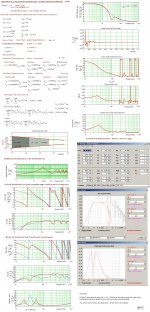

Thanks very much bjorno it does look perfect I think. Please forgive me but I'm new to building speakers and this is my first build. Looking at the plans is it a sealed box or ported? If ported what size is the port. I think I have the box volume but I'm alittle mixed up on it. This is perfect if I can understand it I just might be able to build it. Sorry for being such a dummy but could you explain it alittle more.
Thanks for your patients
Bill C
Hi Bill C,
Bjorno's simulation from Post #3 for the GW-12PC/4 is a ported (bass reflex) enclosure, w/ an internal volume of V_net=79.8L(2.818ft^3) (add extra volume for braces/speaker displacement), and a 4"Dia.x8.66"long port (duct).

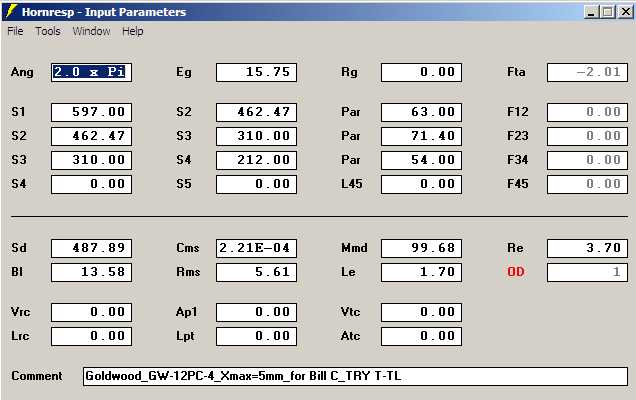

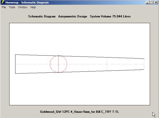

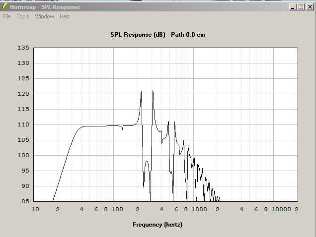

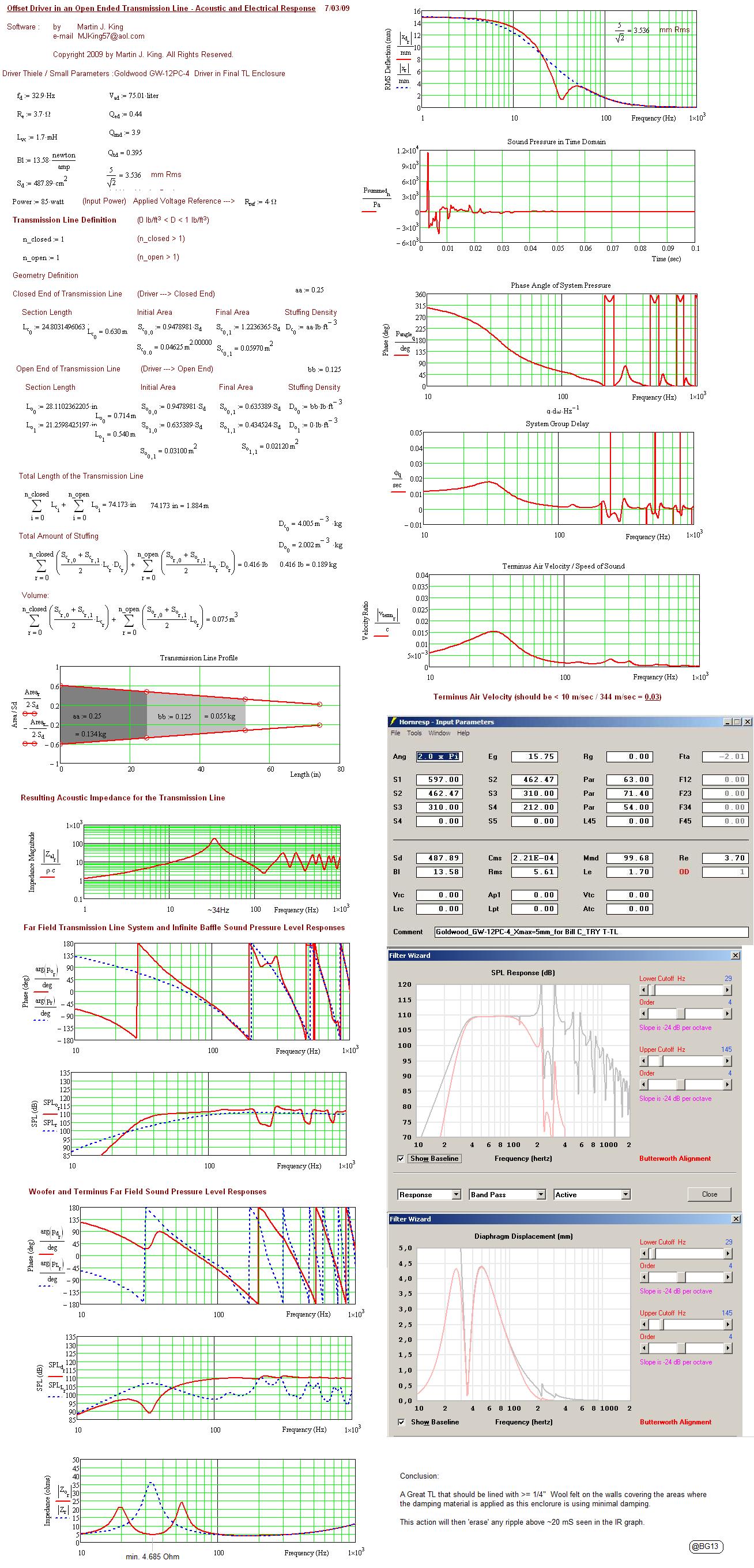

Hallo bjorno,
How about a simple tapered OD-TL for this driver, could you do your stuffing magic on that one?

That looks great!

Hi Oliver,
You're right,This Driver is good in a stuffed TL too:
b🙂

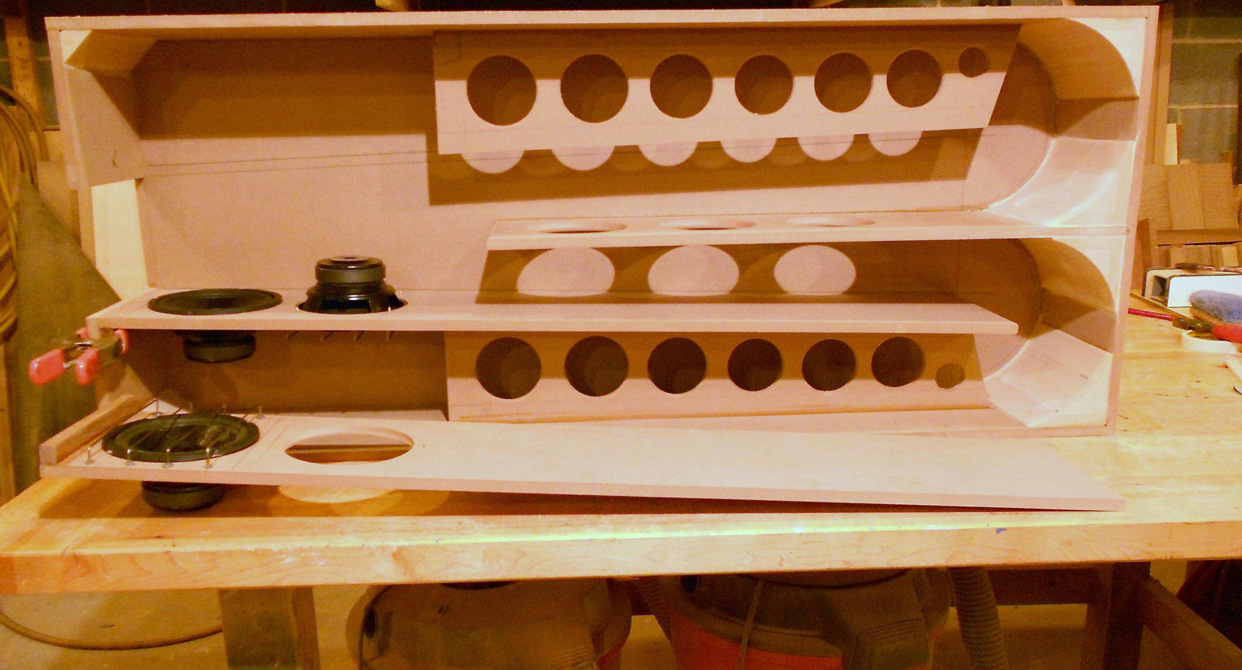

For inspiration, posting a pic from last year's "forum build" a T-TQWT
(Tapped Tapered Quarter Wave) This a double, single fold(s).

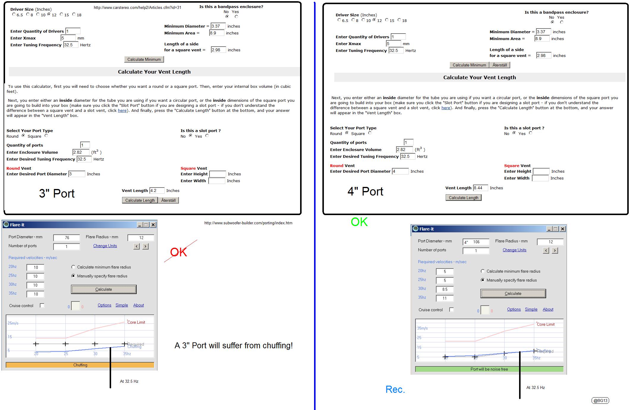

Ok this TL build sounds really great but I 'm totaly lost so I have settled on what bjorno sent a ported box of 79.8L plus brace and driver with a port of 4"X8.66" however can I change the size of the port to a 3" one? I have a parabolic port I purchased it is 3"X 11" again with little knowledge as this thing is gigantic or can I use a 3" flaired port and with what length? I have settled on the ported box I just need to know how to calculate the port size. Also do you suff the whole box with material or just the walls? Thanks guys you have really been a help just don't mention a transmition line thing again >LOL<

Hi All,
Oliver, Your OD-TL outline is great and deserves to be re-used by scaling to incorporate other drivers. I have already one very similar in use: an Audes 8” driver that sounds very good(Music). Thank you for the .pdf.. I will try to design a MathCad program that aromatically will calculate an enclosure by using the given T/S parameters that can be imported to MathCad: s 'Sections TL program' for quick plotting of reliable graphs.
ODougbo: I'm intrigued by the picture of the 'Double' T-TQWT you've submitted. Do you have a picture of the sub, finished? What's your impression of the sound, i.e. the HT performance versus Music.. after almost a Year of experience?
Bill C: Have a look at the picture: A 3” Port will chuff compared to a 4”:er . Here are two links to easy to understand port-calc programs you can use when evaluating different port types:
http://www.carstereo.com/help2/Articles.cfm?id=31
Porting at Subwoofer-Builder.com
b🙂
