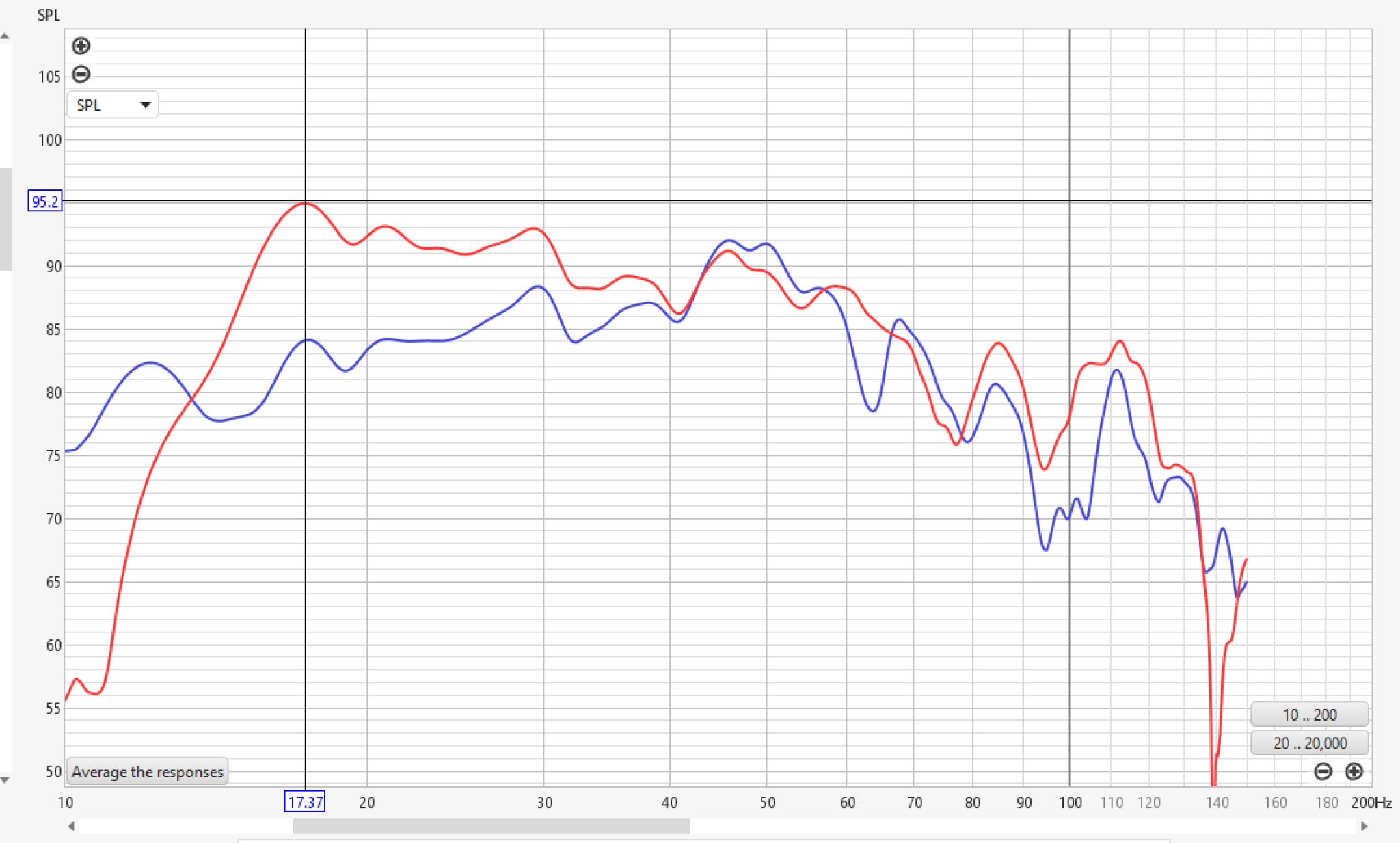

So I just done some experimenting.
I Set the mic up in the MLP and done a sweep of the sealed UM18-22 in the 4cf box.
Then i put the driver back in the full marty cabinet and layed it on its side to sit in the same spot roughly.
Graph attached. No eq or anything.
Blue is sealed, Red is ported

PS with 430 liter volume, you get a Qts of 0.7 which is about the best you can do with the UM18-22, while the 113 liter cabinet results in 1.0
That is only 0.3 on paper, but you see the difference in volume. You can DSP the 0.7 down to 20 Hz. The second full Marty will give 6dB more,

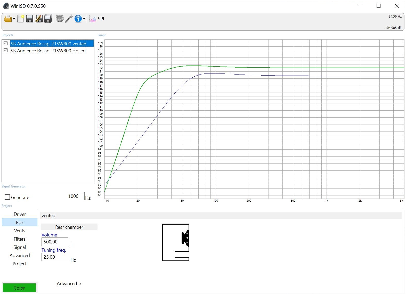

sb rosso sw21/800 160L is just way to little volume I think ..
Vented in 600 liter, tuned to 25 Hz and at 500W will give you 119 dB :up:
At 160 L closed you have Qtc = 0.9, and at 500 W you have some 105 dB at 25 Hz (but still a lot of bass 😉 )

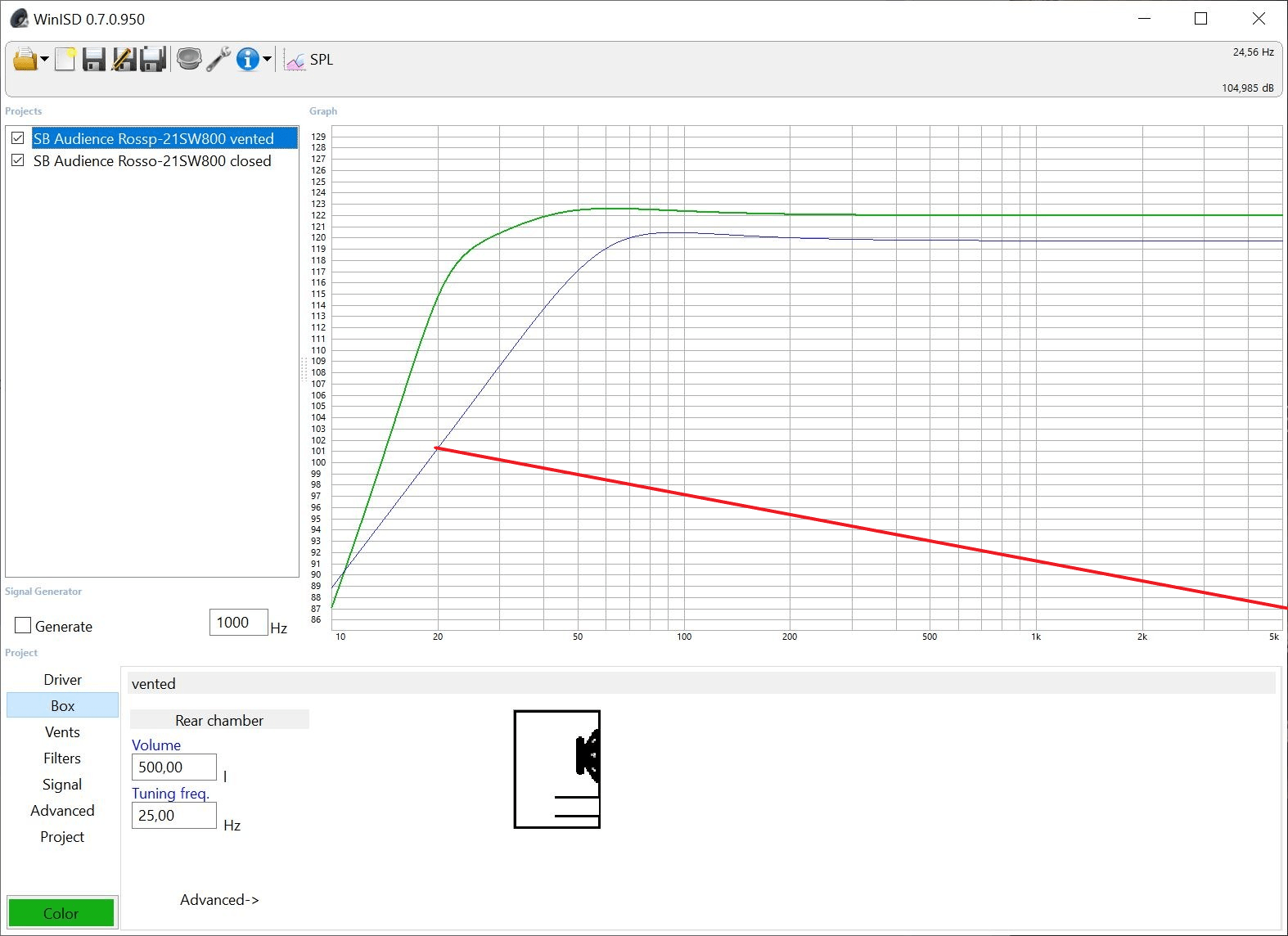

I couldn't agree more Baldin but i got confused by a post saying "you can eq the qtc down to 0.8", my eq looks like the red line. 4 subs playing at low volume to get real low end extension to 20hz and below. Is this changing the QTC of the box??? If so can I measure the phenomenon 🙂
Your red line is around a -12dB roll off per decade (nor would it stop at 20Hz without a HP filter), it doesn't specifically change the value of Qtc, the closed box Q of the speaker/box system at Fc, the closed box resonance frequency.
Fc is always higher than Fs, the free air resonance.
You can measure the near field frequency response of your sub, and equalize it to match the total system Q you would like, within the linear response of the driver.
