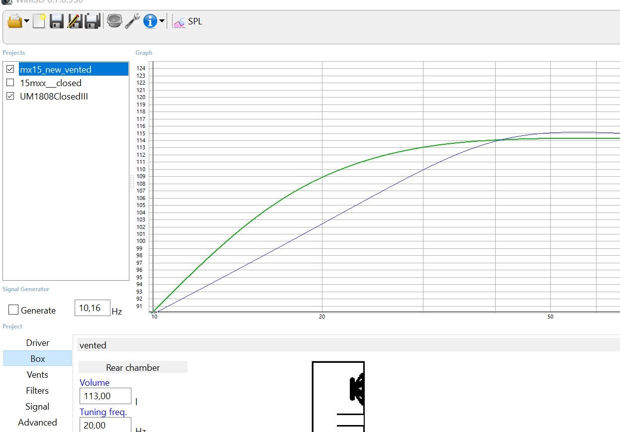

I have to correct my last post.
The UM18-22 was simulated in a closed box, as it doesn't work for vented because of much too high Qts.
The simulation of another 18" was in a vented cabinet.
Anyway, if you have the same cabinet with two different chassis, it is usually not the principle (an additional port) that matters, but the end result. In home theater, you will not see advantages from a closed or vented system soundwise.
If you take the MX15 from Dayton, it is 200$ unstead of 300$ for the 18". If you take the same 4 cubic feet volume, the 15" vented will deliver a serious amount of 20 Hz level, compared to the 18". Like 4 times as much if winISD is right. 6dB are nothing to be ignored.

If you can read the picture: These are the two chassis in the same volume, driven by 500 Watt each. MX15 ported, UM18 closed.
The difference is quite huge.

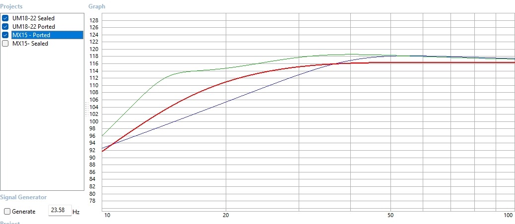

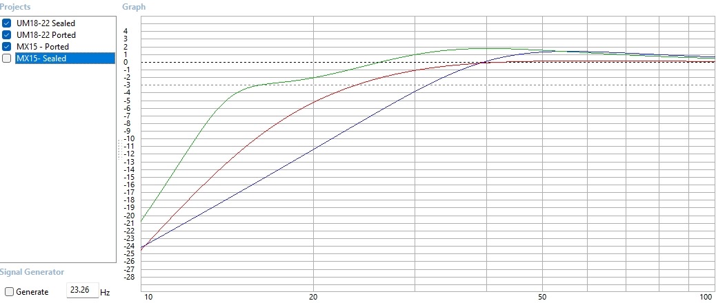

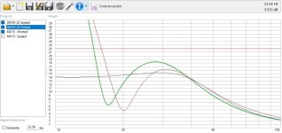

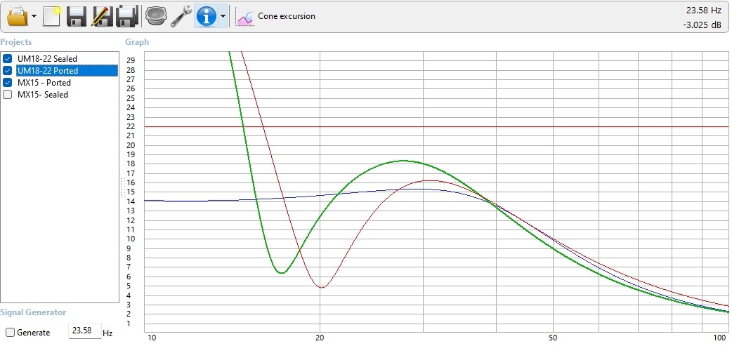

So I did a little bit of testing, downloaded the winisd data and used that for the graphs.
Ive attached the graph of the UM18-22 (new specs) & the MX15, Transfer function, SPL, Cone excursion
UM18-22 Ported, 11 cubic feet, 17hz tune (to match full marty, green line) 1000W, F3 17hz
UM18-22 Sealed, 4 cubic feet (blue line) 1000W, F3 31hz
MX15-ported 4cf (red line) 800W, F3 24hz
The UM18-22 Ported uses a slot port, not sure if that stuffs up those graphs.
Based on those graphs, wouldn't you run with the UM18-22 Ported?
Or are we trying to say the UM18-22 with a Qts of 0.7, might look fine on paper, but isn't fit to task?

See, the problem with drivers that have a Qts higher than0.6 is that you can simulate them as vented constructions, but they will not work in practice as simulated. This is no joke or maybe thing, but you will end up with something sounding blurred and anoying. This is not oppinion, but the physics that makes speaker work.
The drive of the UM18-22 simply doesn't work for the stiff suspension ond heavy cone. What they changed in construction was an unsufficient try to compensate for some cost saving measures. Like making the cone lighter. It made a good chassis simply unuseable.
If you are objective, there is no construction you would pick the UM18-22 as a good candidat for. Not vented, closed, horn, open baffle or transmission line. They fu##ed up.
We can discuss until the holy uncorn resurrects, this is what it is. For a closed cabinet you want the resulting Qb (this is like Qts but in a box) to be 0.707, which is the point where impulse reaction, damping and response have a good value, free standing in a room. As Qb is allways higher than Qts, if you start with the UM12-22 you end up with something like 0.8 or 0.9 which is to high for a quality speaker.

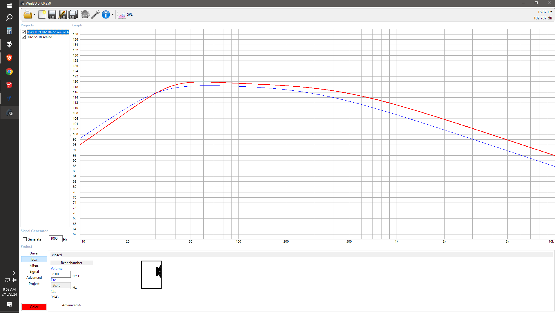

In 4 cf sealed you get a Qtc of 1.07
This is usualy called a "one not bass" for a reason.
The NX6000 is a double NX3000 bridged internaly if I'm right. These amps have not that much power as you would expect. The NX6000 can only drive 4 Ohm or greater loads. I have a i-Nuke 3000D at home, which is the same amp in another case. You can easily drive that thing into hard, audible clipping on a 8 Ohm, 300 W rms rated EV 15" speaker, with CD based music.
Get me right, it is a fine amplifier, as I paid less than 195€ new for it. The DSP has very nice functions for PA and HT use, but it is no endless power amp. You got to stay with 4 Ohm per channel or the amp will release it's magic smoke. No 2 Qhm experiments. This is no heavy weight Crest Audio or QSC pro. 1200-1500 W /4 Ohm seems to be about right, with some headroom left. Behringer, after posting realistic numbers for some years, has returned to phantasy Watt, calling it "Peak". They even re-wrote their older manuals and erased rms values.
Anyway, much more power than you can use in a closed room and enough to do some serious response bending! Keep the thing cold and from time to time clean it from dust inside and it will last.
With the list of drivers, what size cabinet do you have on your mind? Just as a direction, the larger the volume, the deeper or louder the bass. Do you already have a cabinet?
What kind of music? What room size. You can not have an "do anything" sub, you have to narrow in a bit on the major use and see that it is suited for the secondary task's as well, maybe not 100%.
It doesn't help if you say "I want HT in the basement, but good music reproduction in a living room and do occasional open air PA for 250 of my best friends." You don't build such a thing or two of them every day. The time and effort you spent to plan it will decide how satisfied you are in the end. So excuse me asking all that intimate stuff.
With two cabinets and 15"-21" chassis it should be possible to get a HT capable music sub, but room size (volume) matters.
Why is the MX15-22 so expensive? It is 199 US$ on PE. A good candidate for such a very small 113 liter (4cf) cabinet.
Maybe start communication with the seller of the UM first. It makes negotiations simpler when you want something in exchange for the UM18, not your money back.

A full Marty is a 420 litre or 15cf enclosure. That is a very different beast for a sub, compared to the 113 litre/ 4cf shoe box. Do you really want two full Marty in the room? Serious? From an acoustic standpoint, nice. The shoe boy is simpler to hide, but carefully said, a compromise. I have to read from the beginning again, I don't remeber your other speakers
Your room looks quite nice from paper and what I have experienced over the years. A ceiling not being flat but rising in an angle is a good thing for bass. Anything irregularity helps.
What I don't know is how solid floor, walls and roof are. This all comes into play when you leave the normal HIFI region. Even quite large floorstander don't deliver any real sub 35 Hz fequency in most cases.
Now let me say something very obvious: If you have a sub that doesn't deliver low frequency on it's own, you can DSP a bit out of it, even a lot depending on construction and amp. Too much and sound will suffer. Anyway, if you have a sub that goes too deep or has too much SPL, you can always DSP it down without any negative effect on sound. An example: In my listening room I have a drum set, which is played by my daughter. For listening to music at "nice" levels, I have to silence any felt and metal, or it will add a very special sound. In my living and TV room, I had to silenced glas windows in cupboards, screw down ceiling panels and rearrange quite some items. What I want to say, your room may develop all kinds of noises when you go through the frequency range on solid SPL.
Now I have two volumes and a hand full of drivers. Must have a look. I hope your prices are Aussi $ which would make Dayton prices similar to ours.
