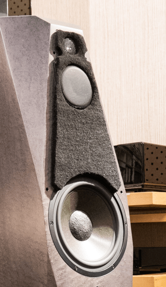

i am pretty confident that some felts placed strategically around the drivers could solve this issueIt may be true, but AFAIK the baffle edges diffraction at (mid)-high frequencies seems to me not even a joke. 😉
For mid high i am looking to coaxials where the tweeter emission is already limited by the mid cone

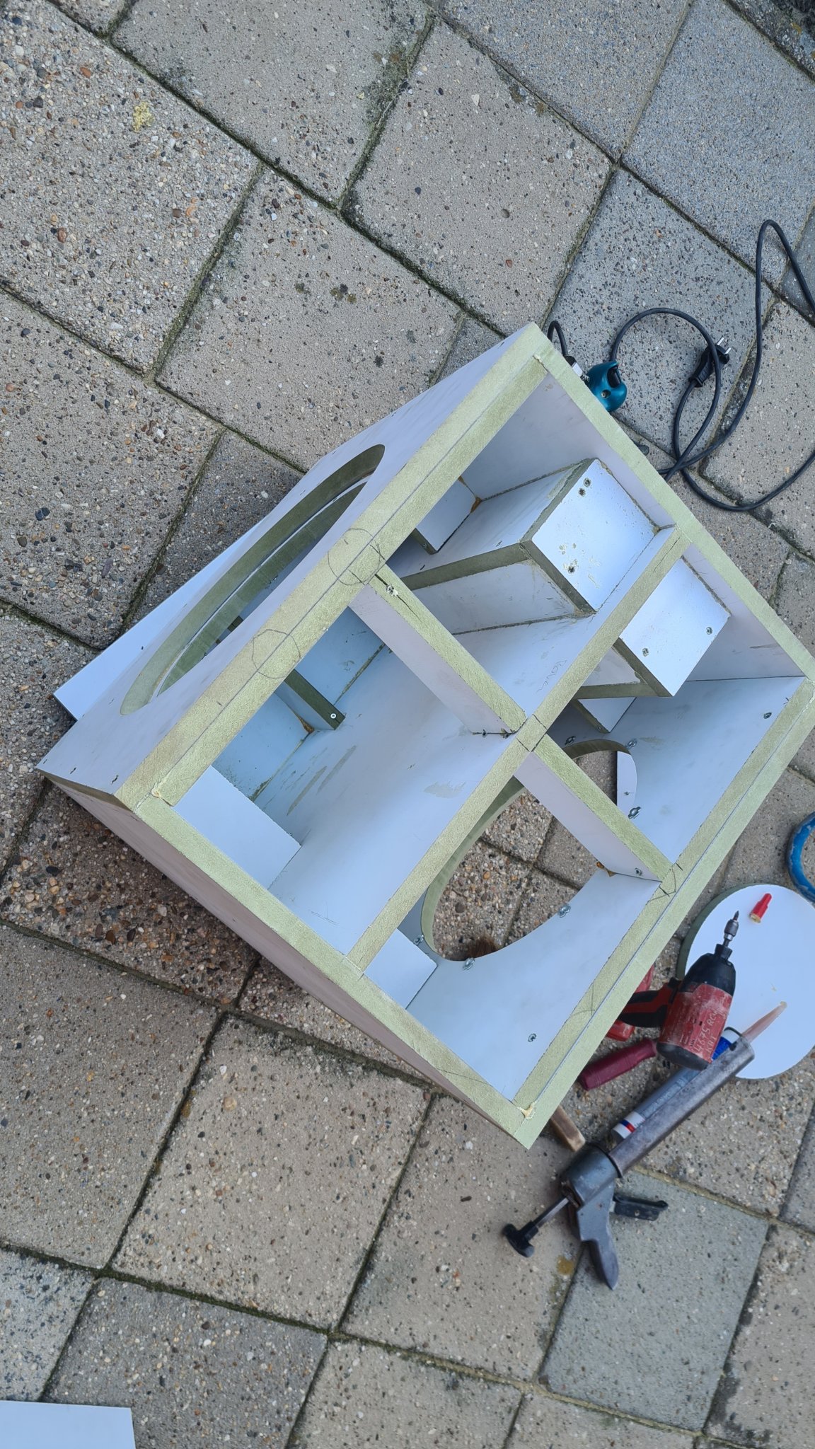

To add bracing sould mean to cut the rear panel to access the speaker internals Doable in a workshop
I like so much when the front or the rear panel can be removed entirely so that the access to components is very easy
This is how i would make a cabinet
Like this in the end

He also used to surround both the mid and the tweeter of his systems with felt about 1 cm thick, but I believe that using that way or rounding the edges of the baffle or creating an ad hoc casing shaped as drops for the mid and tweeter as others have done is only a choice of project (and in some cases perhaps marketing also has a hand in it) but then everything else must also be up to standard and homogeneous, and then the costs rise (even a lot), then you have to make measurements and modify what exists accordingly, etc.
The sound needs to travel approxiamtely a quarter-wave thru theft to be effective.nWorks at tweeter frequencies,will have little to no effect in a subwoofer.

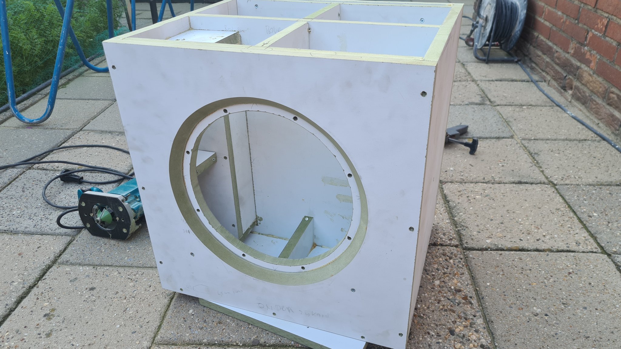

the back is not double layered, which needs it a lot more than ie. the top.
Not needed.Baffle, the n top, then sides in terms of importance IMO, and with all th einternal structure all the panels are part of any single panel.
And th ebox is nmade of Richlite, you’d need at least twice the thickness of MDF to reach its stiffness. and then all the downsides of all that extra squishy mass.

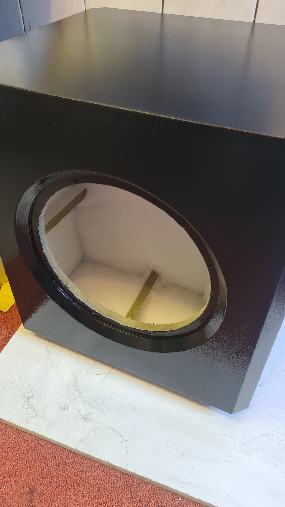

I want to be honest I am scared by the woodworking not having the skills and the tools needed to do a good job
Adding mass could be easy Design build and mount bracings is much more challenging to me
But i have understood now that bracing for woofers boxes is the way to go
I guess that to add bracing to an existing speaker it would be a bad idea The cabinet should be designed and built from the scratch I will ask some help from a guy who does woodworks
