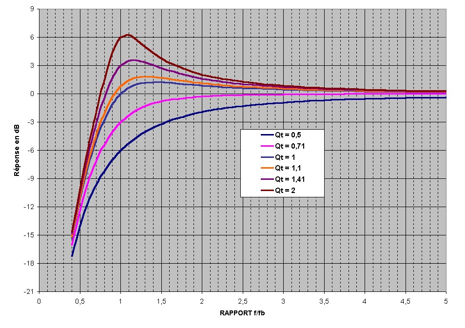

In this case is not because of that, but because you are using a sealed enclosure smaller than ideal with a high Qtc. The same for ported.

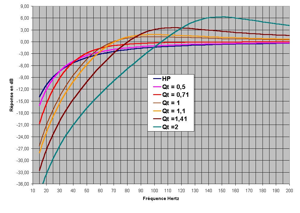

What is obvious is that almost all the times the sealed systems don't need correction when using the correct driver in a convenient enclosure. The room gain does it's job. EQ it's a gimmick for the s-t-u-p-i-d HT subs. 😀
(uploaded demo pics from sealed enclosures by Petoin Dominique)
My experimentation with WinISD contradicts what you're saying. In every case, the sealed designs start dropping off earlier than the ported designs. Perhaps you can point me to an example of a subwoofer that does the opposite. Also, it's obvious that not everyone worships at the alter of 0.707 Qtc as you do as eveidenced by the 1.00 Q of the Dayton Audio RS1202K.Is not obvious.
