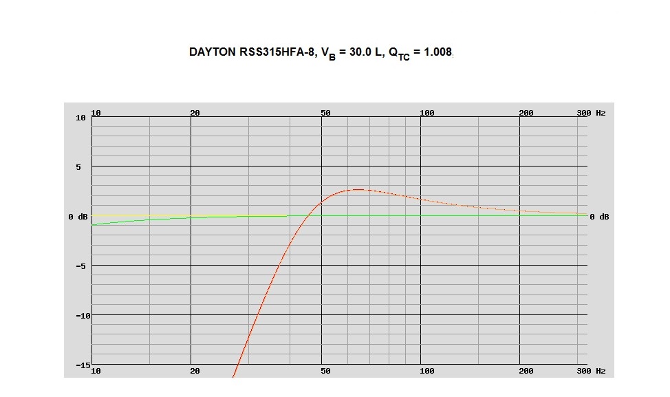

DAYTON RSS315HFA-8, VB = 120.9 L, QTC = 0.686, Fc = 31.4 Hz
What is 3rd option of post #18, your best compromise to a perfect Qtc.

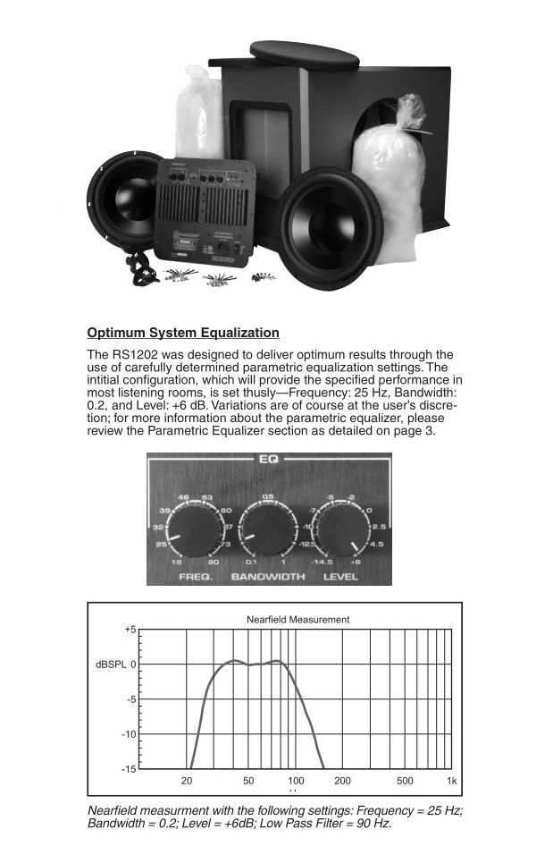

For whatever it's worth, the Dayton Audio RS1202K subwoofer has a Qtc of 1.00, based on the WinISD calculations.DAYTON RSS315HFA-8, VB = 120.9 L, QTC = 0.686, Fc = 31.4 Hz
Speaker Box Calculations
Yes, look below.For whatever it's worth, the Dayton Audio RS1202K subwoofer has a Qtc of 1.00, based on the WinISD calculations.
(2.1ft³ = 59.465L for 2x drivers)
Your mistake if using a two driver system instead of one driver for the same internal volume is that you need a driver for smaller enclosure volume. This, if not using equalization like in the case you are comparing to (sub Dayton Audio RS1202K). Does it make any sense to you?! Summarizing, without EQ you need eventually a bigger box (it's this case) or another driver for a smaller box, there are drivers for 30/40 L enclosures with a better Qtc closer to 0.707.
http://www.daytonaudio.com/media/resources/300-766-dayton-audio-rs1202-user-manual.pdf
