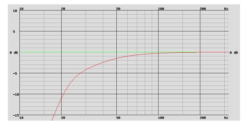

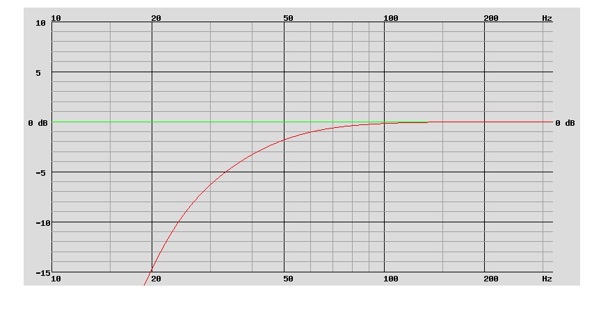

As you requested I compare 3 of the drivers for a starter.
Explain for the forum what type of setup you have or planning, amps and the like, main speakers...
1. and 3. are aluminum cone, 2 is a paper cone.
Number 2 has a better sensitivity. All in all they are very similar.
TANGBAND WQ-1858, VB = 120.0 L, QTC = 0.648

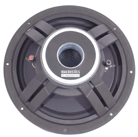

SB ACOUSTICS SB34NRX75-6, VB = 120.0 L, QTC = 0.738
DAYTON RSS315HFA-8, VB = 120.0 L, QTC = 0.687

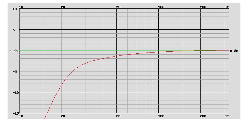

Another very nice driver CSS TRIO12
Creative Sound Solutions TRIO12 Subwoofer
CSS TRIO12, VB = 120.0 L, QTC = 0.597

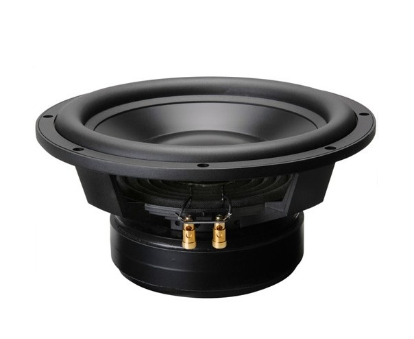

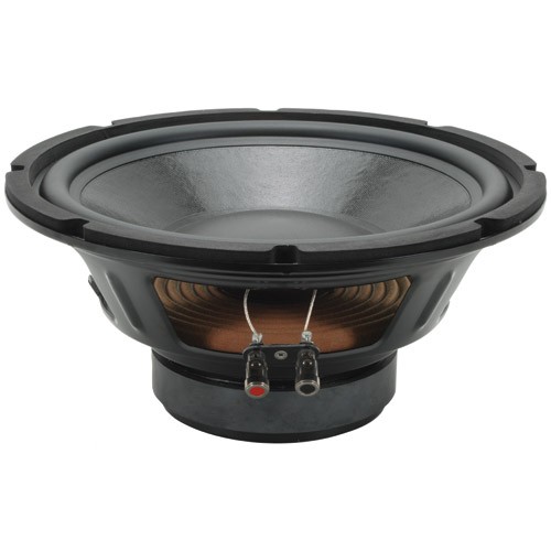

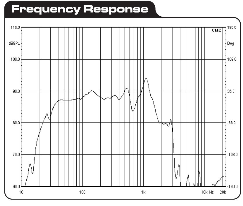

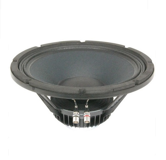

EMINENCE DELTALITE-II 2512
MC CAULEY 6232

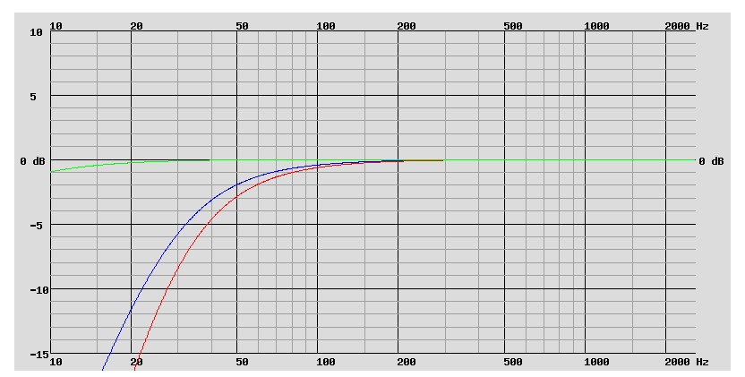

Well, I'd probably go for the McCauley 6232...

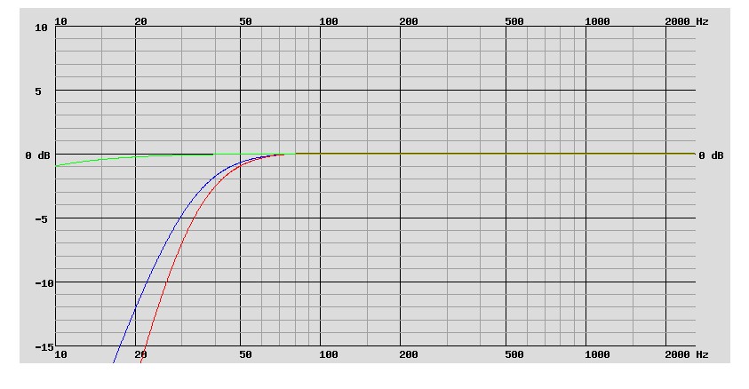

5. Mc CAULEY 6232, VB = 120.0 L, FB = 26.0 Hz (int. volume/tuning), F3=36Hz/26Hz in room, max. SPL 1.00m/118.1dB :up:
McCauley.com : Products: Components > 6232: Overview
6. EMINENCE DELTALITE-II 2512, VB = 120.8 L, FB = 28.9 Hz (int. volume/tuning), F3=42Hz/31Hz in room, max. SPL 1.00m/114.5dB (price) :yes:
Eminence Deltalite II 2512 Neo 12" Driver 290-593

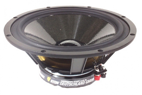

7. ETON 12-680-62 HEX, VB = 120.0 L, FB = 23.0 Hz (int. volume/tuning), F3=31Hz/23Hz in room, max. SPL 1.00m/111.2dB. Very low extension, can work in smaller box to 84.6L.

I've decided to use this cabinet to build the best subwoofer possible for primarily listening to music (90%)
The McCauley 6232 looks very good in a BR box 97-120L and has very nice SPL.
What are you thinking?! 😉

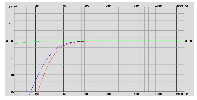

  • 7. ETON 12-680-62 HEX, VB = 120.0 L, FB = 23.0 Hz, 87 dB2.83Vm. F3=31Hz F6=23Hz F12=18Hz F24=12H.jpg
  • 6. EMINENCE DELTALITE-II 2512, VB = 120.8 L, FB = 28.9 Hz, 91.3 dB2.83Vm. F3=42Hz F6=31Hz F12=22.jpg
  • 5. MC CAULEY 6232, VB = 120.0 L, FB = 26.0 Hz, 88.9 dB2.83Vm. F3=36Hz F6=26Hz F12=20Hz F24=14Hz .jpg

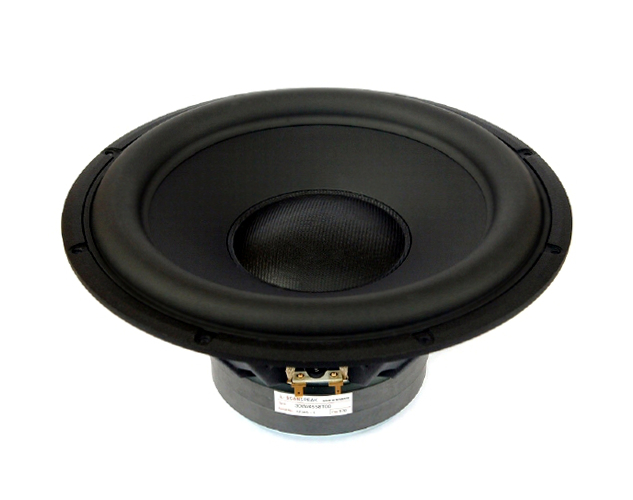

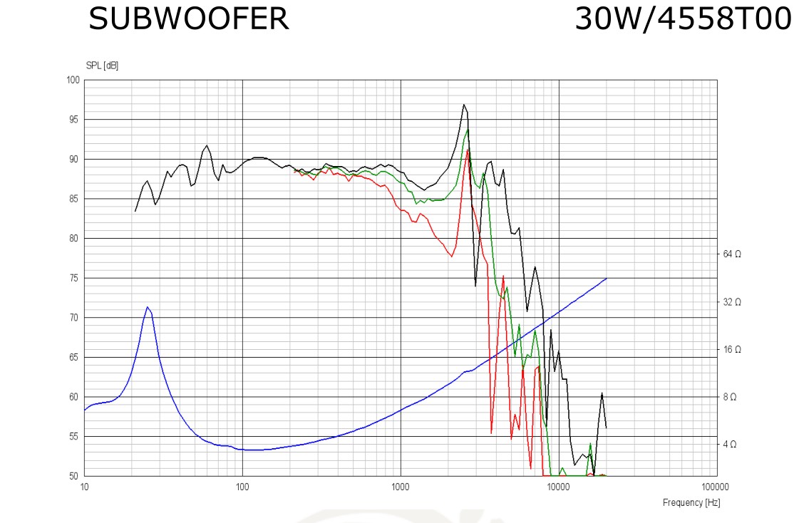

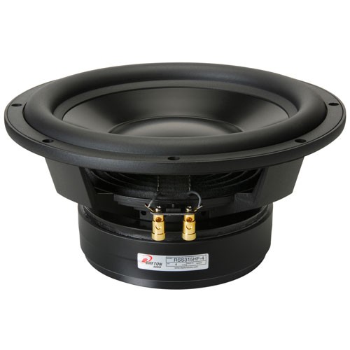

After much deliberation, I've pretty much decided on using two DAYTON AUDIO RSS315HFA-8 subwoofers in a sealed design based on the advice of one of the folks at Parts Express. However, I noticed that this is the same two drivers that are used in the Dayton Audio RS1202K subwoofer kit, which comes with a 2.1 cubic-foot sealed enclosure (about half the volume of the enclosure that I'm using). Furthermore, WinISD calculated a volume of 194 liters for this design. What am I missing? Does the opposed-firing design of the RS1202K make this smaller volume possible? I just want to make sure that I have the right information before I make a purchase.
