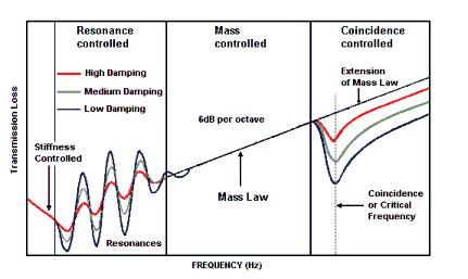

As far as TL goes, according to one site "The best barriers are heavy, high mass, limp, highly damped materials with a high weight to stiffness ratio such as sheet lead or mineral loaded polymeric vinyl." ([url]http://www.domesticsoundproofing.co.uk/tloss.htm)[/URL]
"At low frequencies the stiffness of the material is the main controlling factor. Just above this point, various resonances cause major variation in sound transmission. "
This demonstrates why bracing is needed in subwoofers - stiffness control.

These are normal diagrams , BUT I see "IDEAL", "IDEAL", "IDEAL".
They appear as based on measured data to me. Perhaps they have been smoothed a lot, but you get an idea.
They don't really show bass, but if you extrapolate the curves, you get a fair idea. Better performance might be achieved, however, due to bracing, as this is data intended to be used for noise reduction in rooms, where the materials span further.
The attached file gives an idea of how transmission loss through a material is different through different parts of the audio bandwidth. In a subwoofer, the mains concerns would appear to be mass and stiffness. You can see how with a fullrange speaker, things are different. In the resonance controlled region, a speaker box made from solid materials with a high Q and low daming (hardwood rather than softer timber or MDF, or metal or plastic perhaps) would suffer in the lower midrange.
In the midrange, damping in the speaker box has more effect. I'd say the midrange is perhaps the area most likely to suffer from box coloration, but in this range it is easier also to have a more inert box.
It all becomes more complicated where you have to also consider both transmission loss and the vibration of the box via the mechanical coupling of the driver to the box. This is where I see value in attaching the driver to an inner box, then placing another box around it with a damping layer in between - constrained layer damping. If you built a push pull arrangement with the drivers on opposite sides of the box coupled to a constrained layer vibration damping design with matrix bracing on the inner box, then you would have a box that would perform very well. Use a sealed box with a pair of XBL2 drivers and you would have something very accurate.
