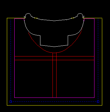

Here's a plan to describe (actually it's a section).
The driver is attached to the inner box (magenta), but not flush mounted as you would normally do. The red shows the bracing.
The yellow is the outer box. The hole is cut larger to accomodate the outer diameter of the face plate.
The dotted blue line (ignore the little squares in the corners) is the damping layer, which would be the liquid nails adhesive.
No, as you can see, the woofer is flush mounted as you would normally have if you had double thickness walls, as some do. The difference is that the adhesive is flexible and the layers are not rigidly connected.

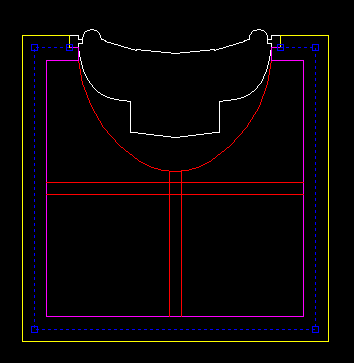

Basically you build the bracing, then build the inner box around it. You then partly assemble the outer box, apply the flexible adhesive damping layer, and progressively add the outer box, then fix the driver. It requires a little more care, but isn't by any means the most difficult sub box to build.
Thanks for the drawing, I think I fully understand what you guys were talking about now, but I've got a question (or maybe a suggestion). I think the construction could be made much more simple if the front baffle did not have a layer of damping material between the inner and outer walls (see pic, sorry paul, I kind of mangled yours). Would this still provide much the same effect? I'm guess it would for the most part, but the more isolated the inner box is the better.
I assume what you are talking about is removing the damping adhesive layer on the front baffle. This is probably not a good idea as the outer and inner box would then be connected on the front baffle and vibrations would transfer through. This would mean a loss in performance without any real simplification in construction. If you want to build a box within a box following this CLD technique, then you pretty much have to do it as I've shown, otherwise you might as well just make the walls thicker or use bracing as you see required. Otherwise you end up with the extra effort of CLD construction (although it isn't that bad) with performance that is no better than a more conventional solidly built box.
Now if I misunderstand your description and you in fact mean make the front baffle just one layer thick, then this becomes a significant weak point in the box, you certainly don't want this.

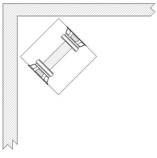

When you do a sub push-push, where do you put the drivers? Can you position it in a corner or are you restricted to putting it out in the open?
-Josh
-Josh
jdybnis said:When you do a sub push-push, where do you put the drivers? Can you position it in a corner or are you restricted to putting it out in the open?
Drivers are placed on opposite sides of the cabinets (ie back & front or left side & right side -- or if lucky one driver on each side)... i have at least one client that uses his in a corner -- set on an angle
If you were designing for a corner, you could make the box 5-sided to have it stick into the room less (in this case the plate amp faces the corner)
