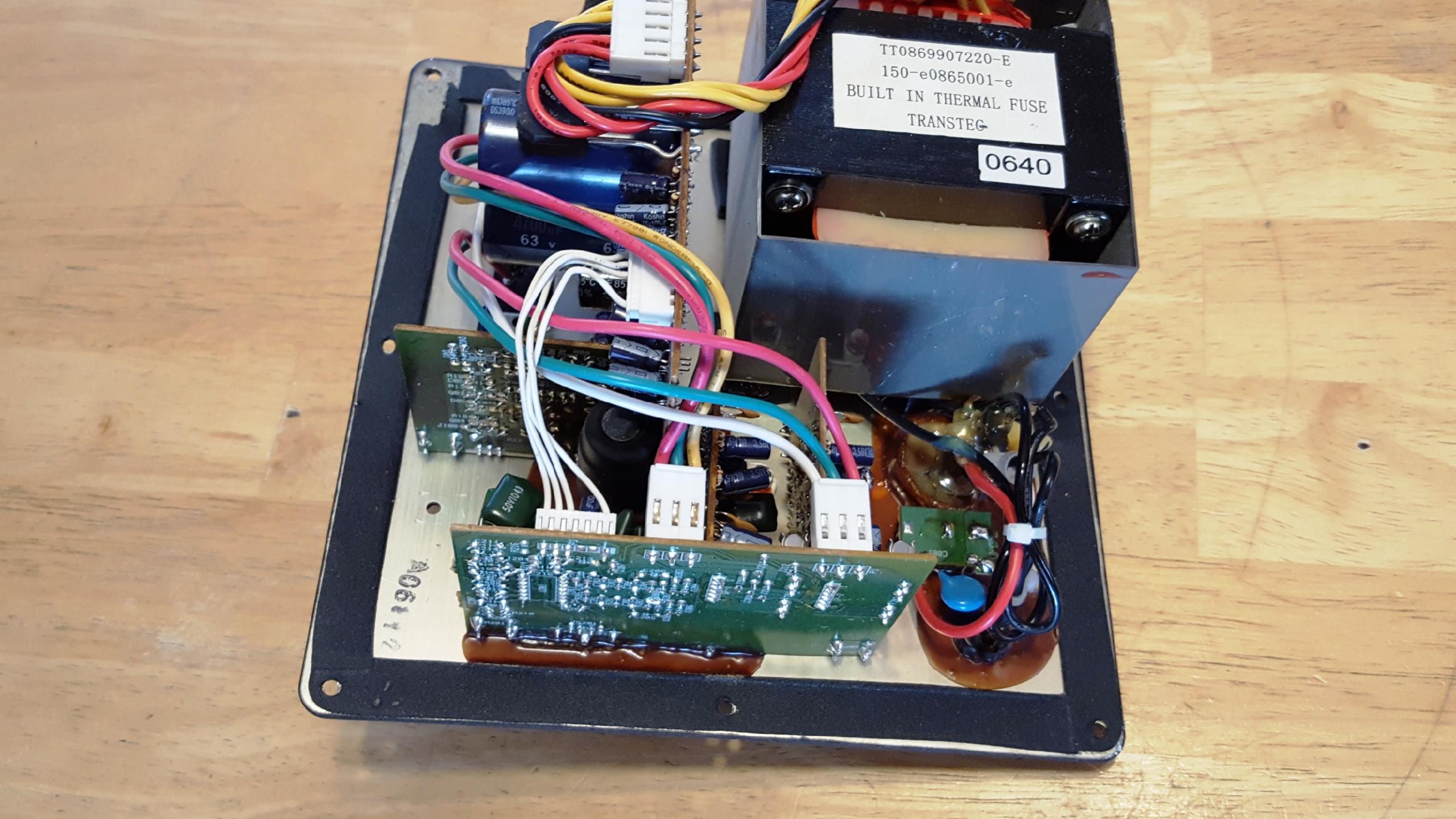

Not an unreasonable request to ask for pictures. So I went in to do that.
Especially on the LF PCB amp board.

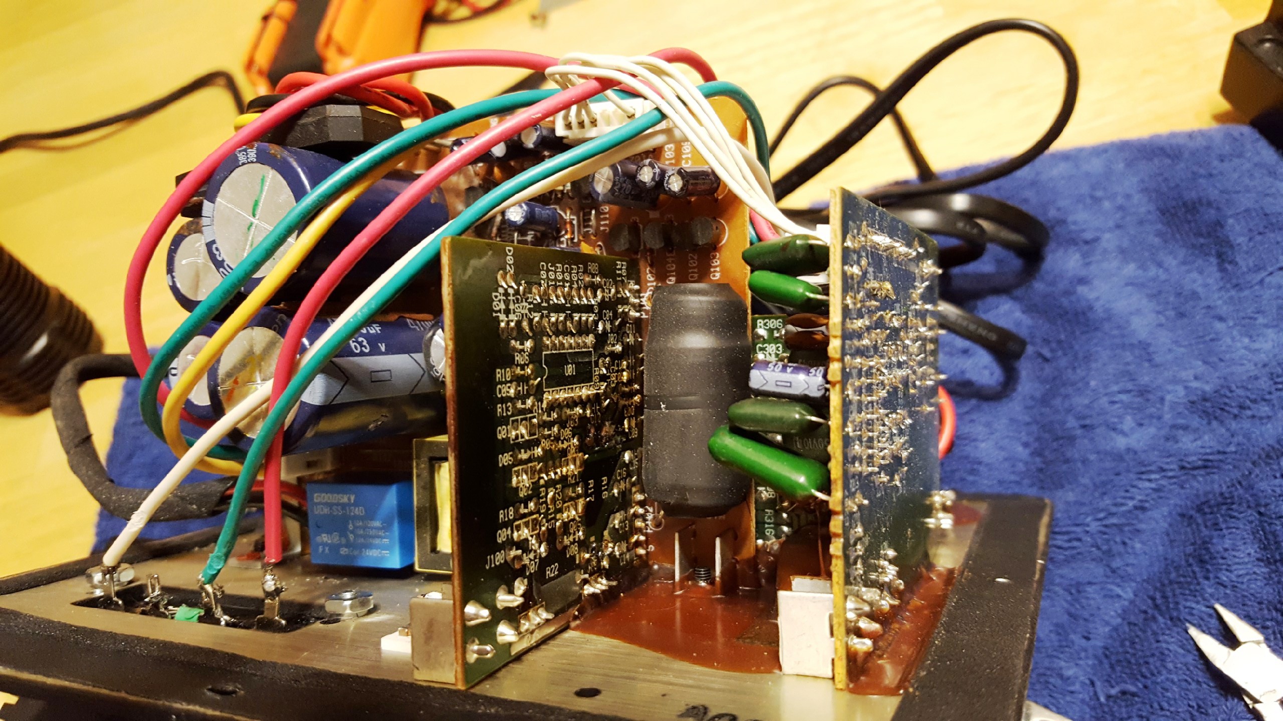

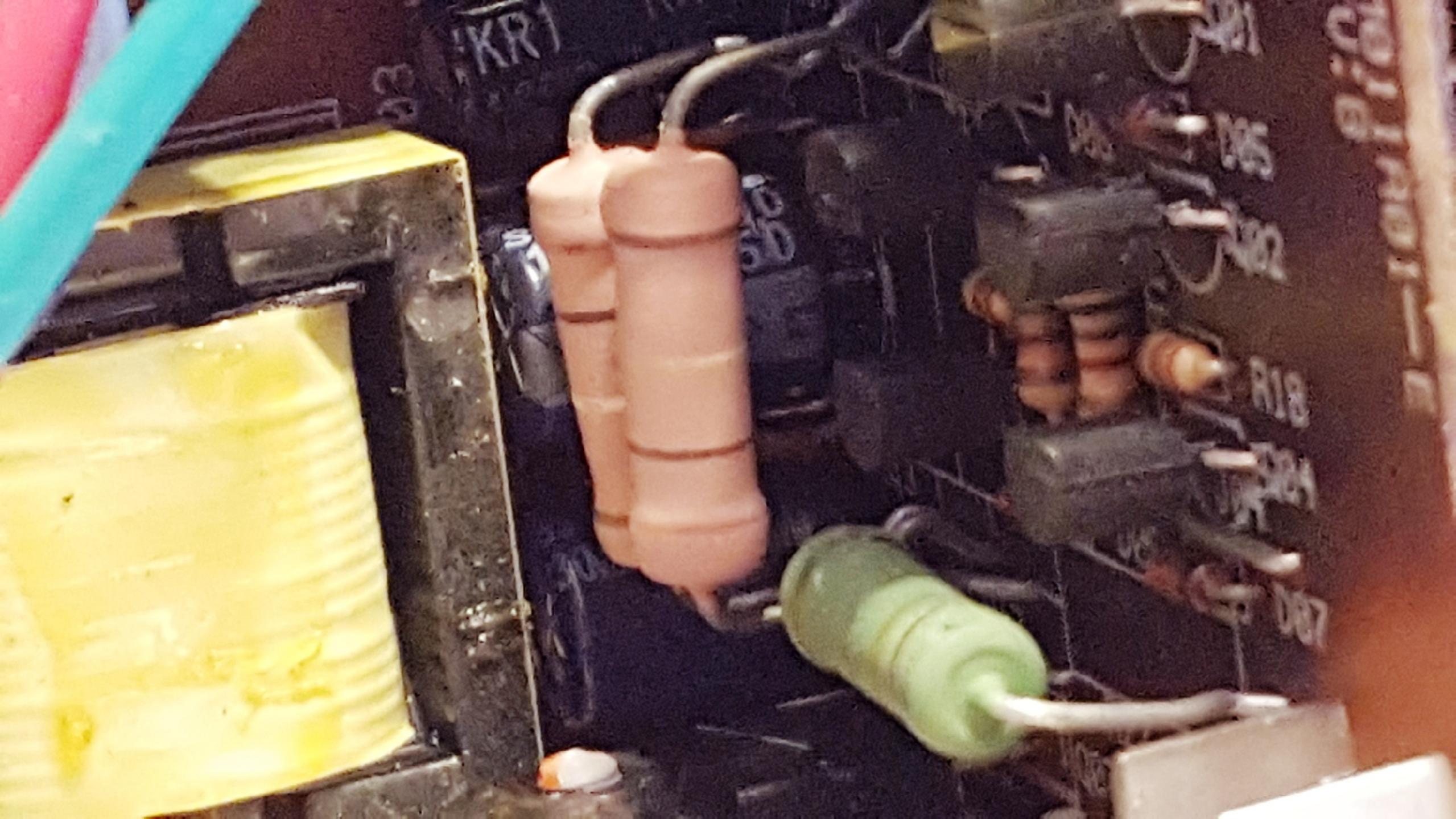

Lo and behold.... I remove a bracket holding the main PS board and I have access and can see clearly that 2 resistors are loose. (see below)

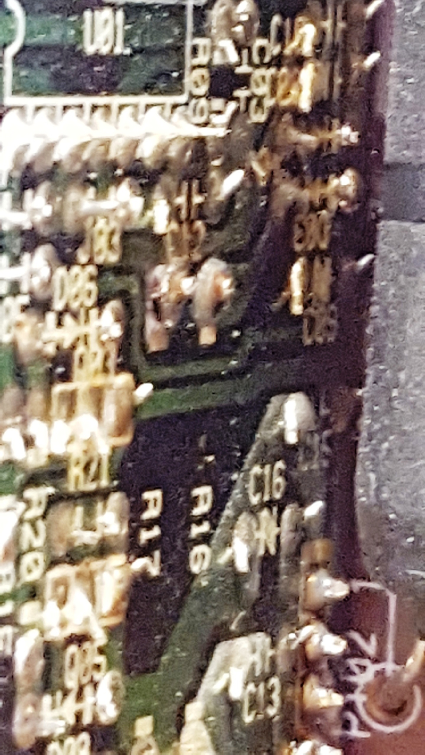

But on closer inspection, I see that it wasn't a bad or cold solder, but rather the pads have lifted. DAMN! I have access to easily resolder a cold solder. But repairing pads and or traces requires a more complex break down. (disassembly, including the Mosfets from heat sinks and most likely desoldering boards apart.)
So close, but NOT. More like so far! LOL
At least I found out what was wrong (tanish resistors loose). Now time for an expanding of my capabilities! Any tips might just help save the day! Or another frustrating experience! LOL
Pictures below! You can see the lifted Pads above the R16 & R17 Print!

Three of the four pads of the two tan resistors (copper trace area around the hole for each component) pulled off the PCB from heat I guess. If they were intact, they could be resoldered in 20 seconds.
Now a disassembly to get that board isolated so I can strip that green coating on the nearest leads and solder jumper wires or, maybe replace the pads if there's some kind of kit and video on how to get it right the first time doing it? Hopefully, you guys can recommend some good resources!

So the two resistors are 1K each. One for R16 and one for R17. Mine might be the early version where they used 1 watt resistors. The latest Schematic now spec's 2 watts each. Might that have caused the heat to lift the pads? The two resistors in there are 0.625 inches or 15.9 mm in Portugal. I doubt they are 2 watts. Aren't most 2 watts bigger? So if I was to put 2 watt resistors in, would that handle the heat better, or would two, 2K Ohm, 2 watts in parallel be the best cure for heat? Metal film or Carbon? The spacing for the resistor holes is 0.8125 inches or 20.6 mm in Portugal. (on my visit list for the food and wine, people too).

Just so I don't get any additional problems, I think I'm going to use two 2K Ohm 1 watt resistors in parallel in place of one 1K Ohm 1 watt resistor to minimize heat via divergent paths.
