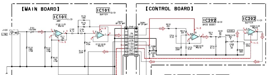

Attached is my current TPA3255 circuit. (I know it is pretty rough. I drew it quite a bit ago.)

Hi @wiseoldtech !
Hmmm, so I see that first, the audio in goes to a op-amp for amplifying, then to a op-amp acting like a buffer. The buffer is to prevent audio degrading over longer cables between the main board and the control board. Then, on the control board, the audio is fed to another op-amp that boosts the bass, then to another op-amp buffer for the trip back to the main board.
I have no distance problems, as the audio in and the amplifier are within inches of each other, so I just need to figure out the bass boost.
I have created a 100hz low pass filter using a chain of three RC filters then a BC548 transistor to amplify the resulting filtered audio. This "works" on a kind of subwoofer I have, but it definitely doesn't sound the best. I also know some about op-amps, but not much. I do know enough that I think I am looking for a 3rd order butterworth filter (right?).

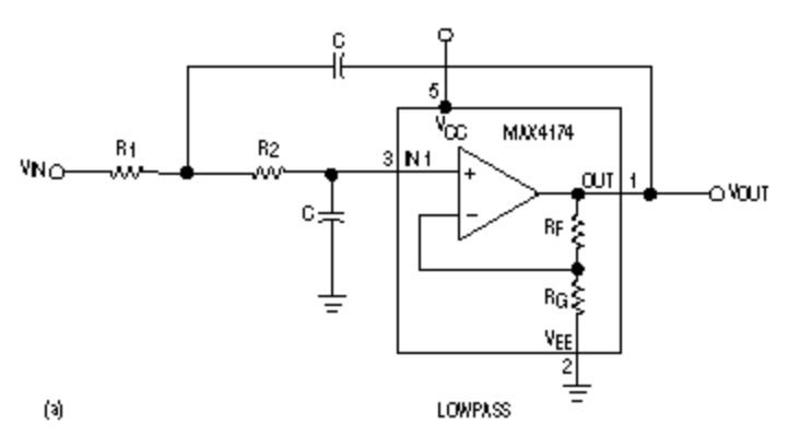

A Sallen-Key toploogy is probably your go-to. Search: Analog application note op-amp filter design. Analog has a filter wizard, and Texas Instruments should have one, too.
Someone had a whole PDF book chapter on op-amp filters but I can't find it at the moment. Of you're not sure where to begin, a 4th order Linkwitz-Riley filter could be a good bet. The roll-off is slow for the filter order, but that makes it more stable and will prevent unwanted boom or overshoot.

Those boards are only a foot apart, so no issue with signal degrading.
The whole thing can be built on one board.

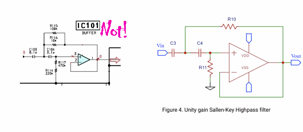

The first one on the left looks like a buffer ( probably very necessary), and the 2nd op-amp is configured as a high-pass, so the resistors and capacitors are swapped around. There is also a slight difference between unity gain S-K filters vs the ones with gain resistors.
Generally, it's not something that can be whipped up in an hour without a high chance of mistakes or reduced quality (e.g. a high noise design). I say take your time, use a spice simulator like LT spice or TINA, and good night from me for now.

I'm a newbie clearly lol. From what I've read so far, I have seen that buffers are useful for stopping signal degradation. Why are they used in that schematic?

EACH op amp is serving a different function, and several are configured for dropping the 'highs' in stages as seen in the print. C214-215-216-217....
Again, consult the schematic to understand things.
Ah, that makes sense! Thanks @abstract , I was a bit confused why they were swapped. I haven't ever used LTSpice before either, so I am going to have to figure that out too.
