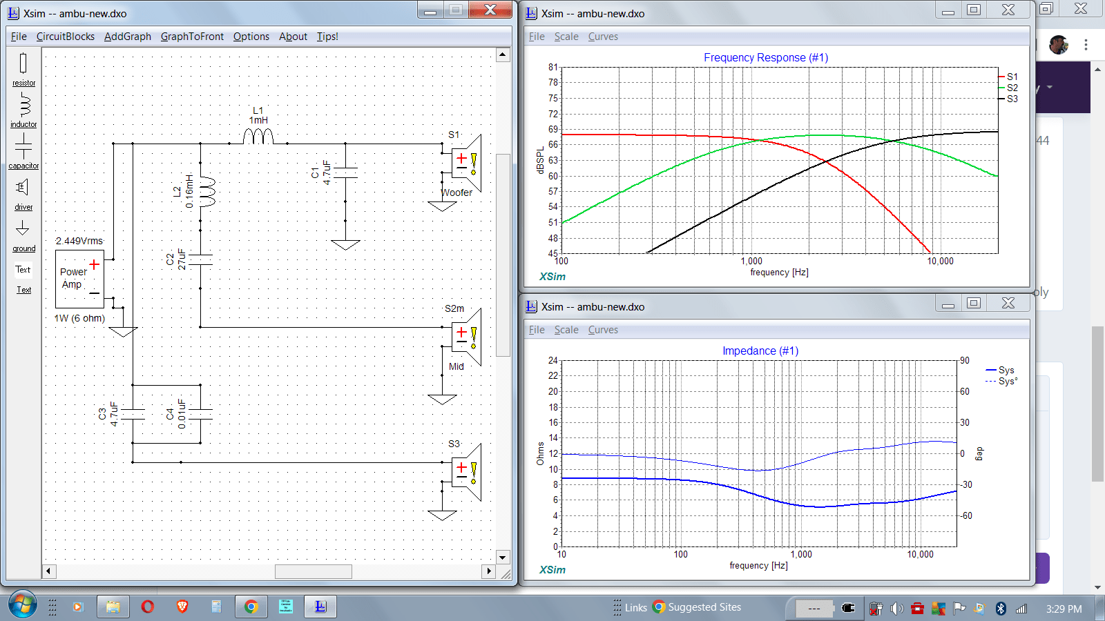

had this doubt and rather than start a new thread I thought I would piggy back my questions here. It also shows I have been searching for answers and reading up lol.
The other day I purchased a 3 way cross over from the junk yard. I have word out in the scrap yard. And they call me when they find intresting heat sinks and crossovers in the junk.
This 3 way cross over has something I have seen for the first time.
Here is the sketch I made of it. In Xsim
1. Look at C3 and C4. I have not see this in many designs. So I started to read up on this its called a subsonic cap filter.
It says it helps speed up the working of the larger cap. Could somebody explain in simple english how this works ? I can see the impact in the simulators which seems to treat it just as if your adding two caps in parallel
2. My Second question is the need for Subsonic filters on LP Players. Yes I know warped LPs result in rumble at about 1-10 Hz.
But I have been studying on RIAA standards. Is it not part of the standard to subtract huge amounts of signal anyway in the 1-30 Hz range if the RIAA standard is already doing this why do we need a subsonic filter ?.
