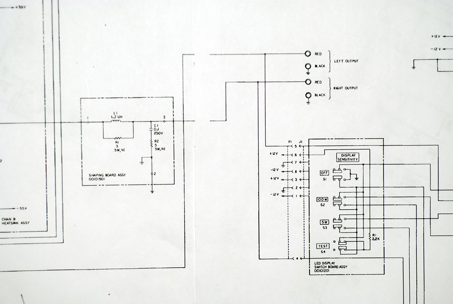

If you're talking about C1, it's a Zobel cap, not coupling. Unless it's really, really bad, changing it will have close to zero effect on the performance. You don't want to change the value- what it does is helps keep the amp stable at very high frequencies under some odd (but possible) reactive loads. A cheap polypropylene is more than good enough.
a lossy MKT, or MKS would do in the Zobel location.
It should be completely inaudible if it is doing it's stability ensuring job correctly.

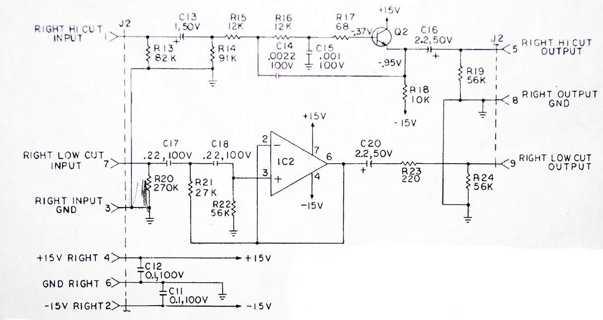

There is no getting around using this filter so I would at least like to try to change the cutoff frequencies to include as much of the audible frequency band as possible. First, I have no idea where the hi & low frequency cut off is occurring and 2nd what values I could substitute to extend the cut off. I would appreciate it if someone could help me modify this circuit. Having listened to this circuit the low cut off is not too bad considering my speakers are only flat down to 38 hertz. But the high frequency cut off is way too low. I would like to extend it to 20khz. Maybe 35hz to 20khz. I have attached the schematic. Any help or advice is appreciated.Great question , thou !

You have there two Sallen-Key filters, one high pass (low cut) and and low pass (high cut).
The high pass uses an opamp, wired as a follower. The frequency response is set by R21,R22, C17,C18.
The low pass uses a BJT emitter follower. Frequency response set by R15,R16, C14,C15.
Do a web search for Sallen-Key filter. The standard circuits will refer to R1, R2, C1, C2 so you need to match these to your circuit. There are always two components in series feeding the follower input (Rs or Cs). Then there is a component to ground at the follower input (C or R), and a component (C or R) from the follower output back to the junction of the two series components. The actual numbering may vary from one author to another so I won't confuse you by trying to second-guess here.
PS if you move the filter frequencies outside the audio band then all they will do is add phase shift, without actually reducing any unwanted signals - better then to simply omit them. With the Sallen-Key you need to calculate both frequency and Q.

Thanks for pointing me in the right direction. There are several calculators available to help determine values. I need to spend some time absorbing this information. The concept seems simple but I am not an engineer and some of the language is beyond my knowledge base. Meaning I still don't know what to do but I would like to change the resistor values because I have already selected some nice capacitors for this circuit.
