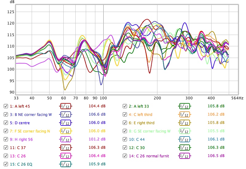

There is no question I get greater output and a smoother phase plot with them out of phase.
Using a xilica box and REW and thousands of measurements and adjustments. Still the best those drivers perform is when they are out of phase. Measurements taken at the listening chair at ear height.
Rick, in your case, also the delay you use to each speaker and any EQ you apply SEPARATELY to the speakers. Otherwise, its all just noise.

I use simulation software and find that they can give an idea of trends once you do quite a few of them. But if you think a simulation can approach a REAL LIFE measurement ... oh, well ...
OF COURSE, the room is the problem! If it wasn't I would not have bought DSP boxes. But it is a given, it is what you are stuck with. There is nothing I can do to change the room. I have as much acoustic treatment as my ears tell me has not ruined the sound. The room is about 16 x 24 with a slopping ceiling starting at just over eight feel (speaker end) and rising to nineteen feet at the back of the room. Listening chair little more than halfway back with a Waslo inspired but further refined diffuser on the back wall.
Get going and measure your system. If you have DSP - don't be afraid of trying things and seeing what happens.
Thanks for this Ben.One mic location and 14 sub locations.
If you could post a little diagram showing the room size and your mike & 14 sub locations. Some actual DATA is slo....o...w..ly trying very hard to emerge from the noise. 😱

I did not post these curves so everybody could have a detailed post-mortem examination of the idiosyncrasies of my music room. i have stated my purpose and your purposes are simply highjacking.
You are asking for an enormous effort on my part for a benefit which I can't imagine except to gratify your curiosity or to verify some universally accepted but vague propositions about acoustics.
I crossover somewhere around 130 to 140 and have done so since 1968. Changes from time to time and today with my wonderful DSP, the crossover is not the same for sub as for large ESL panels*. Is there something insightful about the data that you can share from learning that?
