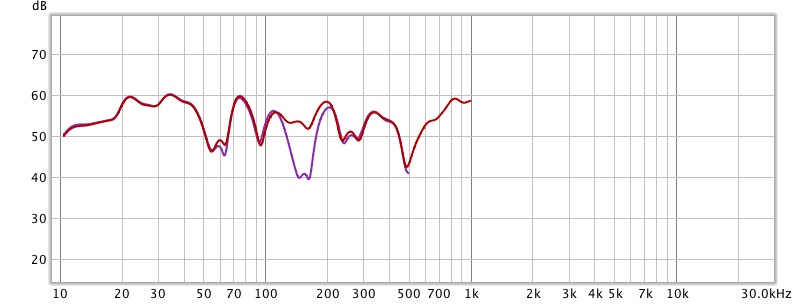

And if you are smart enough to have a DSP, you should wiggle the phase a bit. Below are shown two curves with my subs and my large ESL panels. In one of the plots one of the subs has a mere 45-degrees added (or subtracted, not sure).
I leave it to all the perceptive readers to guess which is the one that looks a whole lot better (OK, mostly in one dramatic place near the crossover point*). Let me add, after a long time of listening to my speakers, I certainly couldn't guess which curve I was listening to without looking at my Behringer DSP.
B.
* beats me how the heck anybody with a passive crossover could ever get their system right
