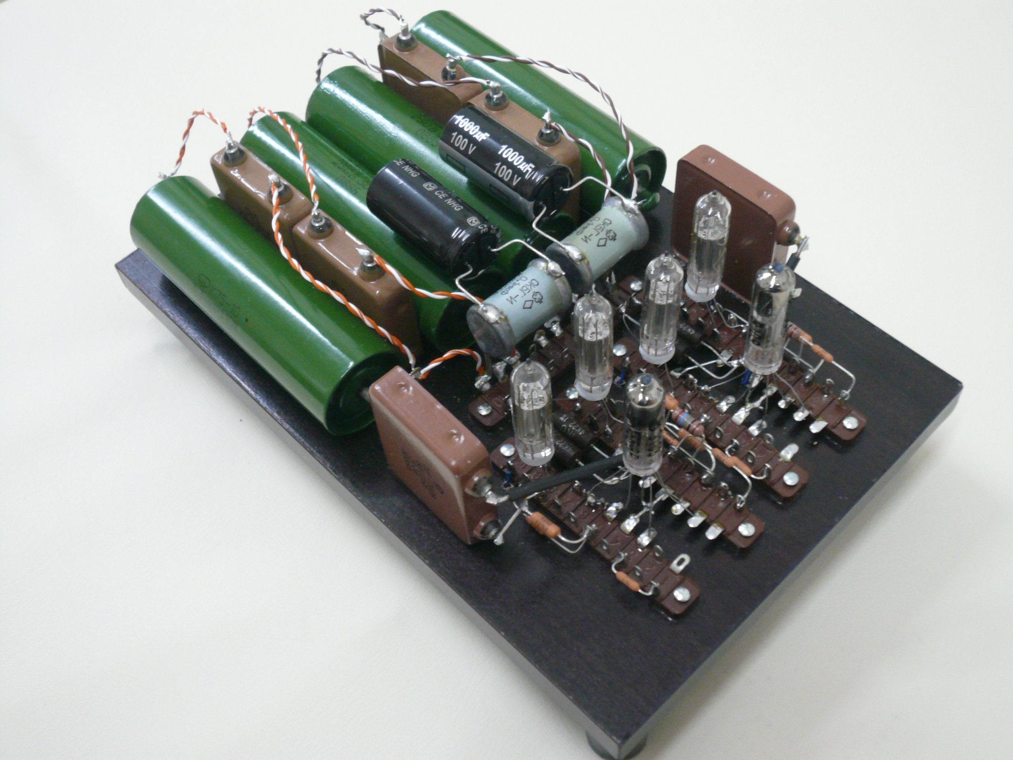

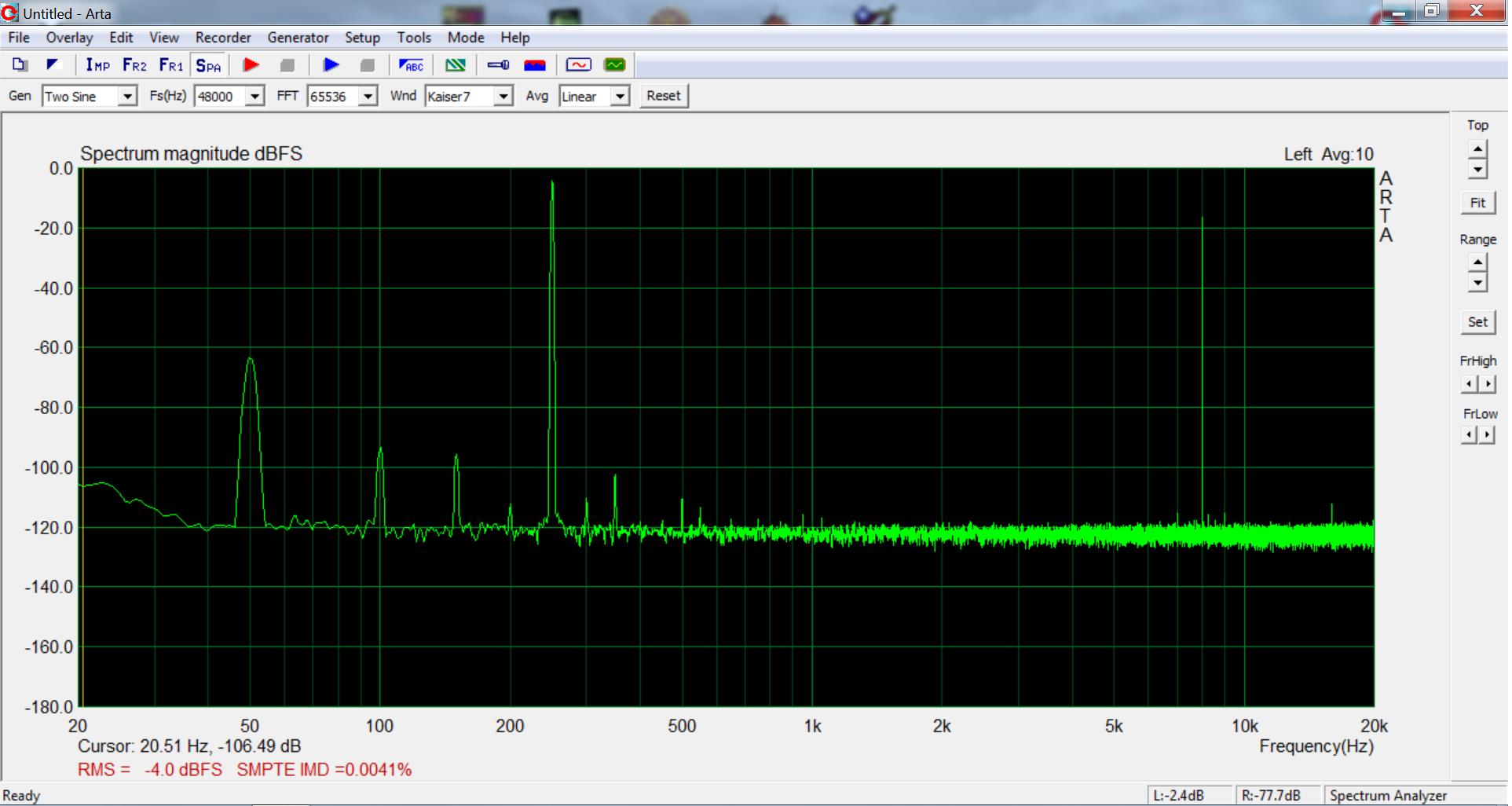

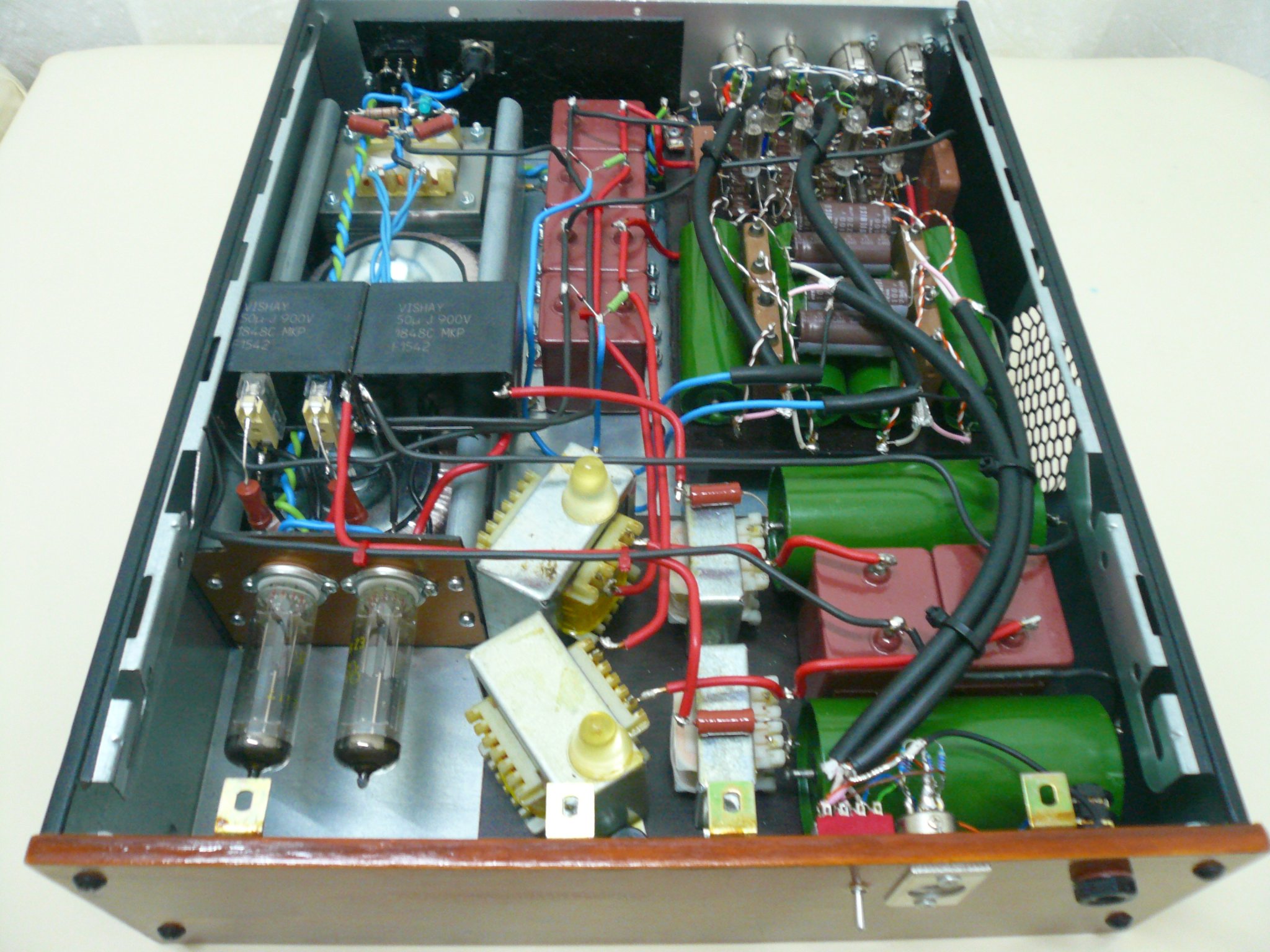

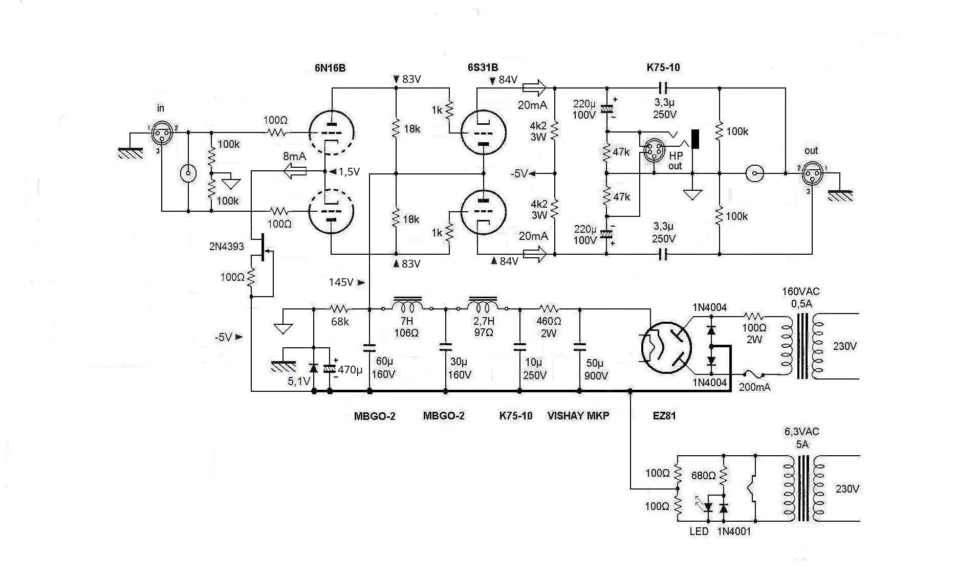

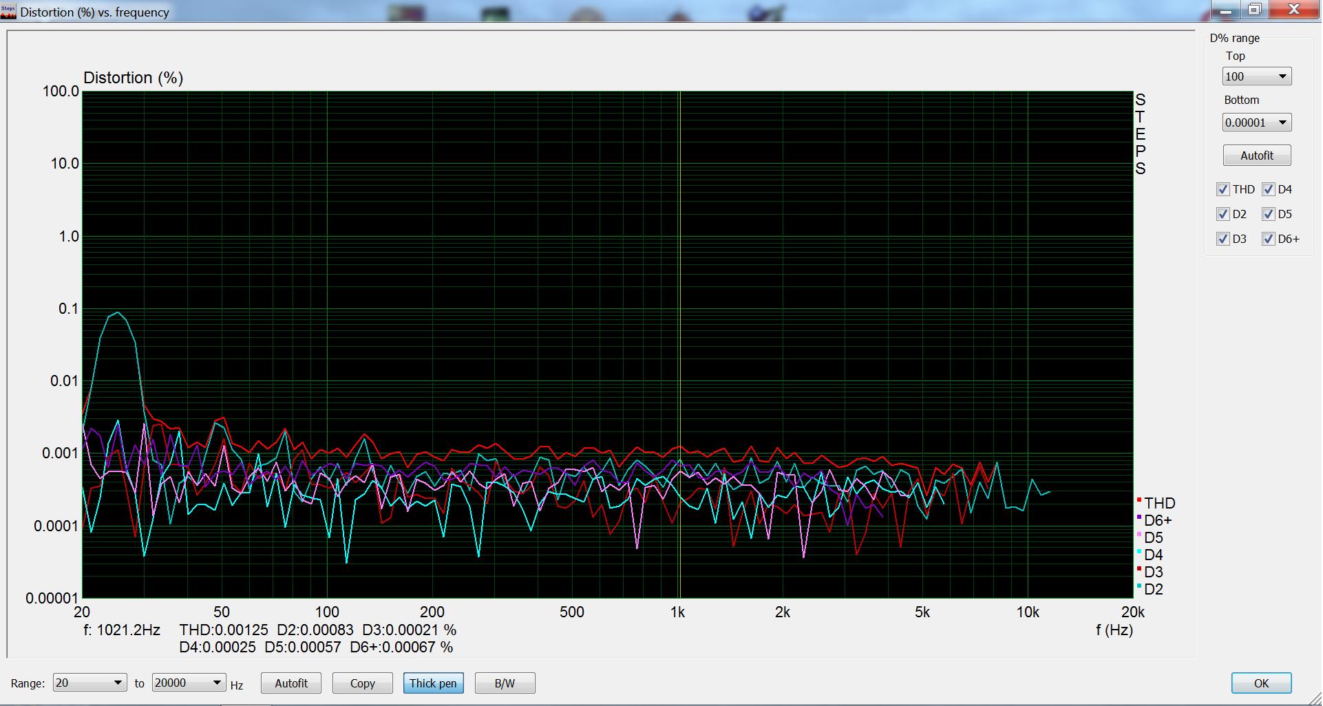

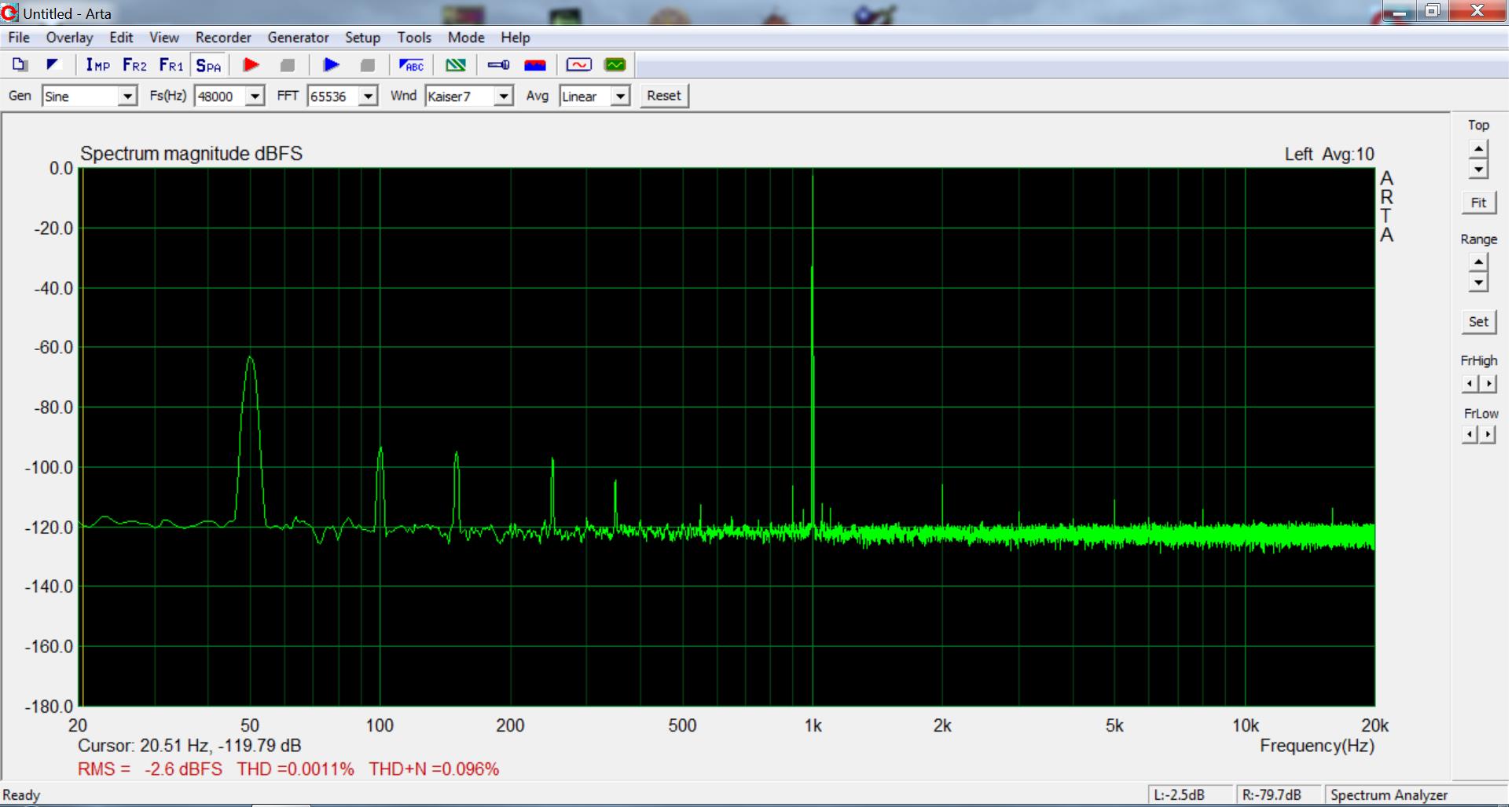

My take on subminiature tube preamp. Differential, high gain, high current, low distortion. I'm also planning to use SMPS for the heaters one of these days, I already have the converters.
