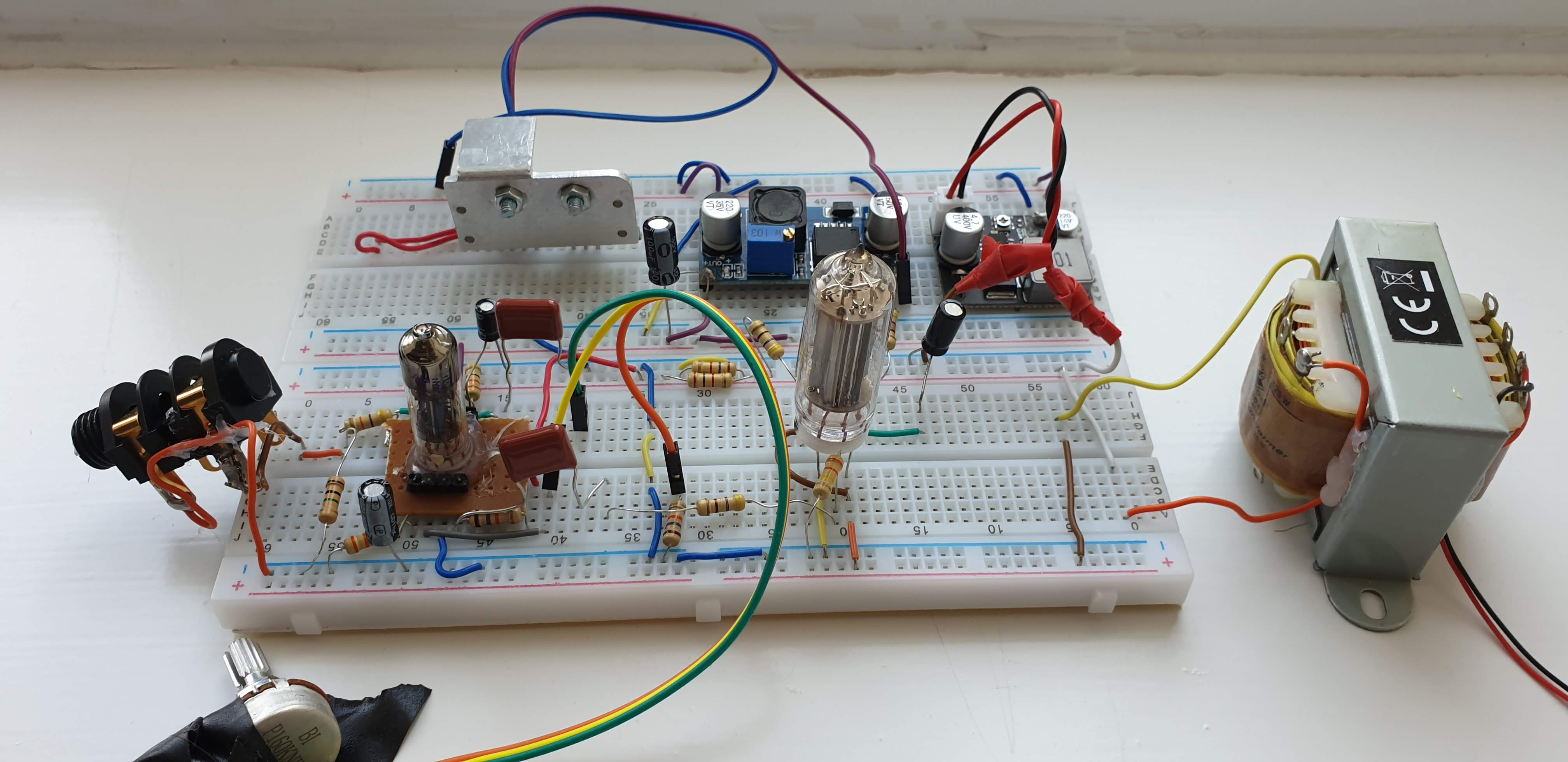

I have the amp working on a breadboard.
Using just one 6N16B, the sound is crystal clear. Sweet !!
However, when I connect the 6P30B-R, it picks-up all the electromagnetic noise around and generates a huge hiss, making playing impossible.
I am using a buck to generate the 6.3V and a boost to generate 180V. I know that this will generate lots of switching noise...
When I cover the volume pot with my hand, the noise goes a bit down.So, it looks to me, that I have antenas everywhere.
Any ideas?

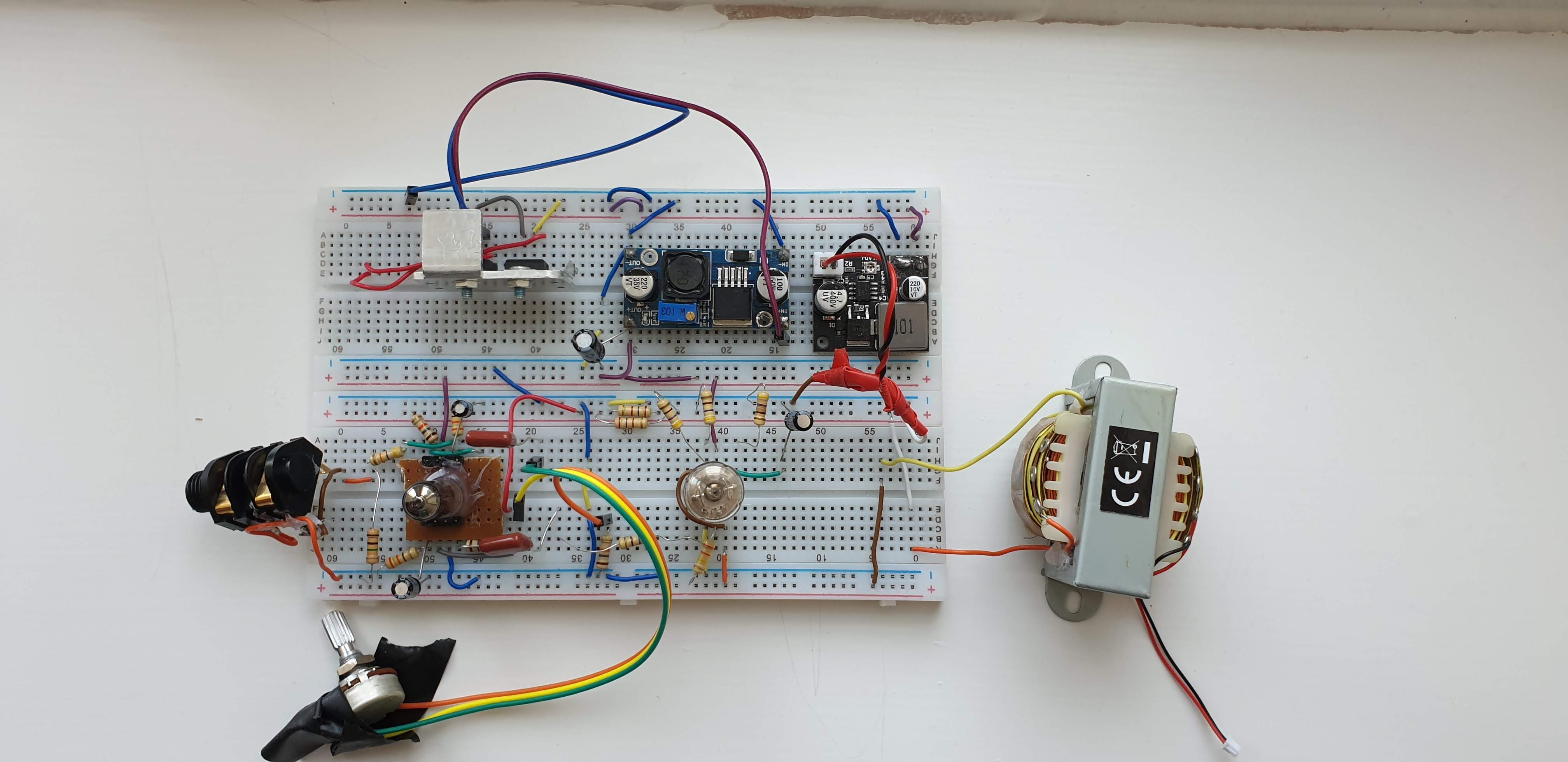

Any ideas?

when mounted in a metal case that will provide shielding
otherwise a open circuit on breadboard
is susceptible to noise.
Otherwise without writing a whole book in a comment.
With tube circuits. " Lead Dress" is important.
As far as basic wire routing to high voltage pins/ heater/ small signal
shielded wire also helps for small signal routing
and how/where you terminate the ground shield

1,
Do you have a capacitor in parallel to the grid leak resistor to help reject RF? On one stage? On all stages?
2,
The screen supply of the 6P30B-R is very important, as any other pentode, or beam tube.
6P30B-R Vg2 in my experiments is supplied by 230VDC, zener regulated, from the main HT supply.
The Zener is stabilised with 1000uF 75V capacitor bypassing to earth.
I had some white noise and a little RF ingress but it is mostly dealt with using the 2 measures above.

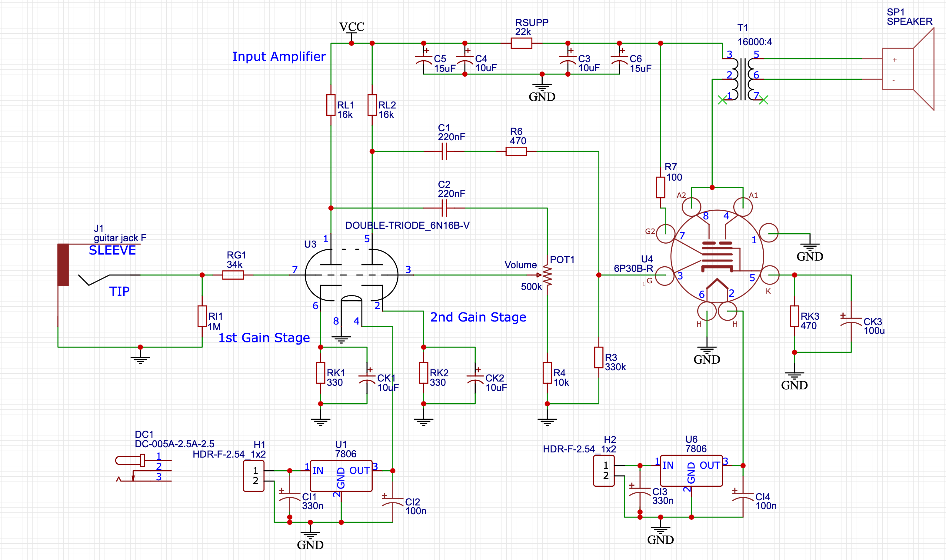

Please take at look at my circuit attached, maybe you will identify something else. The circuit looks a bit messy...

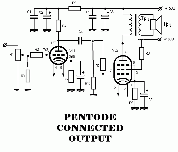

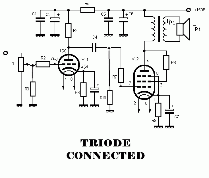

Ok, so you are triode wiring the 6P30BR.
In that case, no bypass is required, as you aren't running in pentode or beam power tube mode.
But a single device will make perhaps 0.75W in triode single ended, is this enough?
(runs to recheck the application)
Yes mini guitar amp...should be OK for quiet practice.
I think the DIYA user Wavebourn has made a small amplifier using these Subminiature valves too, maybe his threads are worth searching?
I have used them for a SET hifi amplifier, 3 in parallel for about 3 Watts.
If you are using that schematic, then perhaps try something like 220pF Mica capacitor in parallel with R10 at the grid of the 6P30BR, that may help your RF pickup.
If I am honest I don't like the low input impedance of the front end, grid resistor of only 10k!
Most guitar pickups are about 5k to 9k, if I recall correctly, and I would have believed a guitar needed a higher impedance load to drive (the input of the amp) but I am by no means an expert!
It's oscillating.
Put a 22-47 ohm into the anode lead and/or a small choke.
It's quite a common problem.
also run a DC heater and wrap the triode in silver (cooking) foil - earthed or you will get loads of hum.
Yes, parasitic (unwanted) oscillation is a likely cause for your hiss and noises.
R2 and R7 are not connected in the right place. As is they cannot work as "grid stoppers" and therefore cannot suppress oszillation.
R2 and R7 should be connected *directly* to the grid terminals as indicated in attachment #1.
And directly means as short as possible. Your tubes have wires which necessitates to cut the grid wire about a centimeter from the glass and solder R2 and R7 right there a cm from the glass.
Do the same with screen resistor R8.
To wire the output tube as pentode you can connect the screen grid G2 resistor R8 directly to the power supply 150V as indicated in attachment #2.

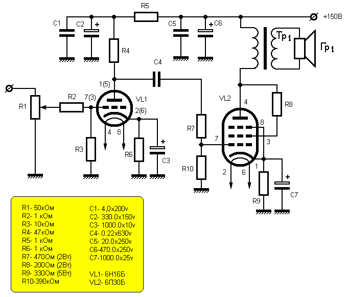

@Sorento By the way, my circuit is not the one that I've posted. That was just an example to check the pentode's connection.
My circuit is the one attached. Most probably you'll find some problems on mine too.
