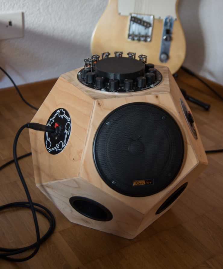

Since many years, I'm fascinated of subminiature tubes.
My first tube guitar amp was also built with subminis, see attached picture.
Perhaps it may be of interest for you to see some more details:
<http://adrianimmler.simplesite.com/440939017>
I created some spicemodels for subminis, but more fore west types like 6021, 6111 etc. You will find them in my lib provided on my site (link above).
cheers, Adrian

Hi Petro
cheers, Adrian
Hi Adrian,
I am fascinated, as well, for these little guys.
Your amp looks really nice.
I've chosen the soviet valves since they are way cheaper than the west type ones. Nevertheless I heard great things about the soviet valves.
I am still shopping, so I have time to change the valves that I am going to buy.
Pedro
