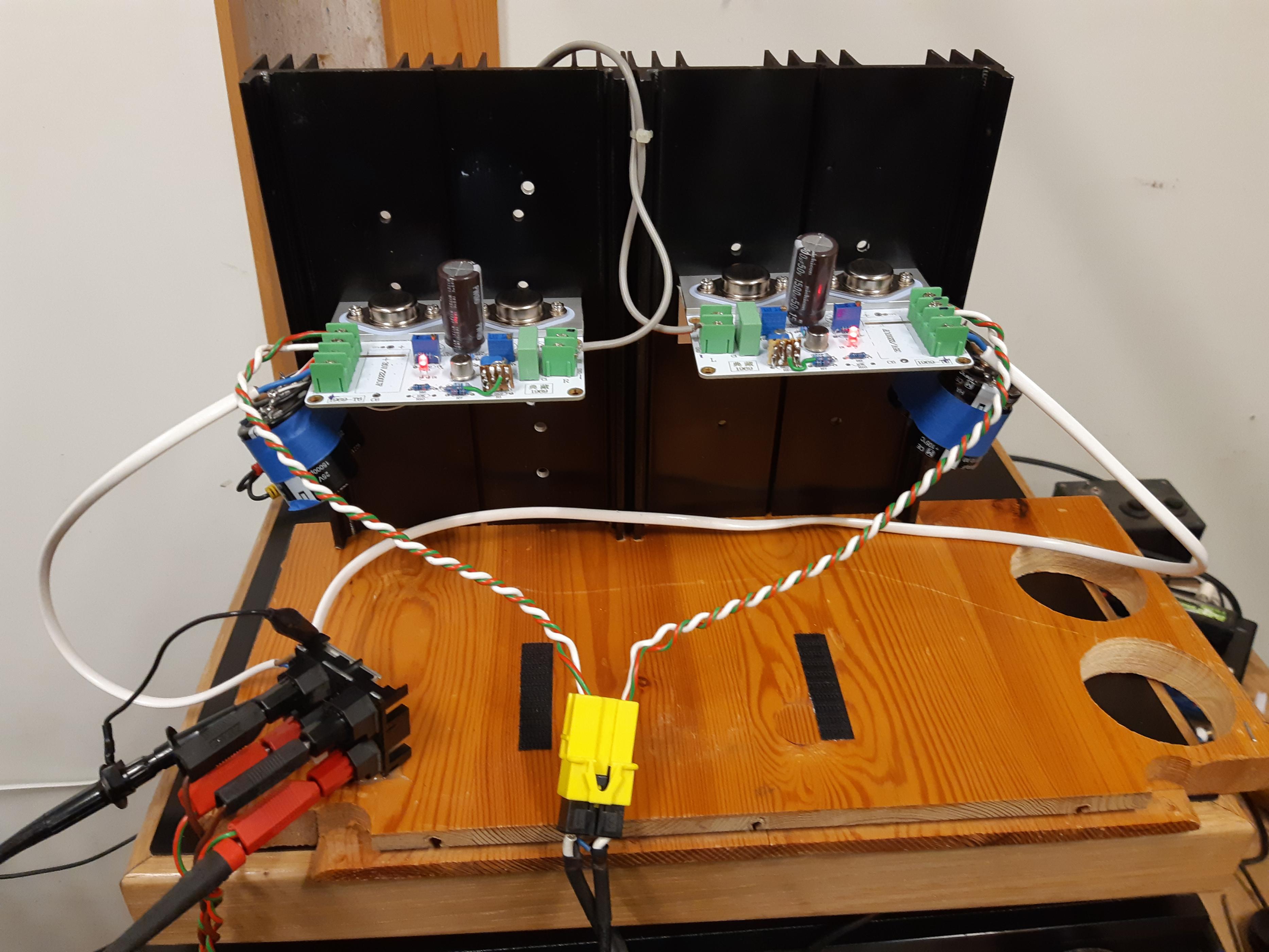

Below is a picture of my test setup. I used the power bricks and the base for my PNP JLH to get the dual supply for floating ground. Capacitors are 15mF.
I know, the supply cable got longer because I temporarily used the supplies from another amplifier. I don't want the supplies really close to the boards either, thinking they radiate some noise that might be picked up in the amps.

Adjust the 8.2k pull up current mirrors resistor , my power supply is few centimeters away with no problem .I know, the supply cable got longer because I temporarily used the supplies from another amplifier. I don't want the supplies really close to the boards either, thinking they radiate some noise that might be picked up in the amps.
