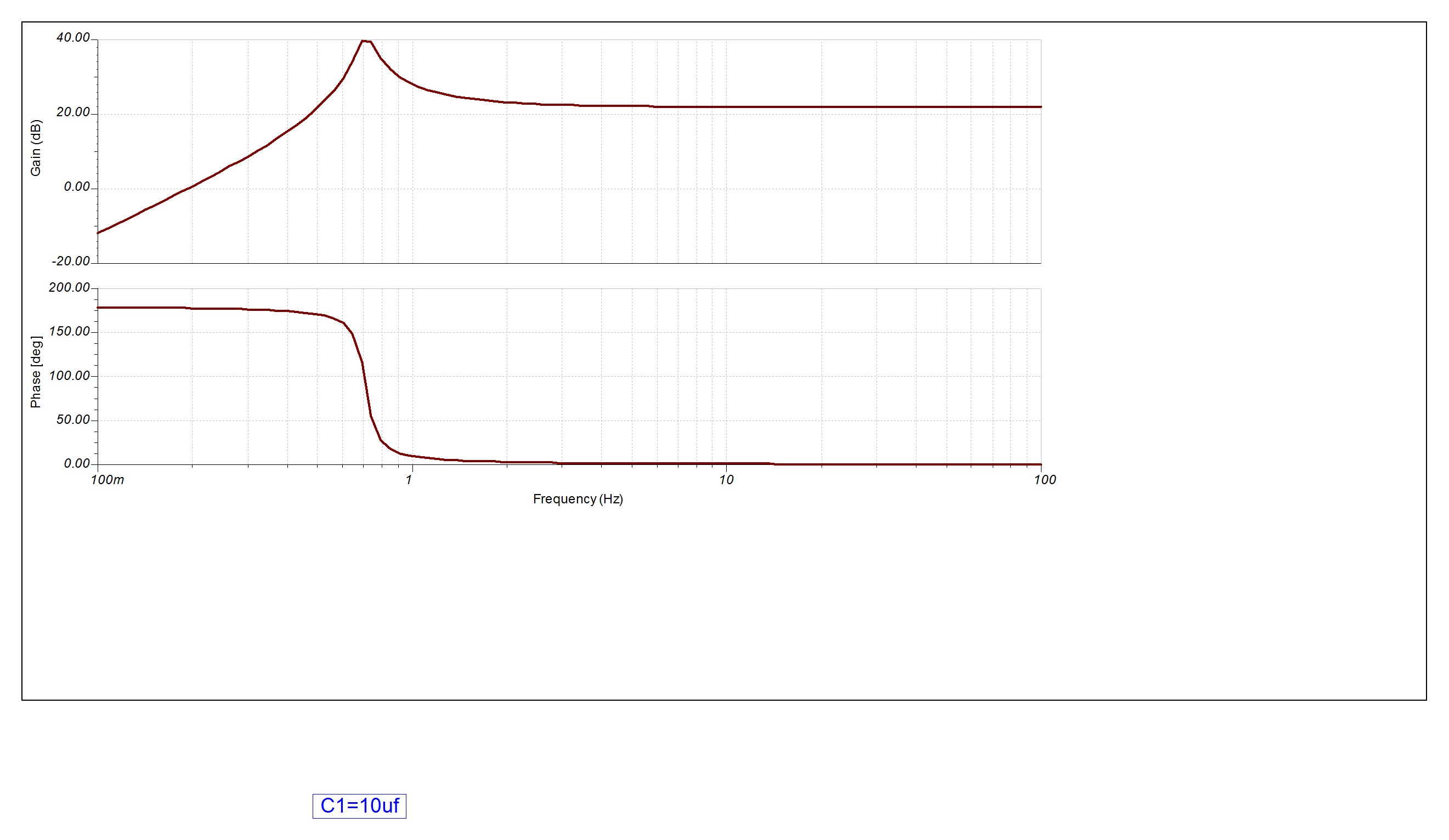

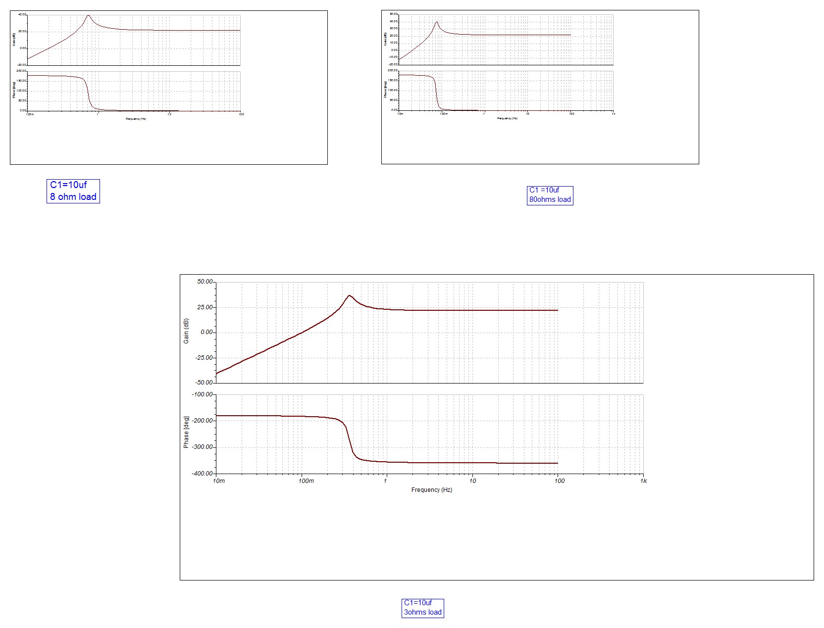

low frequency responce
Response with 10uf input capacitor.

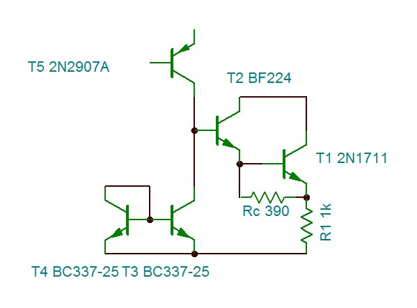

I felt frustrated that the 2n1711 cannot be replaced by any better one . I tried every type of semiconductor even the latest smd mosfets , hopless .So I decided to built a better one by mysef. At this stage the amplifier is still lacking a breeze , on szzzhhh sound the "h" is absent, particularly on female voices . This is due to the reverse c-b capacitance of the driver which is 4pf (bd136 is 30pf). To reduce it, I transformed the transistor into a darlington with an RF transistor , who's reverse capacitance is merely 0.25pf . On simulator the slew rate shoot up by ten fold and the distortion smashed nearly to third and it doesn't need any more roll-off capacitor . R1 flew away.
The two transistors will be mounted together with a 1/8w resistor on a seperate miniature board and replace the driver .The RF transistor is bf224 , it exist since 1965 , used in TV in IF section , widely available at tiny cost.
The 1henry inductor on the bootstrap , the Hammond 158SA is suitable . It has 40 ohm resistance , so it replaces the pull up resistor . It cost at Hawk 6.40$ and about 9$ at Mouser.

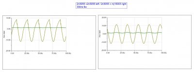

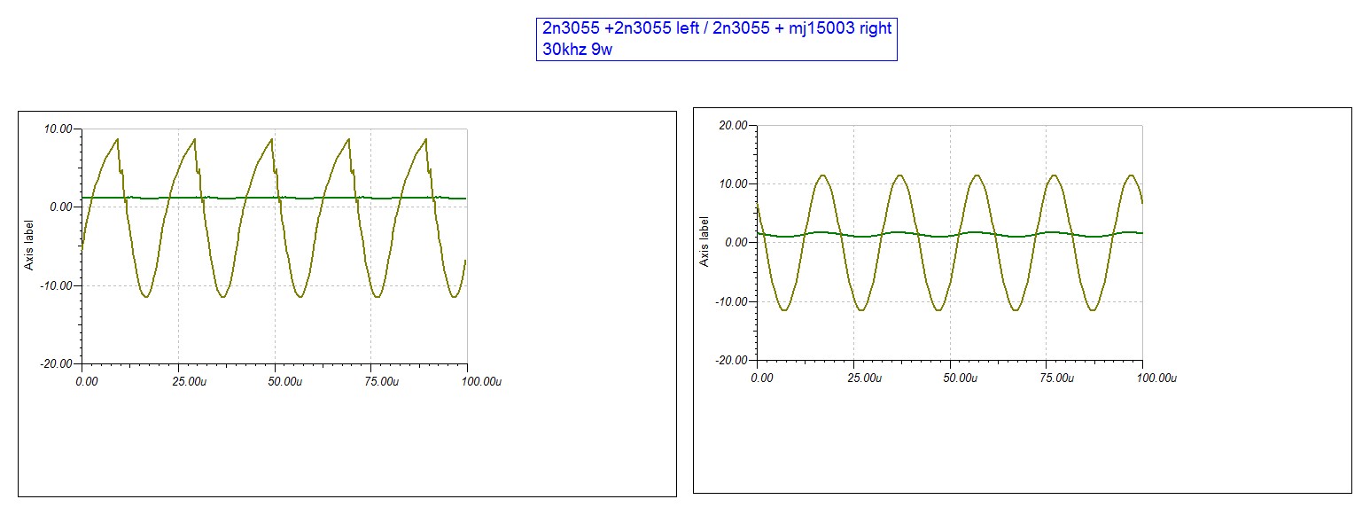

If I chose the JLH1969 amp ,I was 100% sure that it is a well cooked since 50 years by the chefs . I realize how I was wrong . Now I am struggling with the output stage to discover how bad it is designed . First I asked why it is biased 1.2A where 0.8A is necessary for 10w/8ohm . Another question is why JLH who tried a Texas Instrument transistor instead of Motorola , didn't try the 2n3055 very famous at that time .The answer I got when measuring the power bandwidth . The JLH gets at 9w 70khz , but with 2n3055 at 30khz on simulator is shown bellow . In order to have it running up to 70khz I must over bias it to 3A . As you notice on the graph the problem is in the upper transistor that I name it the co-pilot is not fast enough to follow the captain the ,lower one . As the transistors work each on different configuration and diffrent requirements ,why use the same transistor ? The co-pilot needs a faster but as low beta as the captain , I think by this the 2sd388 that Pioneer used in its best amplifiers . Looking for it, I found the 2sd424 is more easiy to find as it has been used in many prestigious amplifiers . So I will use this transistor unless you can advise me other ones , may be this transistor will need less than 250ohm shunting resistance which can eliminate the use of 1henry inductor. Only my ears can tell the issue . As it takes several weeks to tune , I can post the definitive version not before early January .

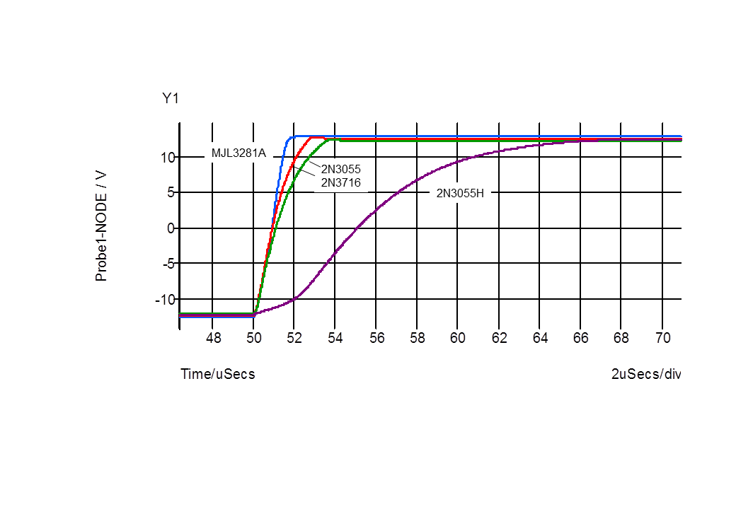

Your simulations raise the question of what models you are using. I don't know if there were ever any SPICE models generated for the original (RCA) 2N3055 (these predated SPICE) from the manufacturer. I had to build my own. In which case a modern 2N3055 (epi base) would be very similar to the older TI transistors, and would not be represented by models for the old 3055.
Some time ago I posted this comparison (or a similar one) (buried in the JLH 10W thread somewhere, I think, a few years back) of output transistors. This shows a risetime for an old 2N3055H, a new 2N3055 which is similar to the 2N3716 and the MJL3281A outputs. Your comment about the driver Cjc is interesting, but one of my investigations into the JLH led me to conclude that the new high speed devices would be better.
I am surprised that you think the 2N1711 would be better than the BD139. The RCA datasheet shows Cjc(max) of 25pF (at 10V) compared with 25pF (from the BD135 model) which will be quoted at 0V.

The particularity of 2n3055 that it has a Fhfe that I have seen on RCA datasheet and can be seen also on Siemens one, to be >10khz only . The model I am using positions it at 20khz ,you can see it on the output impedance curve . As the co-pilot is driven by current , the 20khz limit is the active one not the Ft.
