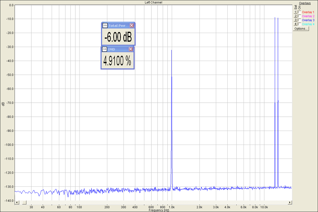

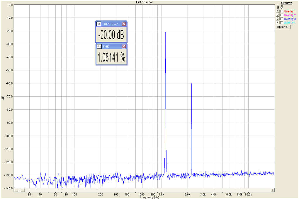

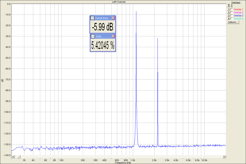

One of the files is distorted, in this way. The corresponding distortion is H2, 10% at full scale.The other file has no distortion added.

In this case, the nonlinear distortion through ax2 + bx + c transfer function is added. Frequency independent. Level dependent, of course, as per the formula. This is pure 2nd harmonic distortion, in isolation, without other influence.

Surely it is pure 2nd order distortion, which will have equal amounts of 2nd harmonic and 2nd order intermodulation? This is what your plots (post 24) seem to show.
