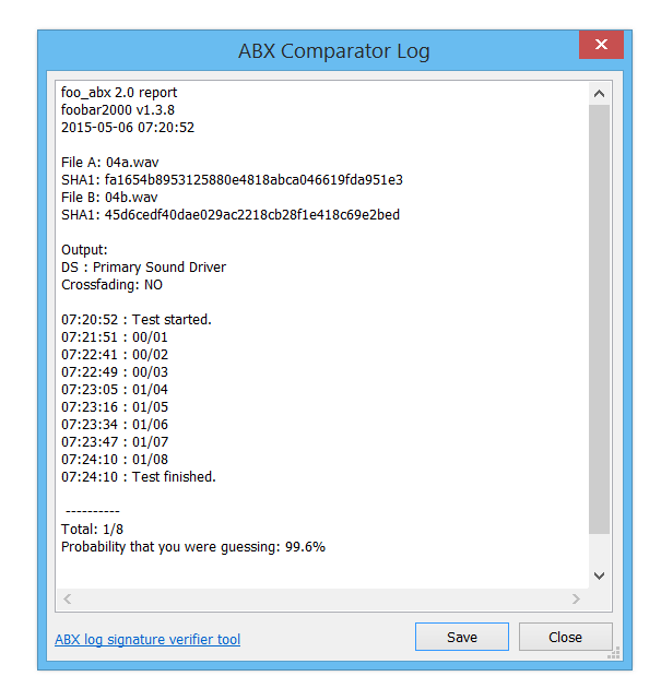

Very interesting. I thought flute would make it easier, but it doesn't. I don't get statistically relevant scores on Foobar, so not possible to express a preference. Weird. I was convinced with the other test that I heard a difference. Will try that one again.

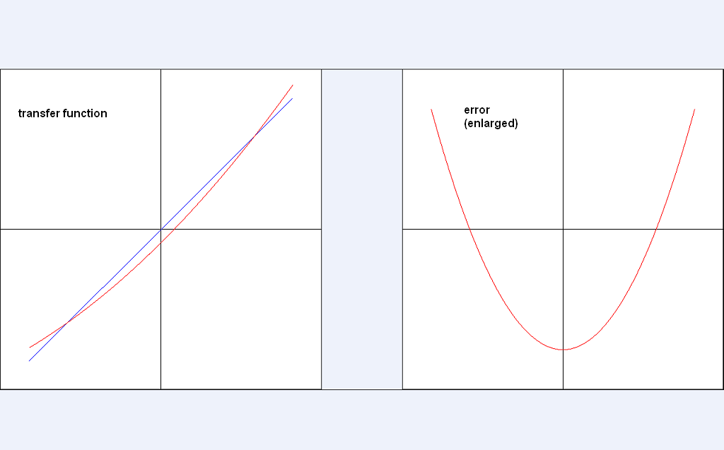

Jakob, I used both earphones (Stax) and my own small speakers. I haven't measured the Stax, but the speakers are under 1 % over most of their bandwith. However, we don't know the sign of this distortion and that of the distortion added by Pavel to the music clip. It may well be that the distortion of my speakers and the distortion added by Pavel combine destructively. The interesting question you raise is of course: how much of the added distortion actually makes it through the audio chain? If a distorted test tone was made available, I'd be most happy to measure what happens in my particular situation.

I have the same test at our local forum. The results are similar as here, but, if someone has achieved any valuable result with foobar ABX, it was with large, matured speakers. However, I asked for only subjective preferences, so the answers here are fine for me.
