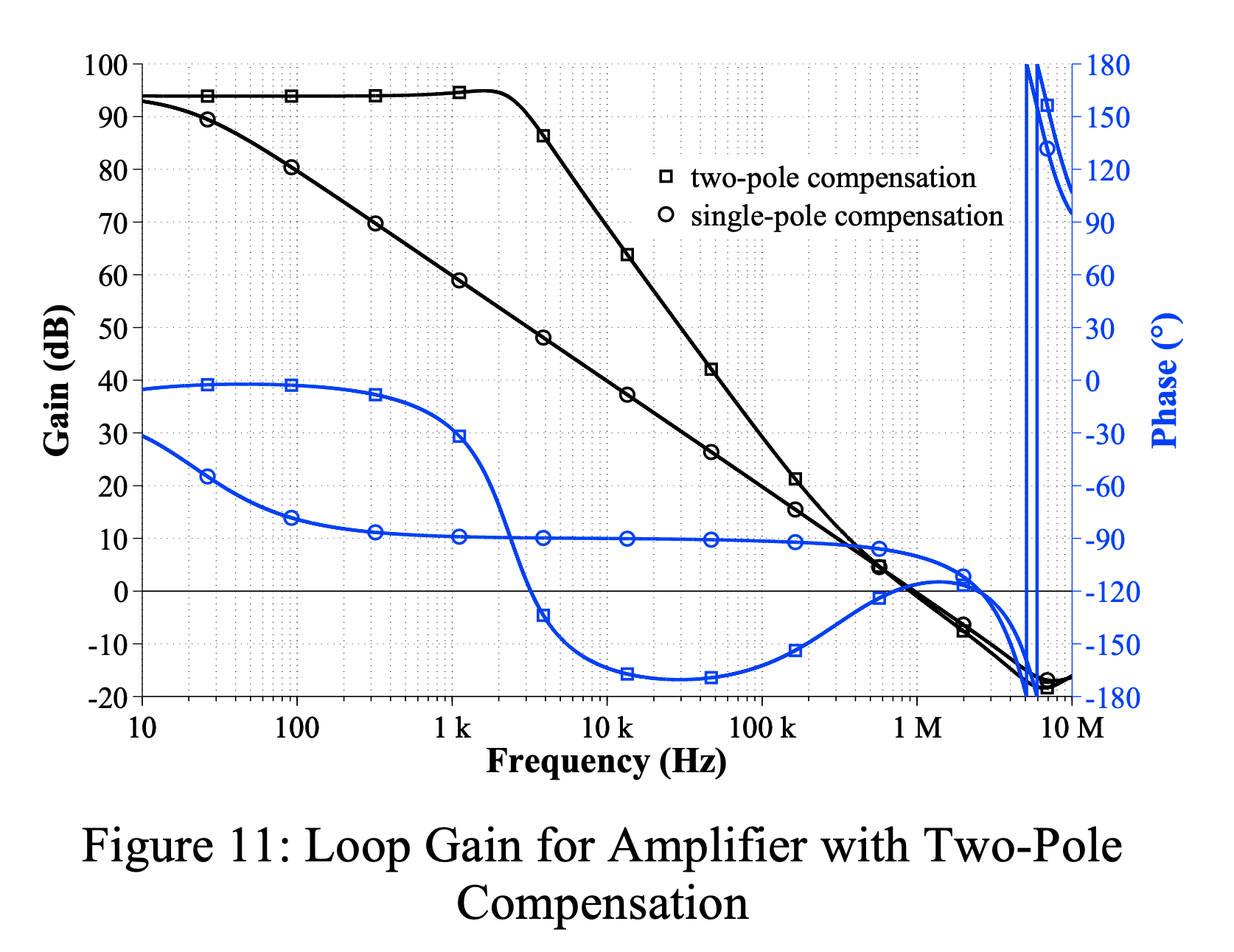

The small-signal loop gain/phase are fine. Phase dips below ten degrees at midband, typical of TPC. When it clips, all that goes out the window.
This is the best paper I've seen on the subject, but at 75 pages, it's a slog and I haven't tried to digest it yet.
https://www.electronicsworld.co.uk/wp-content/uploads/2020/04/amps.pdf

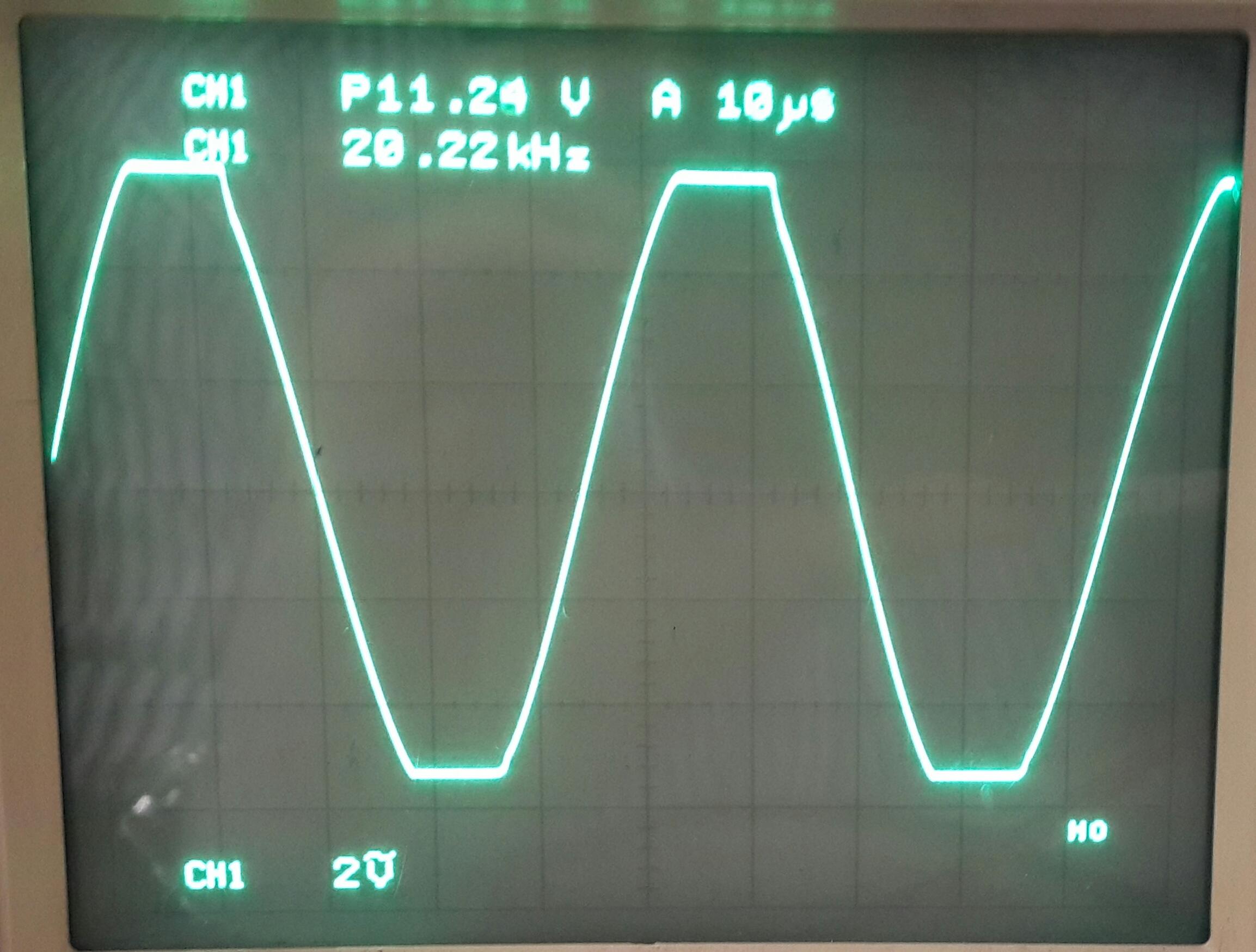

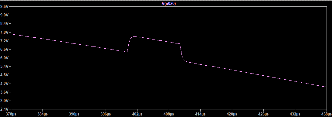

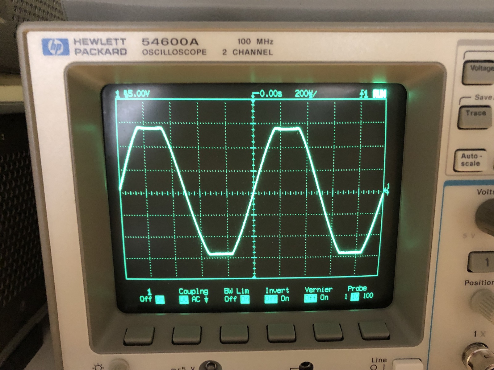

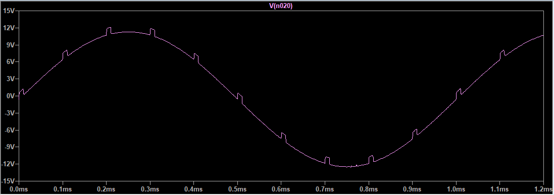

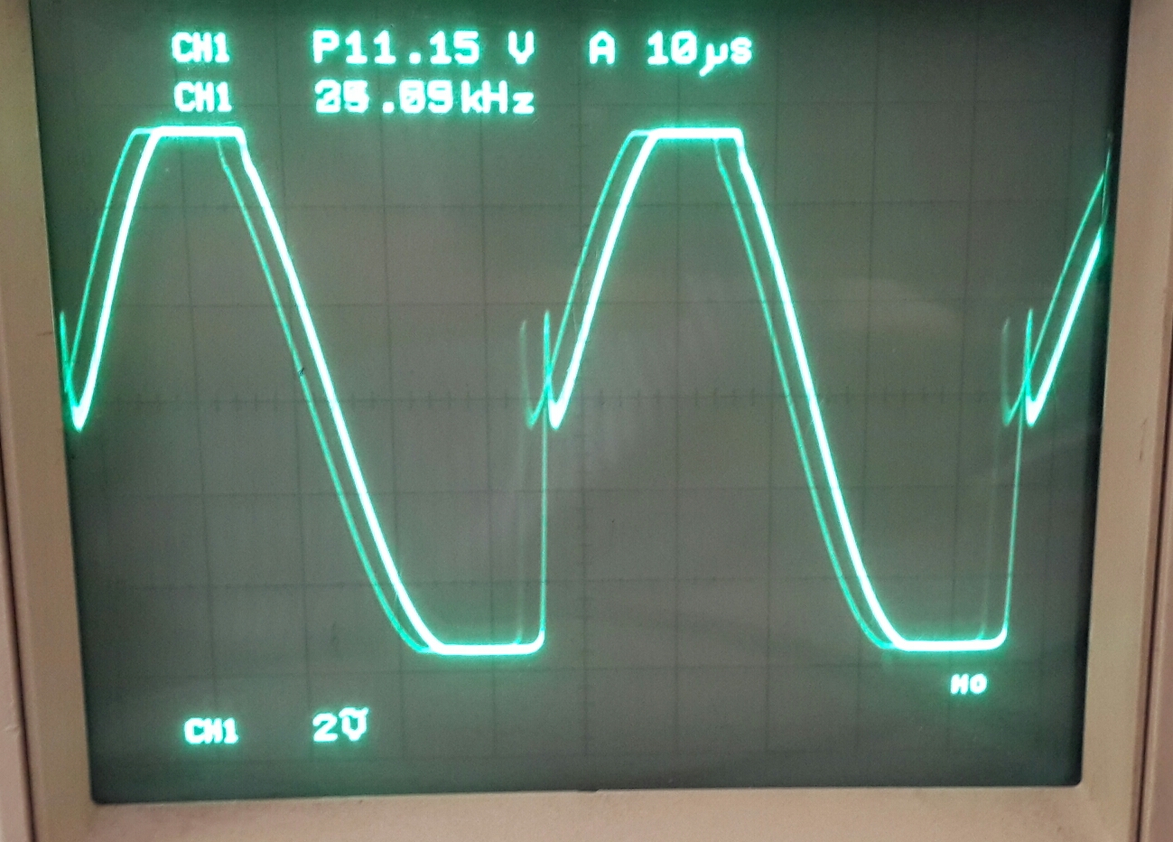

I had circuit with npn ef VAS that had same clipping issues, just other polarity of course.
Here is a scope grab before and after adding a single BAV21. (111Vp-p (x10 probe))

That's not bad for 20 kHz! I assume that was a Lin (aka blameless) topology with the current source load on the negative rail?

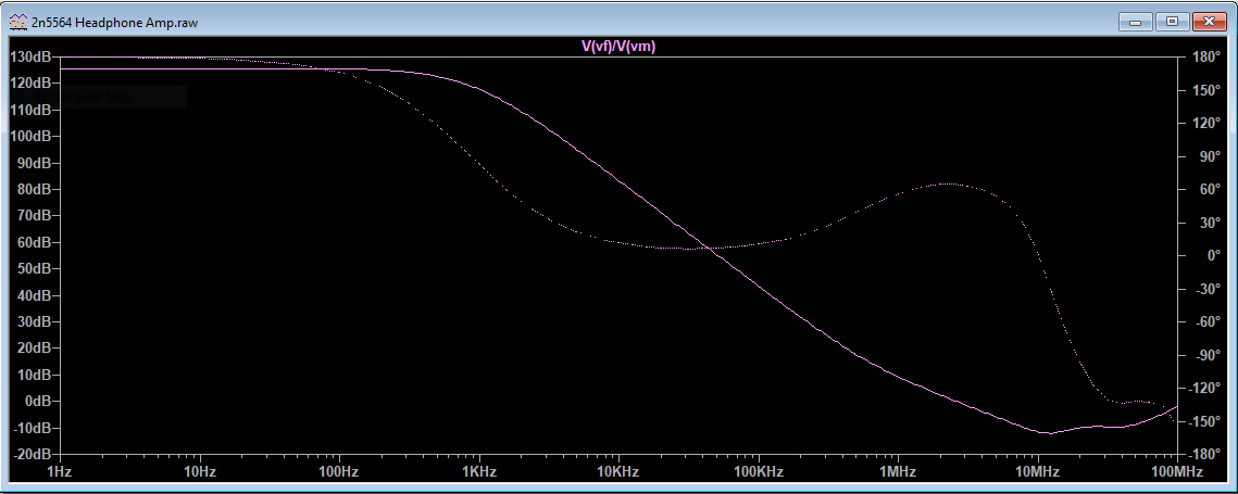

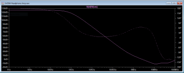

Why don’t you put a loop gain/phase plot up.

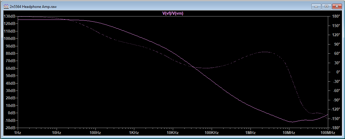

Simulated Bode plots with and without the clamp. The effect of diode capacitance is evident.
Clipping was perfect with the clamps in place, but at what cost to sound quality?
You have c. 70 dB feedback at 20 kHz with the clamps (which is high) and c. 80 dB without the clamps (a bit higher). As I mentioned a few posts back, in a practical amp you have higher parasitic capacitances around the board than the diode capacitance so what the loop gain plot actually looks like in practice without actually measuring it is anyone's guess. The main thing is to close it at a decently low frequency and ensure you have plenty of gain and phase margin which you have done. The difference between 70 dB feedback at 20 kHz and 80 dB will not effect sound quality.

You have c. 70 dB feedback at 20 kHz with the clamps (which is high) and c. 80 dB without the clamps. As I mentioned a few posts back, in a practical amp you have higher parasitic capacitances around the board than the diode capacitance.
You've closed the loop at about 2-3 MHz which for the type of circuit you have is ok (A bit high for a full power amp, but this is a headphone amp).

Thanks for the analysis. All bets are off without measurements, as you suggest. I don't remember if I said this here or elsewhere, but I was thinking seriously about buying a QuantAsylum analyzer. This is still a possibility, but they're out of stock indefinitely at the moment thanks to the ongoing parts crunch. I need to think about whether I want to spend the money on a lab-grade capture box.
Above all, I was simply amazed these circuits were stable at all. When I was in college, with paper-and-pencil analysis, I tried building a no-holds barred amplifier and never managed to tame it. This was back in the days when we made resistors by charring silk thread in an oven, and cars had cranks on the front.
HPA1 was also my first try with TPC. Up until recently, I didn't understand TPC very well and was skeptical of it. It works, so SPICE must be worth something.
I used the technique of inserting an AC probe in the feedback loop to generate these Bode plots. The rising response above 10MHz bothered me so I tried simulating the end-to-end open-loop response the usual way without the probe and didn't see the increasing response. On further analysis, I concluded that signal coupling across the input devices, from the non-inverting input and back out of the inverting terminal, is responsible for the HF rise in the plots here. You can see it if you plot the transfer function across the feedback network, which does not act like a constant voltage divider when connected to the inverting input. I'm not sure this is actually relevant to the stability analysis, but it's a nuisance. Dymond and Mellor's TPC paper shows a similar feature in their Bode plot. I can't find any other explanation for the rising response, so I just ignore it.
The diamond buffer has an RF peak around 10 MHz. In HPA2, I added a lag compensation network at the input to the buffer that improves the gain margin before the rise starts up again. HPA1 does not have this network. The tuning is probably hit-or-miss given the frequency and the real-world variables involved.

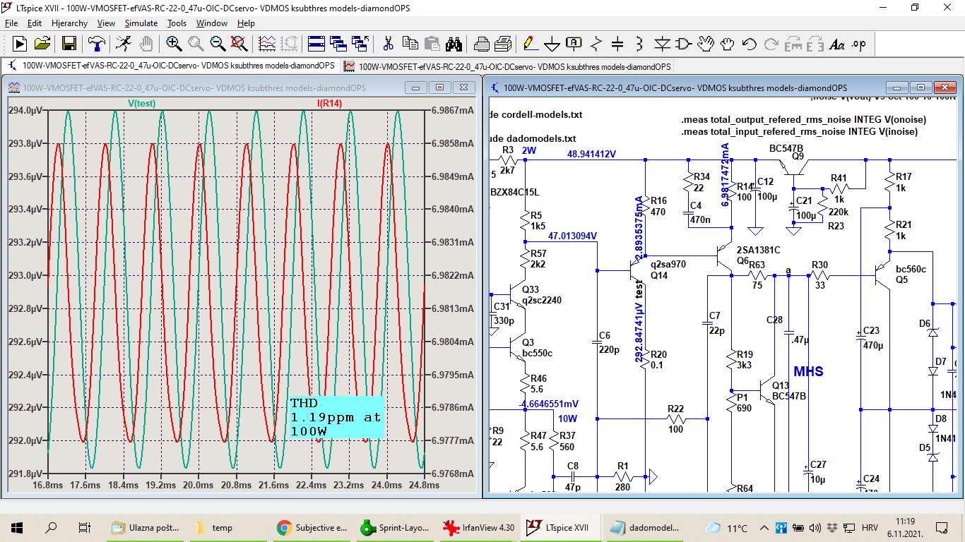

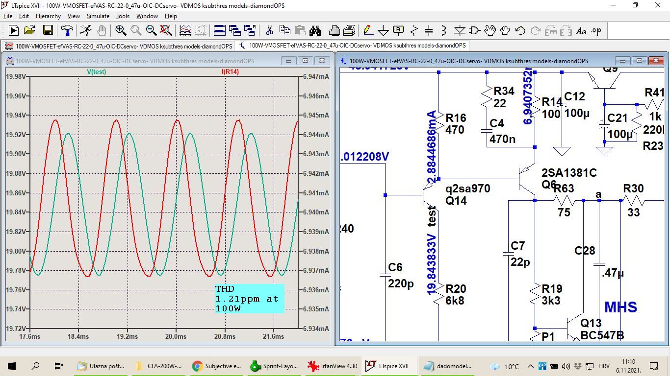

I simulated VAS baffer collector resistor influence on distortion with two amp types, CFA and VFA with different VAS emitter resistor values 100R and 16R.
CFA result, full output swing 80 Vpp, with collector resistor of 6k8 simulated THD is 1.21 ppm and collector voltage swing is 0.17 Vpp.
Even with quite low Early voltage of 57 for used transistor (2SA970, Vaf=57) there is just small THD increase of 1.6% (with no collector resistor THD is 1.19 ppm).
VAS emitter resistor was set to 100R
Regarding SR, there is drop from 270 V/usec to 237 V/usec.

My opinion is that there is much more benefit using that overload protection resistor than harm. Some years ago I built some Self blameless amps (Self never used that resistor) and had a problem of burning VAS and helper transistor. After introducing that resistor it never happened again.

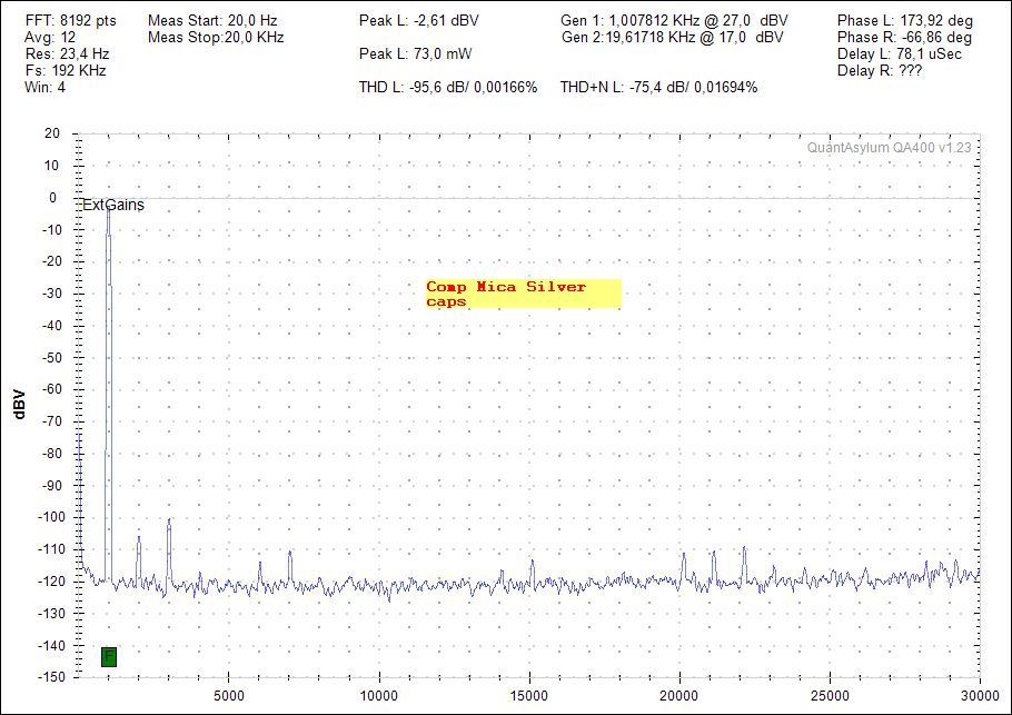

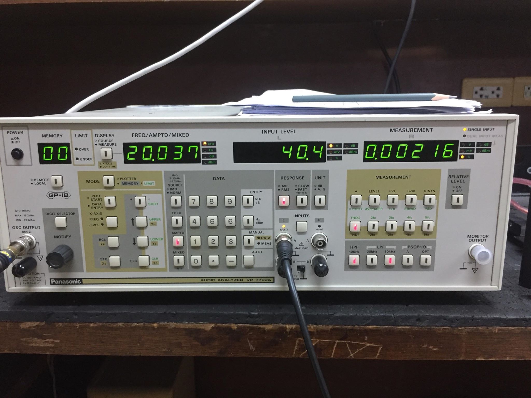

Attached some simulation plots and some real measurements on my CFA amps, all with that protection resistor in.

Here I showed some real measurement, not so good as simulated but still very good.
