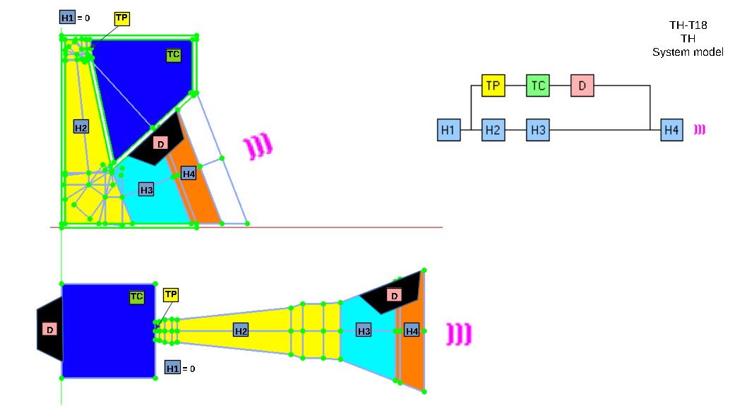

hello everyone, I inherited from an old place two hybrid bass cabinets, cube type, without woofer, and I would like to understand which cones to mount.
I would like to simulate them, I downloaded horn resp and I really don't know where to start, please help me!
the measurements above are external including the 18mm wood, the ones below are internal measurements.. the cone magnet is outward
thanks!

You can check the tutorial section where videos are organized in a sequence.
https://freeloudspeakerplan.rf.gd/pages/tutorial.htm
Basically, you need to open the sketch and modify the quote where the color are RED (Tutorial How2use 2 and 3), use dimensions to make the model close to the dimensions from your model. Once quotes are updated, the model will adjust automatically and generate new inputdata for you, so open the spread sheet and copy data to hornresp (Tutoal Automation level 1)
