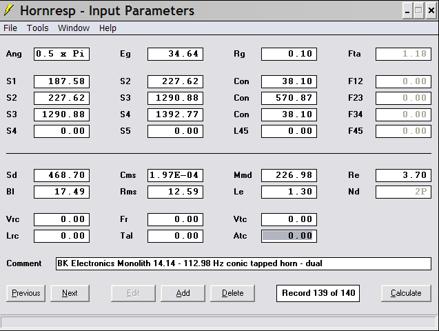

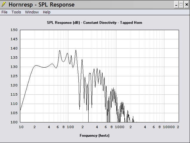

Greets!
Check out the big tapped horn thread: http://www.diyaudio.com/forums/showthread.php?s=&threadid=97674
Anyway, with this driver it's not small by most folk's standards and of course with two it's somewhat larger, though not the 2x it would ideally be if sealed or ported:
14.14 - 112.98 Hz conic TH = 329.104 L net
14.14 - 112.98 Hz conic TH - dual = 451.112 L net
Compared to my mid '50s dual 15" ~566 L EBS 'subs' that peak out at ~109 dB/16 Hz corner loaded, the dual driver one is by far the size/performance winner, with so much dynamic headroom you can EQ it flat to ~12 Hz if corner loaded and still do DD/DTS reference with enough dynamic headroom above ~25 Hz to boost EQ as much 'slam' into it as you can stand if you want to assuming a suitable amp capable of driving them to Xmax. Short of downsizing, this could be the last sub you'll ever need. 😉
GM

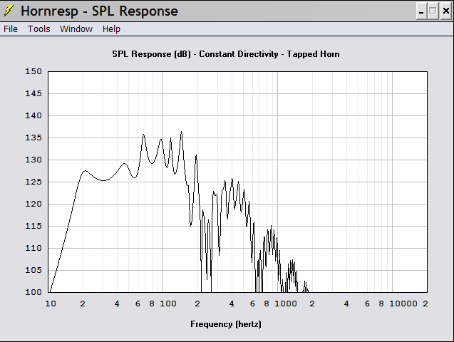

Greets!
You're welcome!
On average you'll lose 3 dB of efficiency and 3 dB of sensitivity and the response isn't as flat due to the too small net Vb for the BW.
GM
