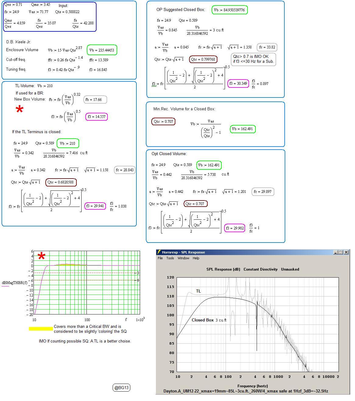

1. DAYTON UM12-22, VB = 160.0 L, FB = 20.0 Hz
Port size (2x ports)
Diam. 4"
Length 64.2cm = 25 9⁄32in
Air speed (2 speakers/3m@Xmax):
a) 16.4m/s - 100 dB,
b) 34.2m/s - 106.8dB (@max. output)

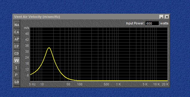

now i am a bit worried,,here is the graph from bass box,,,it does show port velocity up near 36 m/s down below 20 hertz. What should i do? is this ok? I have started building but haven't gotten to the port,,,,can I "90" a slotted port?
here is the graph.
here is the graph.
You're definitely going to have audible chuffing during a 20 or 25 hz test tone at medium to high output, and port compression limiting sensitivity in the low bass. Flares will help. You can increase the size of the port, but you will lose box volume if you have already sized the outer panels. Or you can just not worry about it, it will probably be OK-ish.

I do intend to "round over" the port both coming out of the box as well as the 3 sides internally.
Just go with what you have if it is too late to change, but I would rough it out and test it before finishing just to make sure you're happy with the performance.

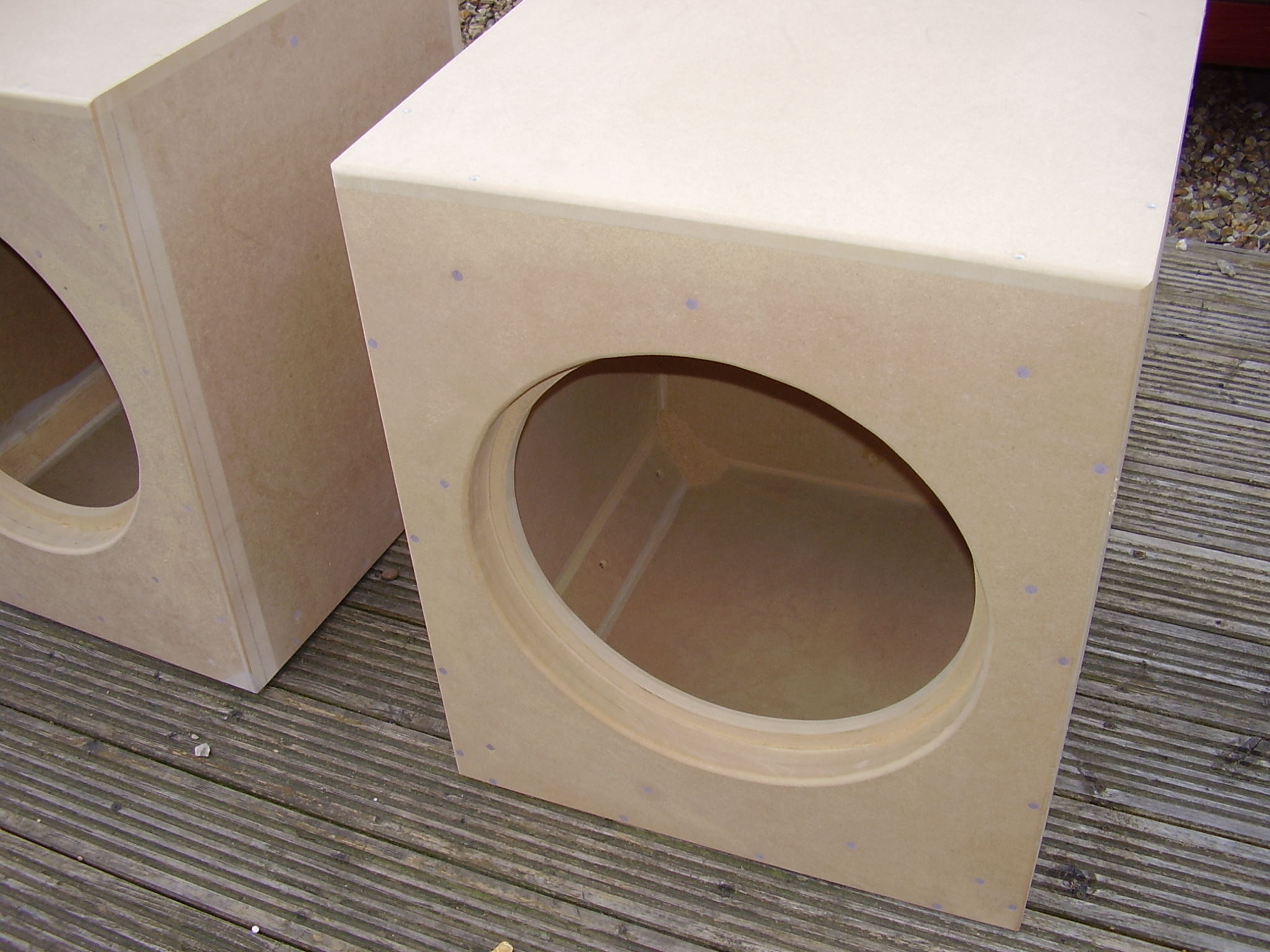

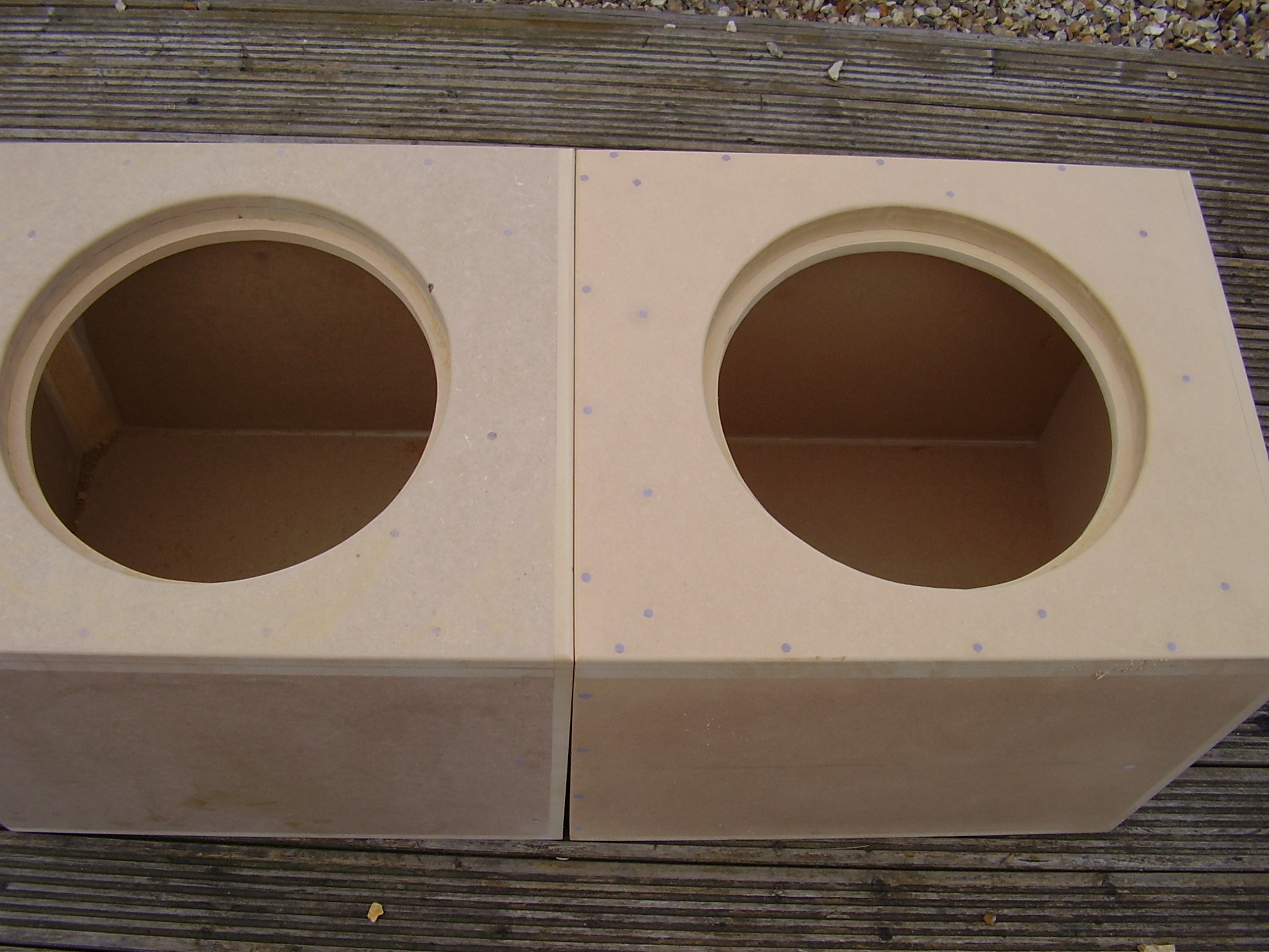

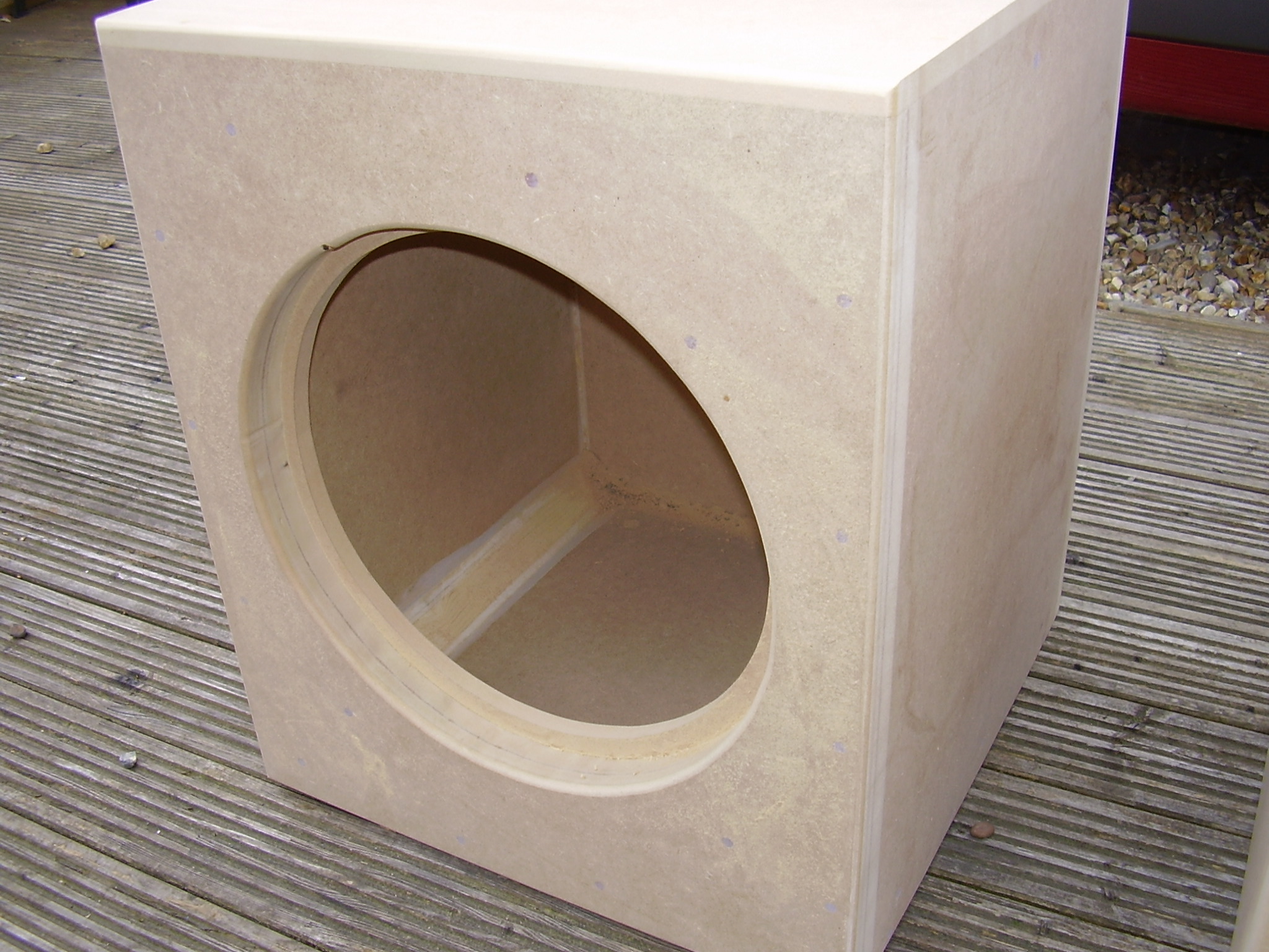

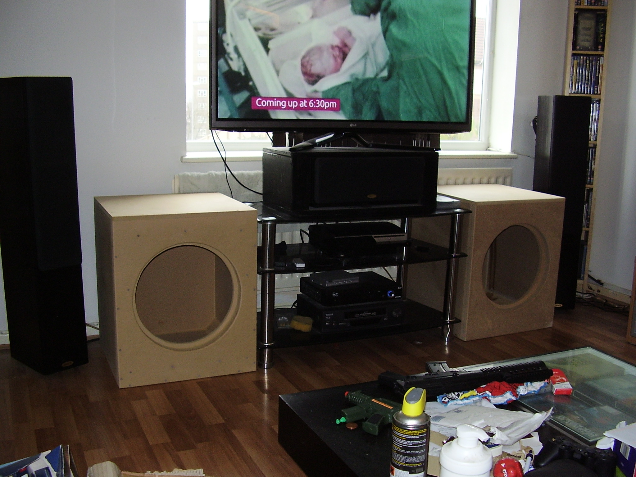

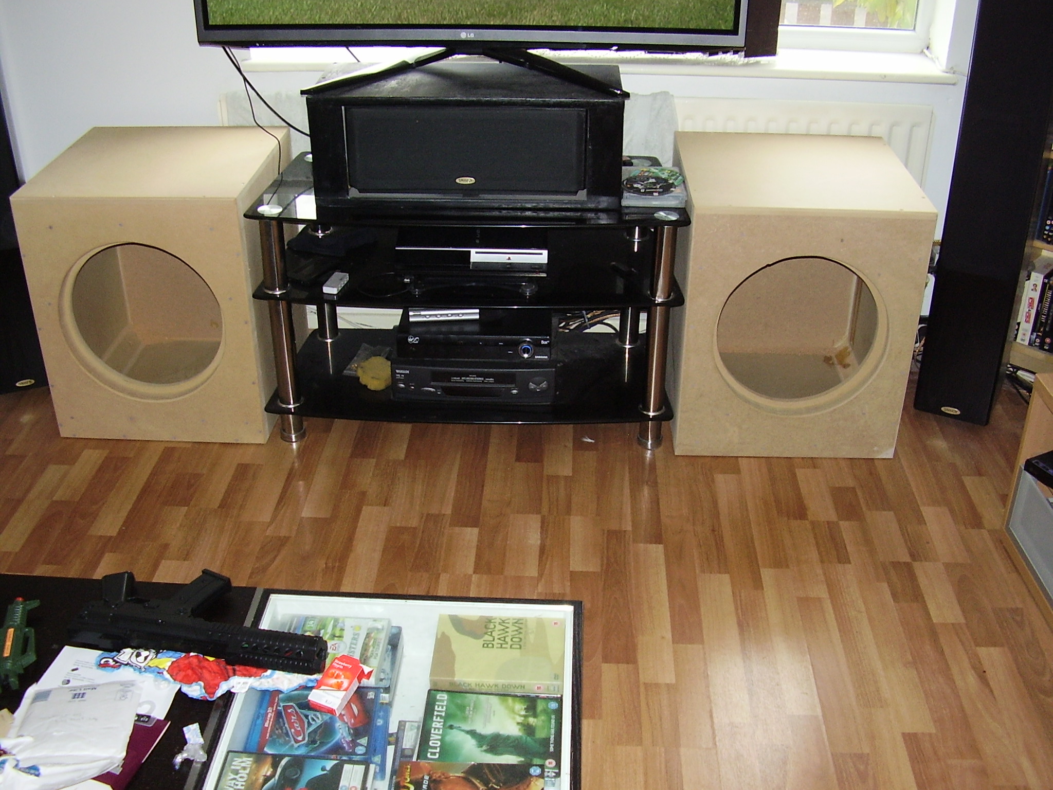

This is more or less what i am building atm but with quite cheap drivers witch are the audiobahn aw1500v's ......if your were to use the dayton 15" drivers or better you will be blown away with what you hear!!
i mean 10hz at over 90db aint to shabby and a 108db at 20hz aint to be scoft at either plus you don'r have to work at NASA to do a great job.....a few pic of my progress 🙄🙂
P.S YOU GUYS OVER IN THE US ARE SO LUCKY AS YOU GOT ALL THE BEST DRIVERS.....WE GOT NOTHING IN THE UK!!.........SO IT COSTS ££££££££££££££'S
Looks good mojo,,,Down he road I would like to start looking into toying with "pro" external amps,,,The beringer would have put me near my budget alone. someday though.
