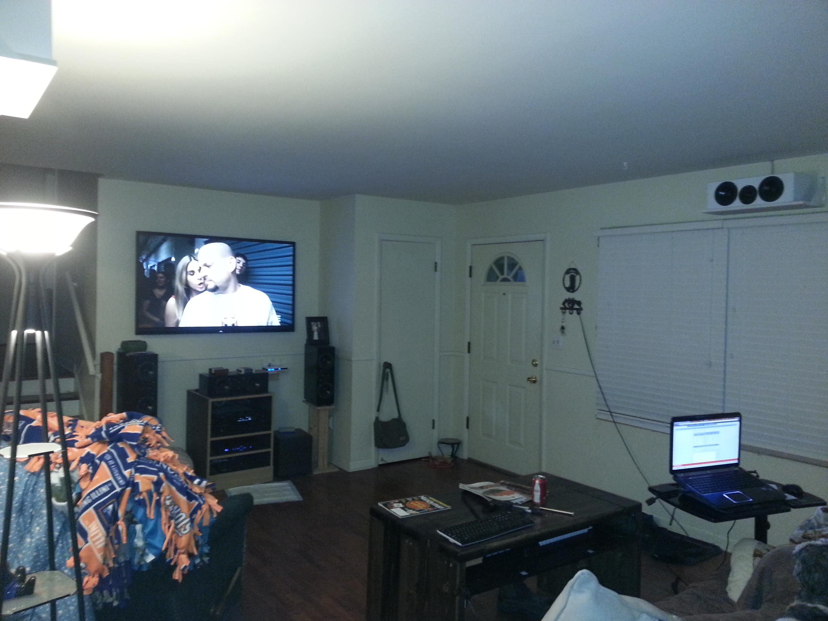

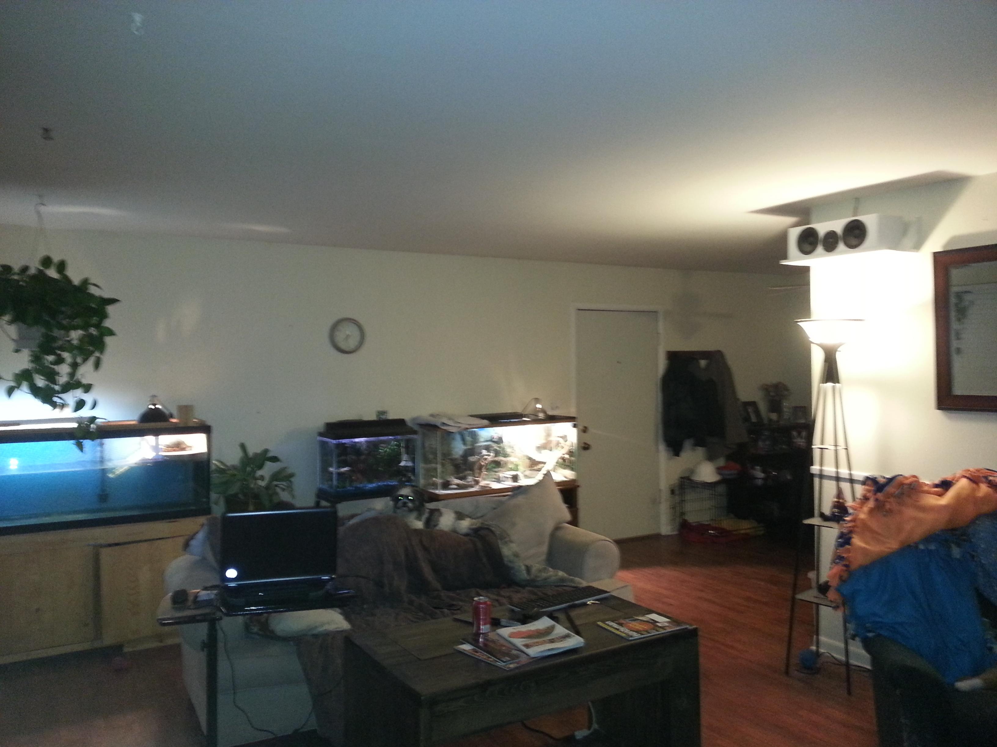

No size restrictions,,, i do have the spot up front where I would like to put it, but 20" would be the max width there, so if I had to build "up" maybe. My wife is cool with me putting it where it sounds best,,,, i would prefer to design/build a box that best suits the driver/amp and listening needs and then if I have to re arrange the living room around the sub,, so be it. I'm looking at the ultimax 12" and the bash 500.

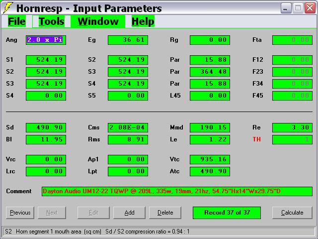

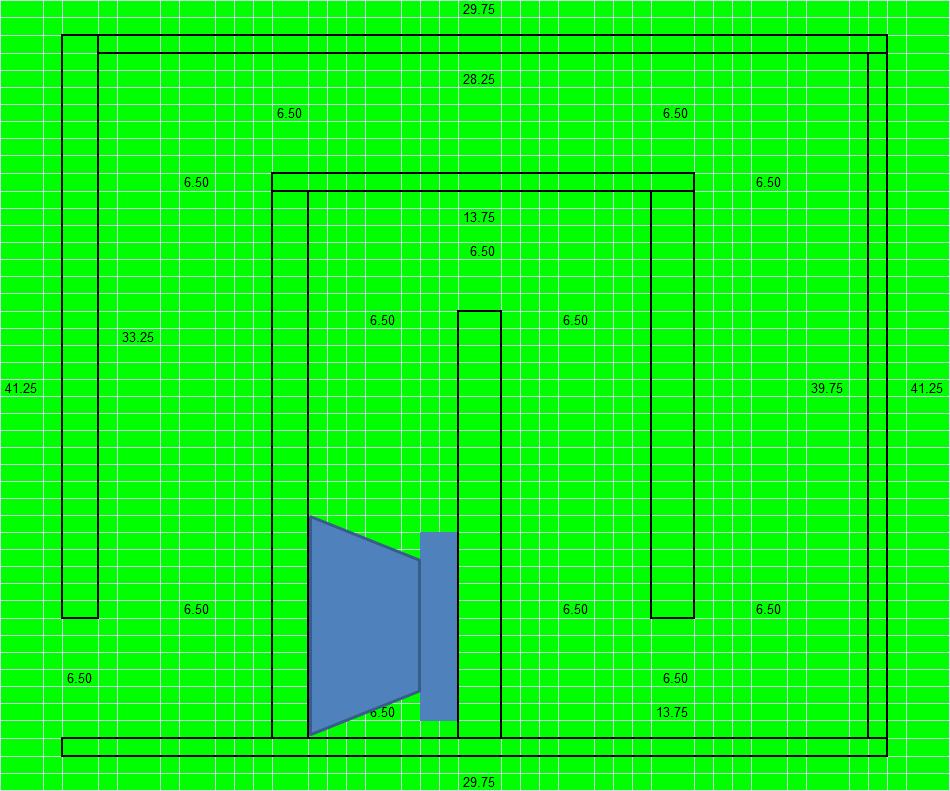

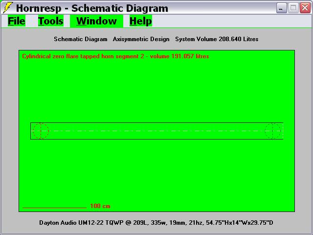

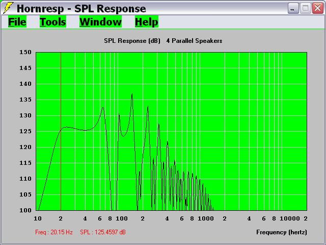

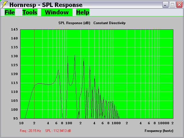

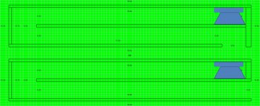

FYI:An alternative moving f-3dB more than 10 Hz down if compared to a closed:
b:)

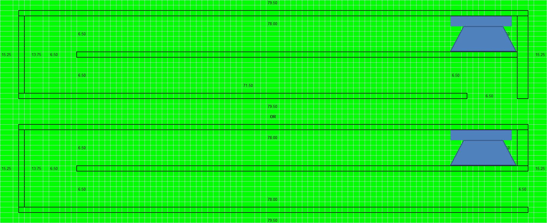

My mistake. I listed tri-fold dimensions instead of double fold. The enclosure is 41.25" H x 14" W x 29.75" D.
This looks interesting to me,,,,,,,before I got the recent responses I had been trying to figure out just a vented enclosure with a slotted port. I am completely ready for the challenge of build a box such as this double fold. the single fold's long dimension would be hard to place anywhere in my living room. so now,,although I love the additional options,,I am still left with the "what to do" issue. I am confident in my building skills. Being an amateur,,I am unsure about how to weigh the options,,I have the amateur hope of building a sub that "sounds/performs" well for what I use it for,,,but unfortunately, don't yet have have the knowledge/understanding yet of being able to specifically describe the details of what that means in technical terms.(if that makes any sense),,which also makes my decision making in the matter frustrating. .

Certainly the two proposed builds are a little bigger than a simple sealed enclosure. And if that's an issue than sealed would probably be your best bet. However they aren't all that complex to build, no angles or crazy joints. It can still be simply glued and screwed together. They certainly would out perform the sealed sub by quite a bit, and they've already been designed for you....
