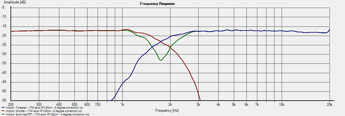

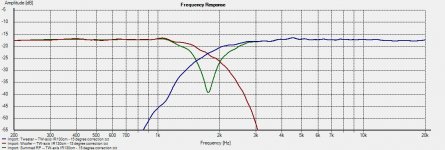

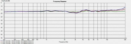

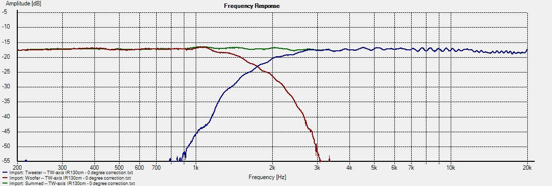

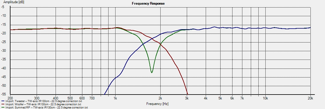

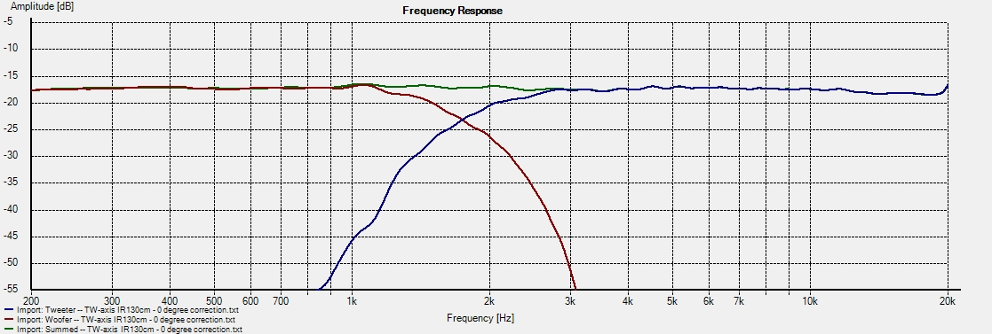

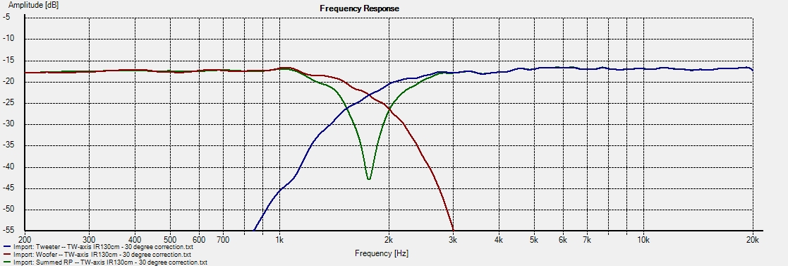

Measurement verification:
I have done four different correction filters based on 0, 15, 22.5 and 30 degrees off-axis measurements.
Each correction filter is measured at an angle of 0, 15, 22.5, 30, 45 and 60 degrees. Both woofer and tweeter are measured individually as well as the summed driver response plus a measurement with the tweeter connected in reverse polarity. This gives a total of 96 measurements for each loudspeaker…….
First of all I’ll show how a 0 degrees correction filter looks like on-axis, 0 degrees (Picture 1). The small ripples higher up in frequency are due to artefacts from microphone grip reflections (Loudspeaker Measurements). (Picture 2) shows the same measurement, but with a 1/12 octave smoothing. All subsequent measurements will be shown with a 1/12 octave smoothing. (Picture 3) shows the tweeter connected with reverse polarity.
Note 1, almost ruler flat 😀, but there is one strange thing……. Remember, all the correction filters I’ve done used a 2000Hz cross-over frequency! The actual cross-over frequency is 1750Hz and this is the case through out all verification measurements….hmmm. I wonder why?

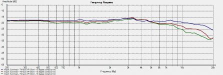

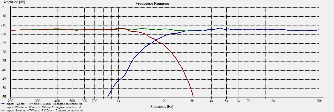

Picture 4: 15 degrees correction filter, 15 degrees off-axis.
Picture 5: 15 degrees correction filter, 15 degrees off-axis and tweeter reverse polarity.

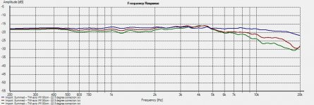

Picture 6: 22.5 degrees correction filter, 22.5 degrees off-axis.
Picture 7: 22.5 degrees correction filter, 22.5 degrees off-axis and tweeter reverse polarity.
Picture 8: 30 degrees correction filter, 30 degrees off-axis.
Picture 9: 30 degrees correction filter, 30 degrees off-axis and tweeter reverse polarity.
Note 2, Ok, what does all this mean? Yes, you get ruler flat responses for the measurement angles you have made a correction filter for. If you toe-in your speakers to aim directly at you, you get a ruler flat from the 0 degrees correction filter. If you don’t toe-in your speakers, you get ruler flat responses from the 15-30 degrees correction filter, depending on the angle to the listening position.
Is this the whole truth? No, unfortunately not…... We also need to handle baffle diffraction and how a specific correction filter behaves off-axis and the power response.
Next, measurements and off-axis responses……

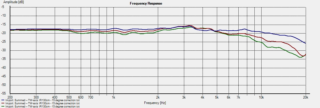

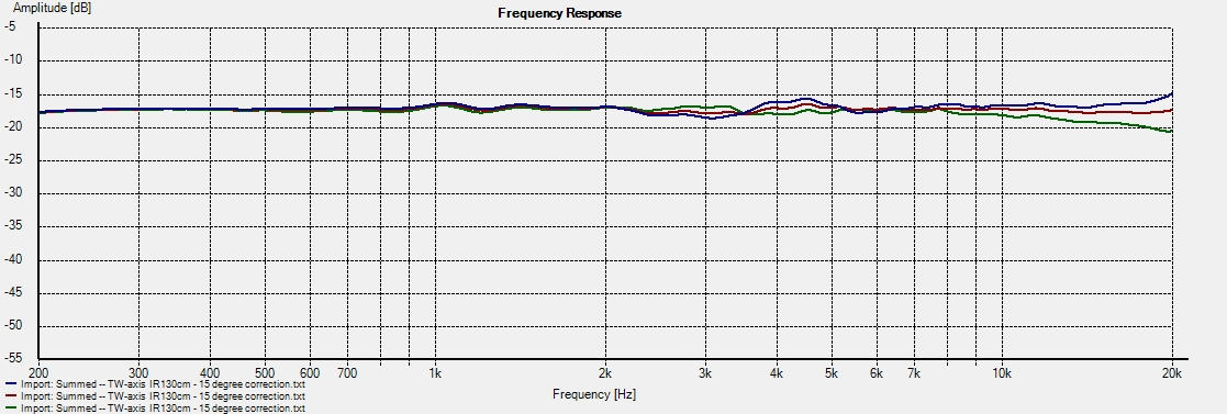

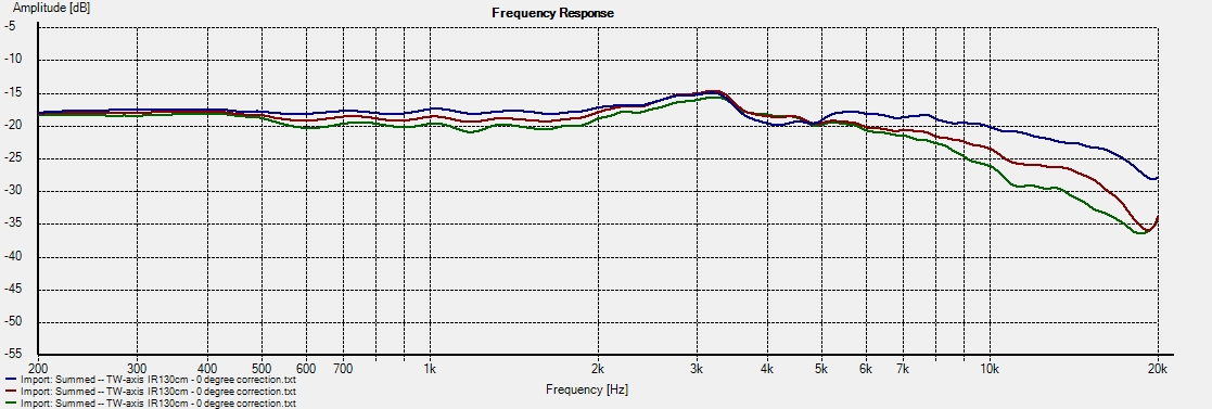

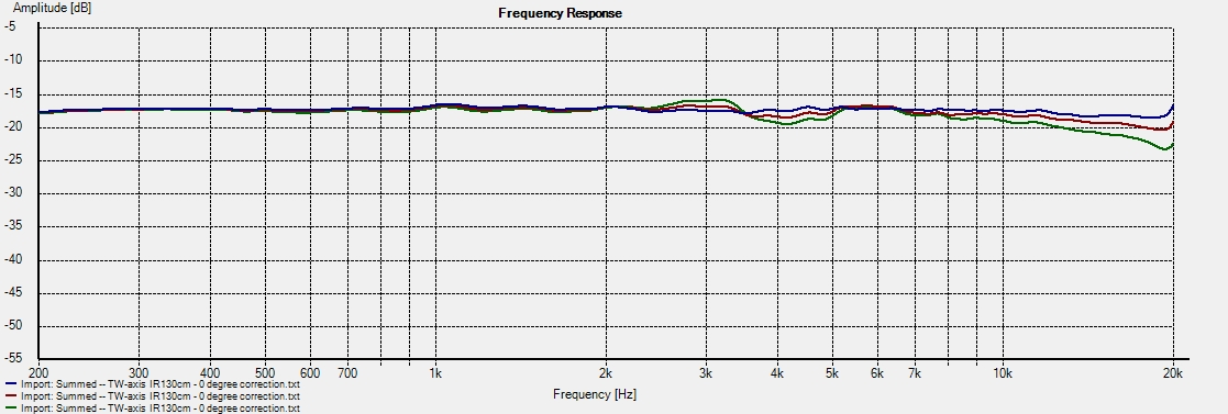

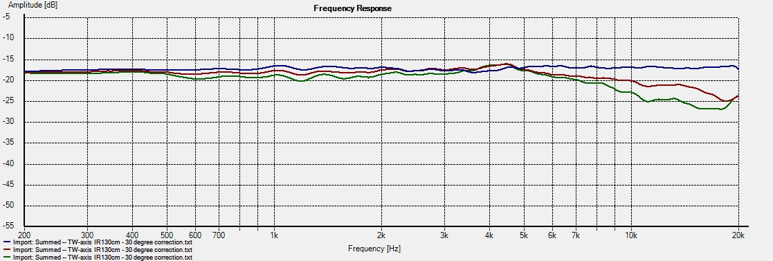

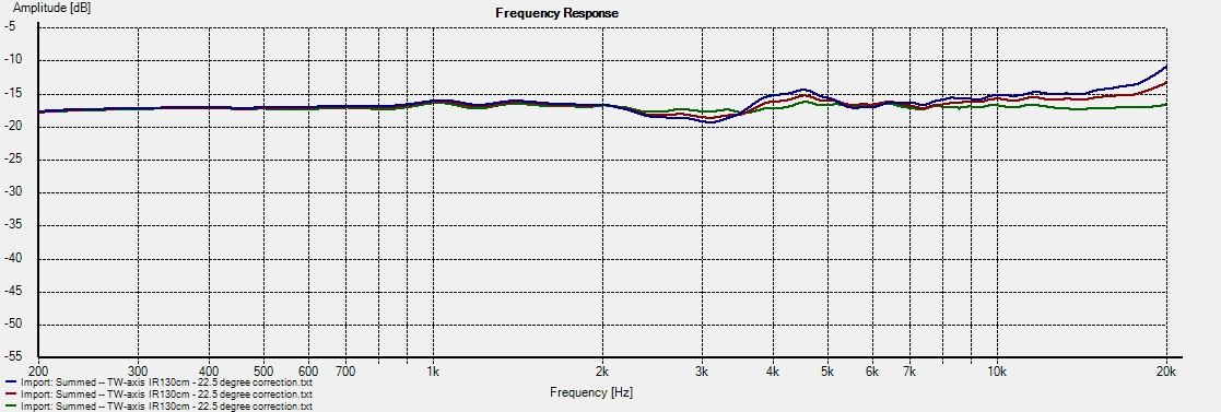

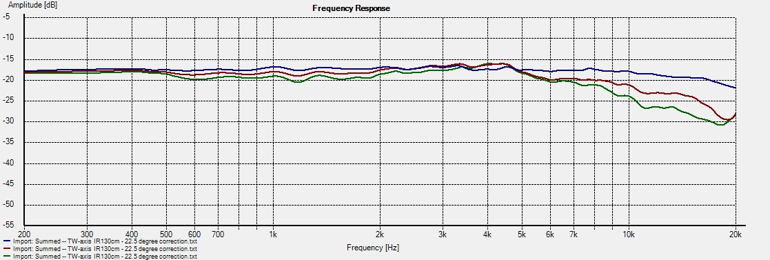

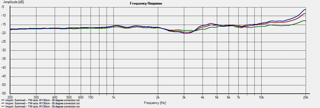

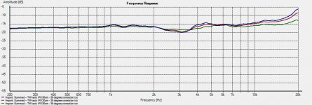

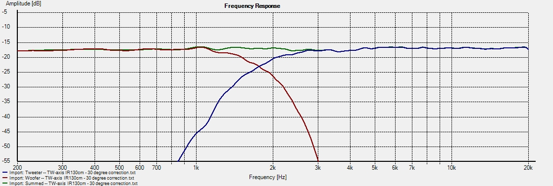

Measurements and off-axis responses:
As I mention earlier in this thread, I made four different (0, 15, 22.5 and 30 degrees) correction filters. Each of them have a ruler flat response when measured at the same angle as the correction filter, but what happens with the frequency response when measured off-axis?
The baffle step and the baffle diffraction have to be taken into account in the design of the loudspeaker.
The baffle step is quite easy to handle in the DEQX. You simply adjust the amount of the baffle step compensation by adjust the lower limit of the correction filter. In this case, 250Hz for a full baffle step compensation and e.g. 500Hz for a half baffle compensation or somewhere in between according to personal taste.
The baffle diffraction is the major issue in this design. The baffle diffraction effect can be reduced by arrange the drivers optimally on the baffle, by enclosure shape and design, but never completely eliminated. Different drivers are also more or less sensitive to diffraction.
The following described measurements make this baffle diffraction and its effects more clear.
0 degrees correction filter:
Picture1: Blue = 0 degrees, Red = 15 degrees, Green = 22.5 degrees
Picture2: Blue = 30 degrees, Red = 45 degrees, Green = 60 degrees
Note: Looks nice in the 0 degrees angle, but the correction filter overcompensates (2500-3500Hz) in the off-axis frequency response.
15 degrees correction filter:
Picture3: Blue = 0 degrees, Red = 15 degrees, Green = 22.5 degrees
Picture4: Blue = 30 degrees, Red = 45 degrees, Green = 60 degrees
Note: Looks a bit better and the correction filter doesn’t overcompensate as much in the off-axis frequency response.
22.5 degrees correction filter:
Picture5: Blue = 0 degrees, Red = 15 degrees, Green = 22.5 degrees
Picture6: Blue = 30 degrees, Red = 45 degrees, Green = 60 degrees
Note: Here the correction filter overcompensates a bit higher up in the frequency response (4000-5000Hz).
30 degrees correction filter:
Picture7: Blue = 0 degrees, Red = 15 degrees, Green = 22.5 degrees
Picture8: Blue = 30 degrees, Red = 45 degrees, Green = 60 degrees
Note: Here the correction filter makes a dip in the frequency response (2500-3500Hz) and with a slight rising response higher up in the frequency.
I listened to each of the four correction filters for a couple of day before I made these measurements to see which correction filter I found sounds the best. In the listening test the speakers had the same setup with no toe-in and a listening angle of approximately 15-22.5 degrees.
Subjectively I found the 15 or the 22.5 degrees correction filter to sound the best and the 0 degrees correction filter to sound the worst. By looking at the off-axis responses I can see why. None of the correction filters did sound bad, but they all had a different sonic character.
The DEQX unit have other features, e.g. a digital EQ that I haven’t used in this test and which can be used to tailor the frequency response and sound further.
Now when I have a deeper knowledge of how these specific driver units in this specific enclosure behave, I can redo the measurement with my recently bought “reference” microphone and tailor the sound with the EQ function and then redo my test measurements to verify the design.
I will be back with a final design, stay tuned….
