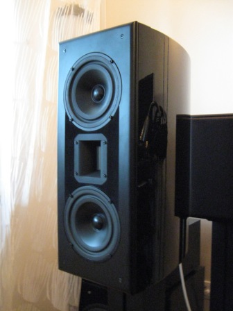

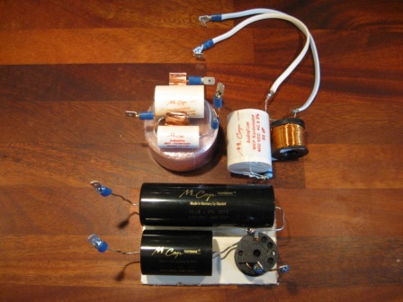

I recently finished a high sensitivity (91,5db) D’Appolito design that I use with my Prima Luna tube amp, se pictures:
It uses the Fountek NeoCD3.5H ribbon tweeter and two OEM made SEAS woofers in a 28 liters PE enclosure. It´s tuned to 40Hz and the cross-over point is 2900Hz using LR 24db/oct acoustical cross-over slopes.
The sound is just incredible with a huge soundstage and depth with an open airy sound. The Fountek ribbon is fantastic when used properly within its comfort range. 2900Hz is as low as it can go without distortion becomes an issue. Luckily 2900Hz is about the upper limitation of the woofers as well, a close match. 😉
If there is any interest I might share more details on the build in a separate thread.

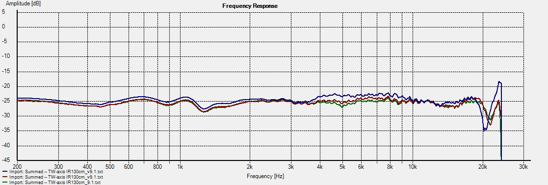

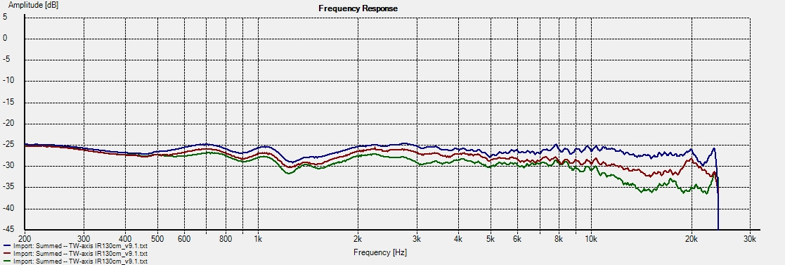

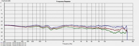

I have one question, because off-axis looks a little bit optimistic: how do you measured? Do you rotate speaker, or the microphone? I ask you this, because in my current design, using Monacor dt300 and wg 300 (yes, waveguide), diffraction plays an importante role, if i measure corectly, rotating speakers. I have 230 x 400mm baffle, the centre of waveguide centered horiz, and 95mm from top, with 6mm radius.
Also, i like more resolution in holm, say 50db scale instead of 80 used in your graphs.
Hi ionutgaga,
I rotate the speaker on a special made turn-table jig. The microphone is always fixed in the same location when the speaker is rotated and measured.
Yes, I can do that. Personally I use both 50 and 80db scale, mostly without smoothing, while working with the design.
Don't know what you mean by optimistic, but these are real measurements using the above method (se pictures)
Picture1: TW-axis, 1m, 50db scale, no smoothing - Blue=0 degrees, Red=15 degrees, Green=22,5 degrees
Picture2: TW-axis, 1m, 50db scale, no smoothing - Blue=30 degrees, Red=45 degrees, Green=60 degrees
The off-axis response wouldn't bee as good if it wasn't for the DXT-lens in combination with the cross-over. The speaker is optimized for an listening angle between 15-30 degrees off-axis. It's a bit hot in the lower treble and higher mids in the 0 degree position, as can be seen in the picture.
/Goran
