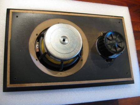

Gornir,
I'm at a somewhat similar stage in my current project as you are. I built a 2-way with the Audax HM170-Z18 6.5" for mid-bass and the Scan Speak 9500 for treble. I got them to sound quite good with the exception of some forwardness/harshness in the upper midrange or lower treble. A variety of on and off axis measurements lead me to believe this is coming from the Audax which has slight peakiness starting at 2800 Hz. I finally decided to purchase a pair of Dayton RS52's to see if inserting them in between the woofer and tweeter can cure the forwardness without muddling things up. Note that I have been running the crossovers actively with Thuneau's Frequency Allocator. My attempts to match Allocator with a passive crossover haven't been completely successful yet.
So far, I only have a pretty basic baffle for the RS52's that allows them to sit on top of my cabinets. After taking some preliminary on axis measurements to feed into Allocator, I fired them up for listening for the first time last night. The results are encouraging considering the crudeness of the baffles. I can't say yet whether they are going to be successful. If crossover tuning makes the current setup passable, I will build new cabinets to better integrate the RS52's.
Dan

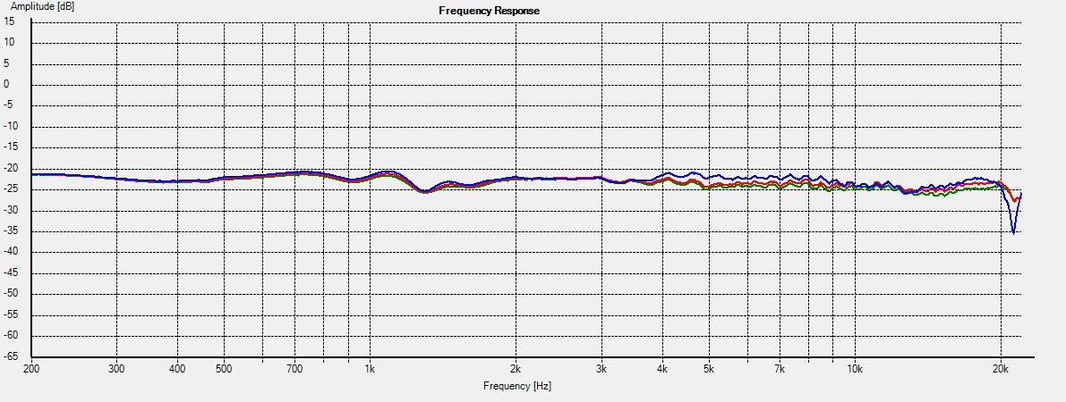

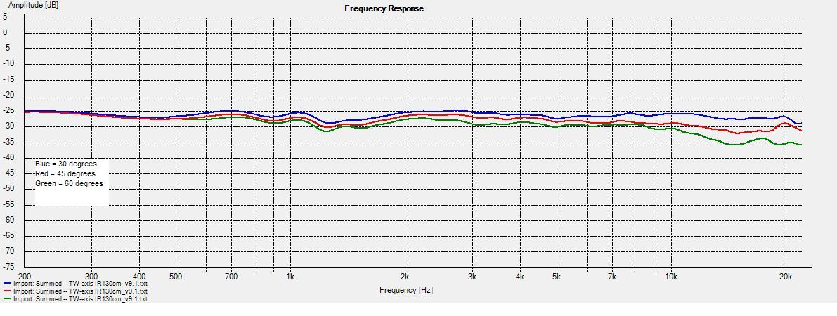

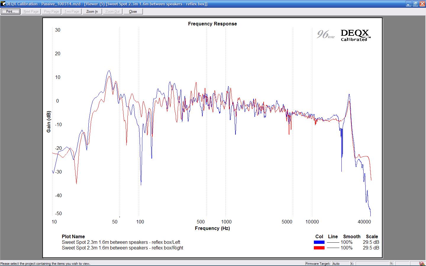

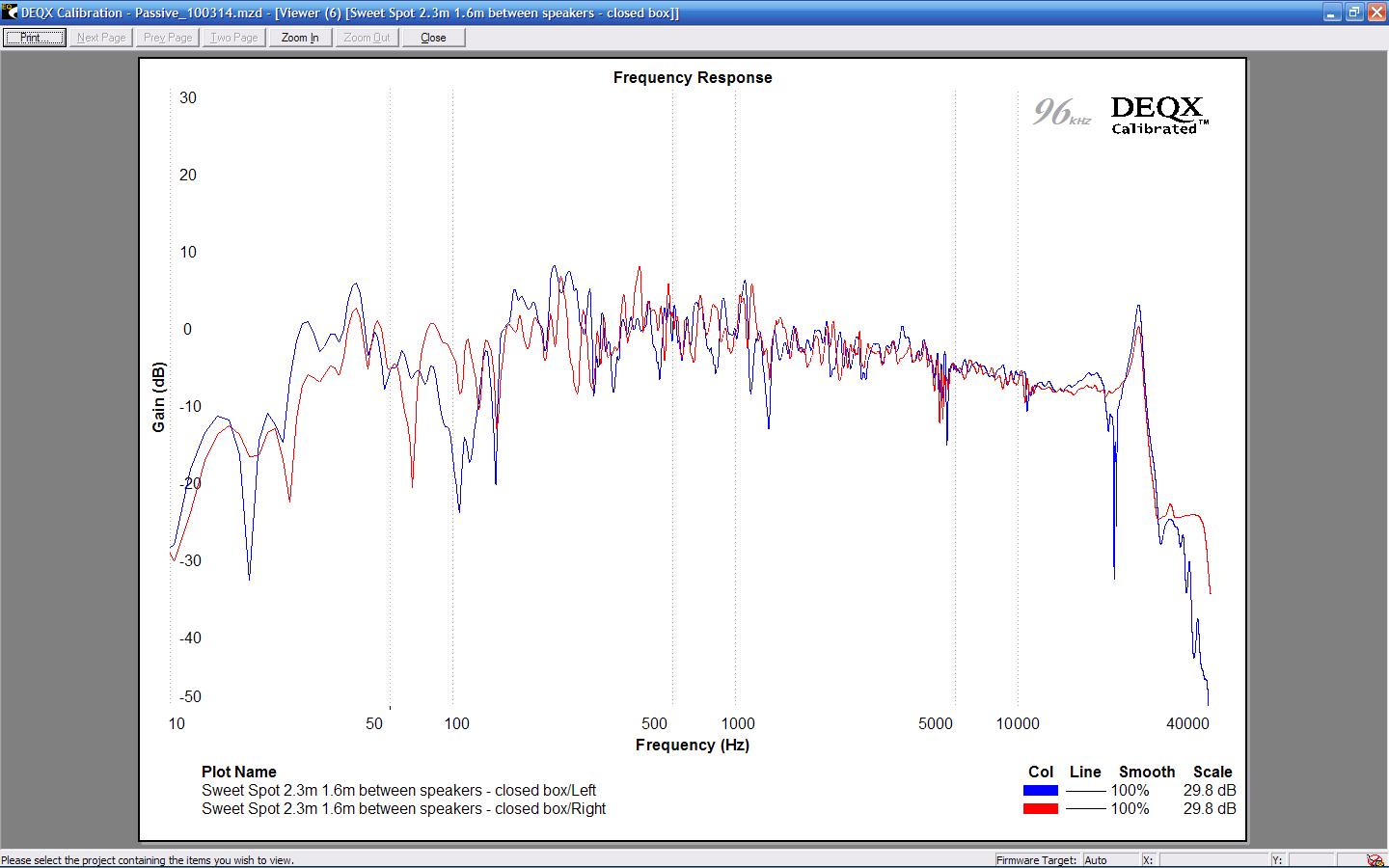

Hi maiky76,
Thank you for your nice comments.
Yes it’s correct I haven’t shared all my working material, especially regarding to the power response and voicing. I still haven’t broken them in yet, so I might change the tweeter level later on.

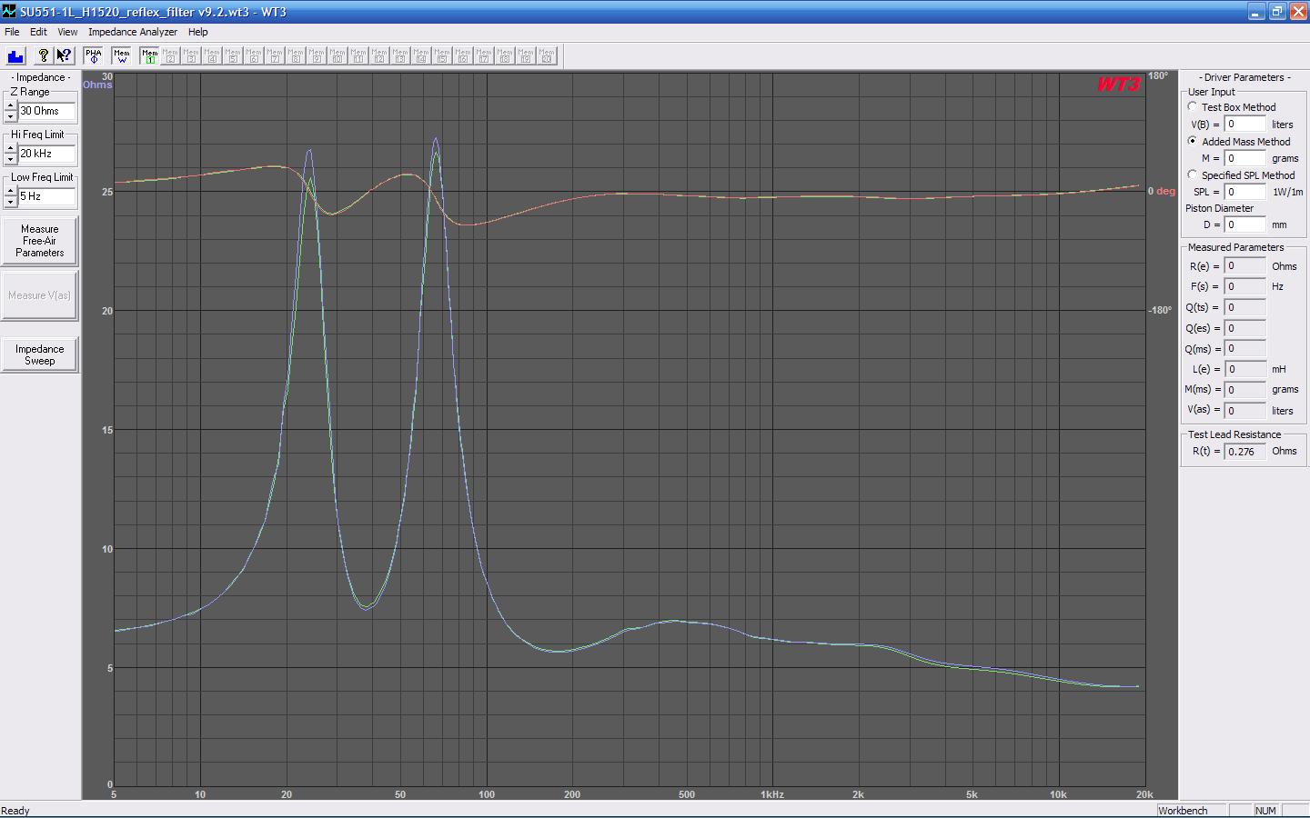

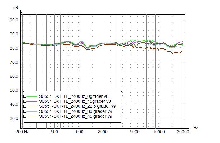

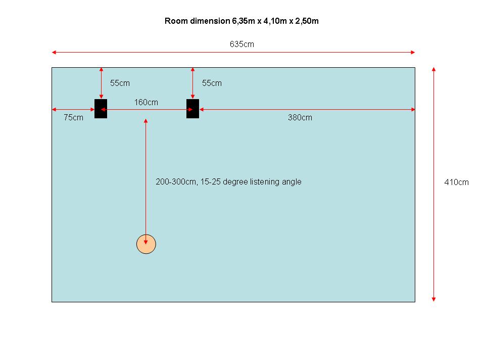

Comments about the power response:
Picture1 shows the average dispersion (direct sound) at 1m gated MLS anechoic measurement (valid down to 250Hz) of the finished speaker.
Picture3 and Picture4 shows the response at listening position with my room reflexions added. The response will of course be a bit different in a different loudspeaker setup and room, but would perhaps be a guideline of how the power response, direct sound and room reflexions (indirect sound) looks like. The measurements are done at 220cm and with a listening angle of 20 degrees.
The room measurements are done with my DEQX HDP-3 Pre-amplifier. The ceiling height is 250cm (see Picture2) and a heavy carpet is placed between my loudspeakers and my listening position. Observe the room modes between 10-200Hz. The SU551-DXT actually has a room response down to 30Hz (+/- 0db) in my setup. No real need for a subwoofer…. 😀
With the means I have to my disposal, I think the power response in my setup looks quite good in my opinion.
Picture1:
Tweeter-axis, 0 degrees, reference (blue)
Tweeter-axis, 0, 15, 22.5 and 30 degrees calculated average (red)
Tweeter-axis, 0, 15, 22.5, 30 and 45 degrees calculated average (green)
Picture2: Room and loudspeaker setup.

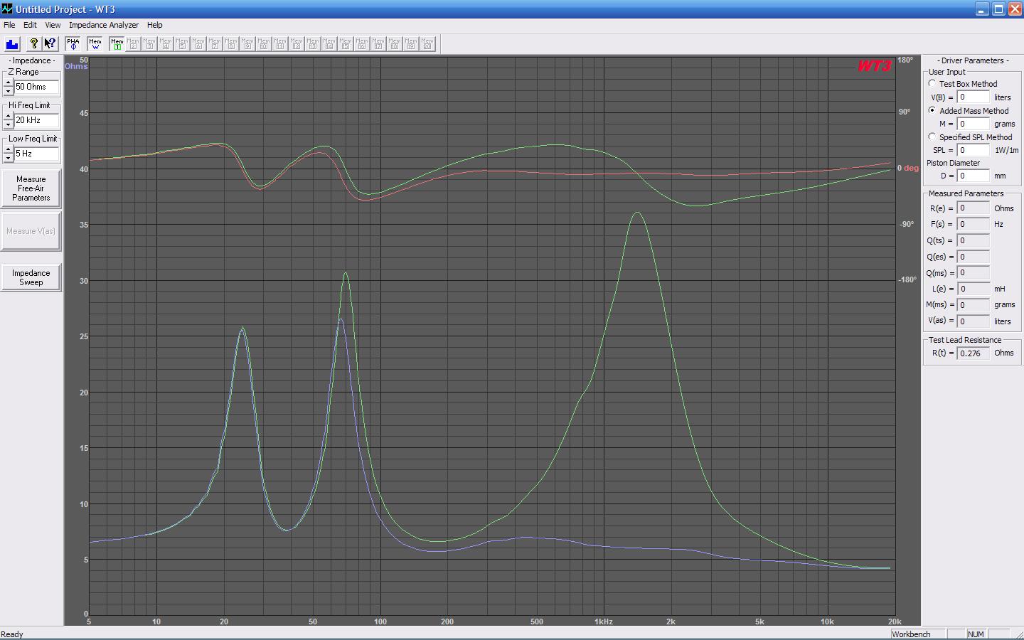

Picture3: Bass-reflex box – left speaker (blue), right speaker (red) 80db scale and 100% smoothing.
Picture4: Closed box – left speaker (blue), right speaker (red) 80db scale and 100% smoothing.
Tuning/voicing:
I’m thinking of lower the tuning of the bass-reflex to somewhere between 38-40Hz, since I have a room mode at exact the same frequency as my port-tuning (44Hz), hence the peak at 44Hz in Picture3. I’m also thinking about to adjust the tweeter-level up a bit. I chose to have an adjustable tweeter-level in this design to make the loudspeaker to work in different room setups.

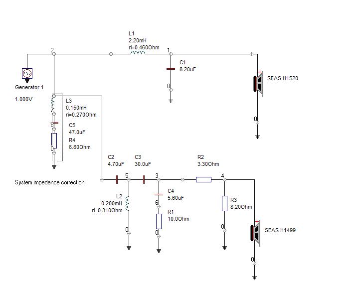

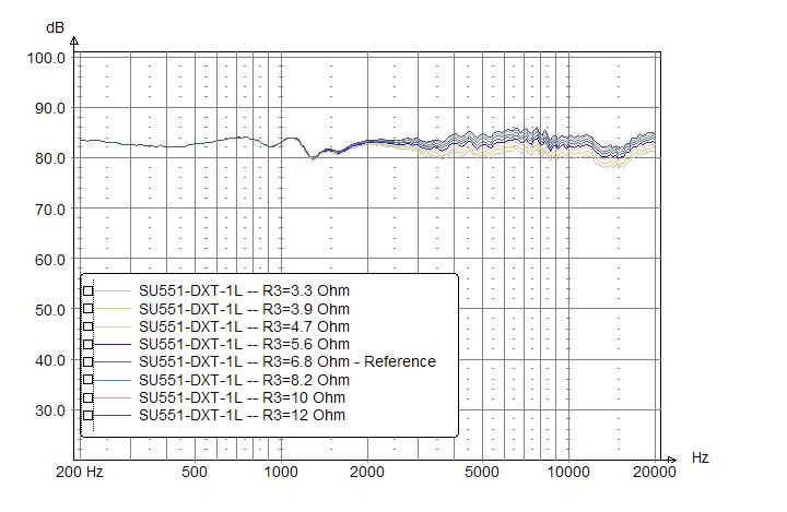

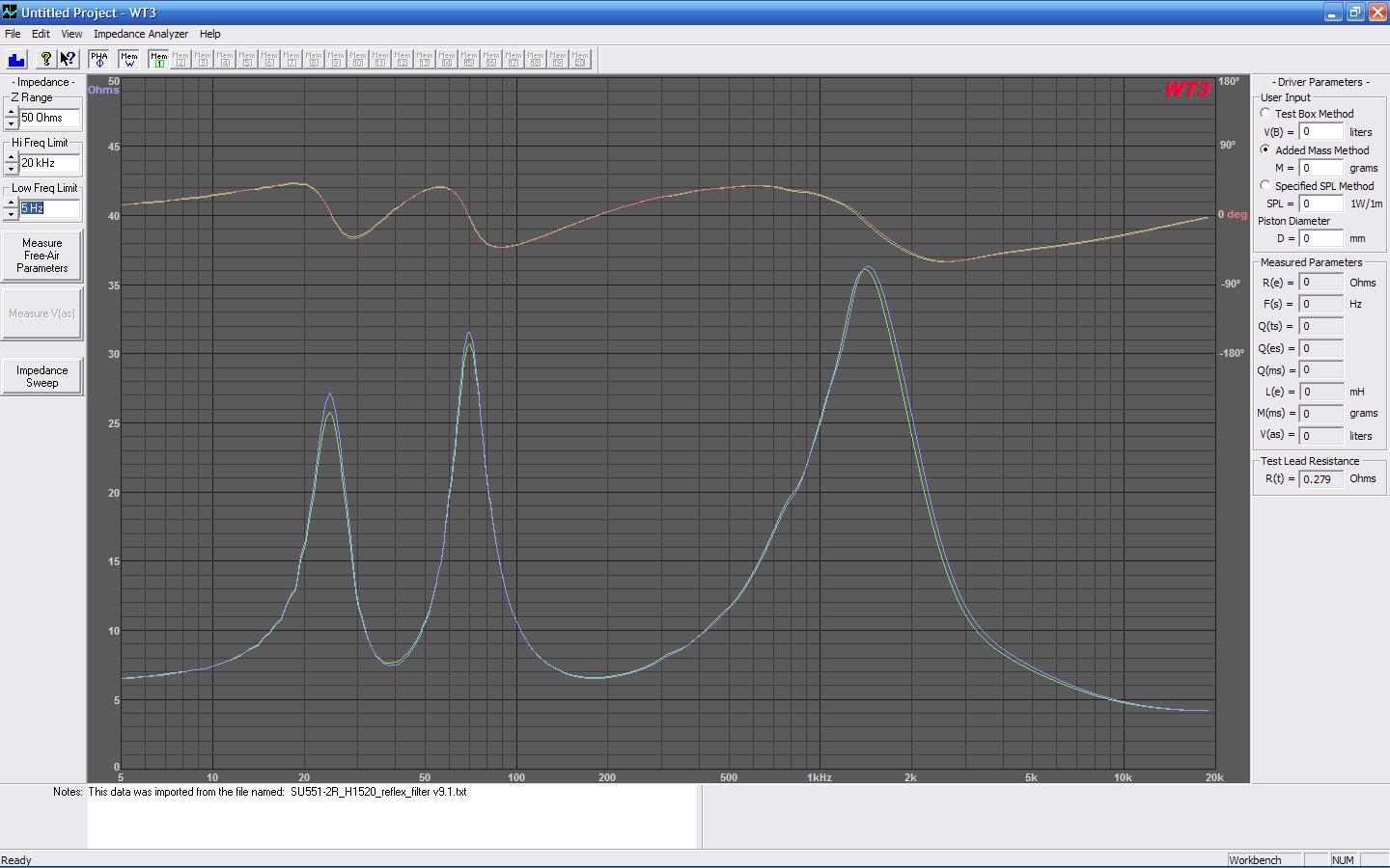

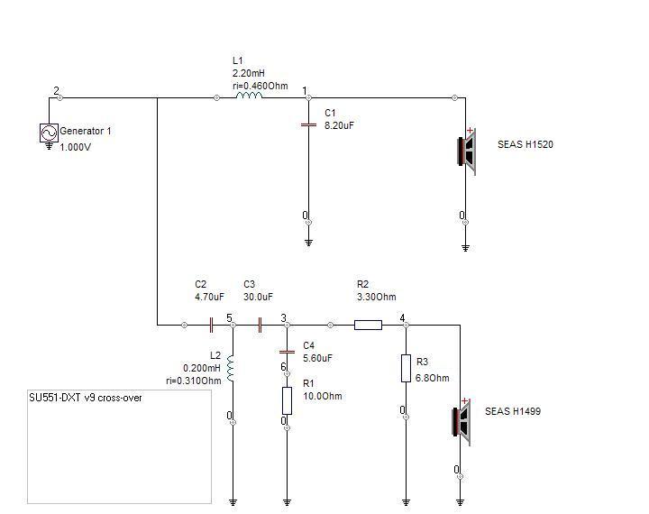

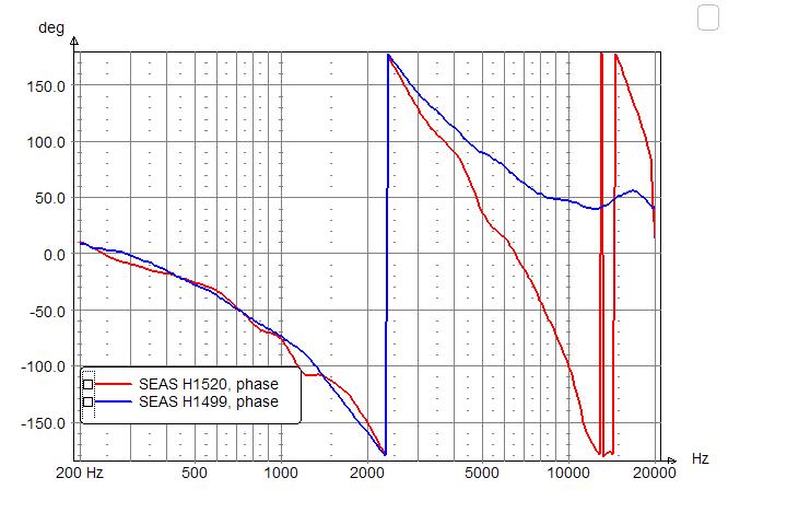

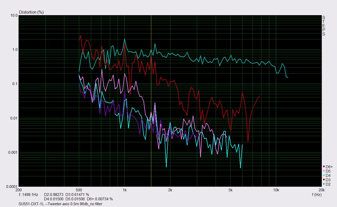

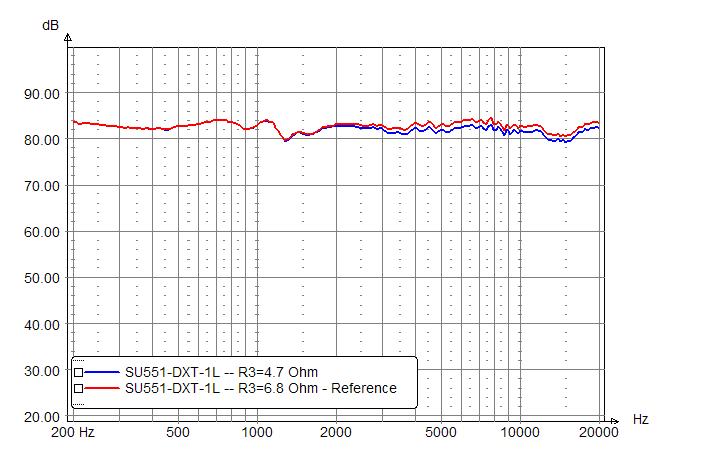

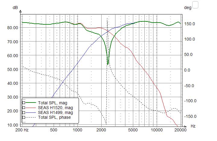

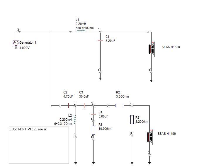

Cross-over updates:
I have listen and tweaked the tweeter level up a bit by changing the (R1011) to 1.8ohm and (R1051) to 3.4ohm. The speaker measures and sounds good, but not excellent in the current configuration. They sound neutral with a nice bottom end, but not as musical in the higher frequencies as I want. To be honest, I have mixed feelings about booth these drivers and here is a summation of my impressions:

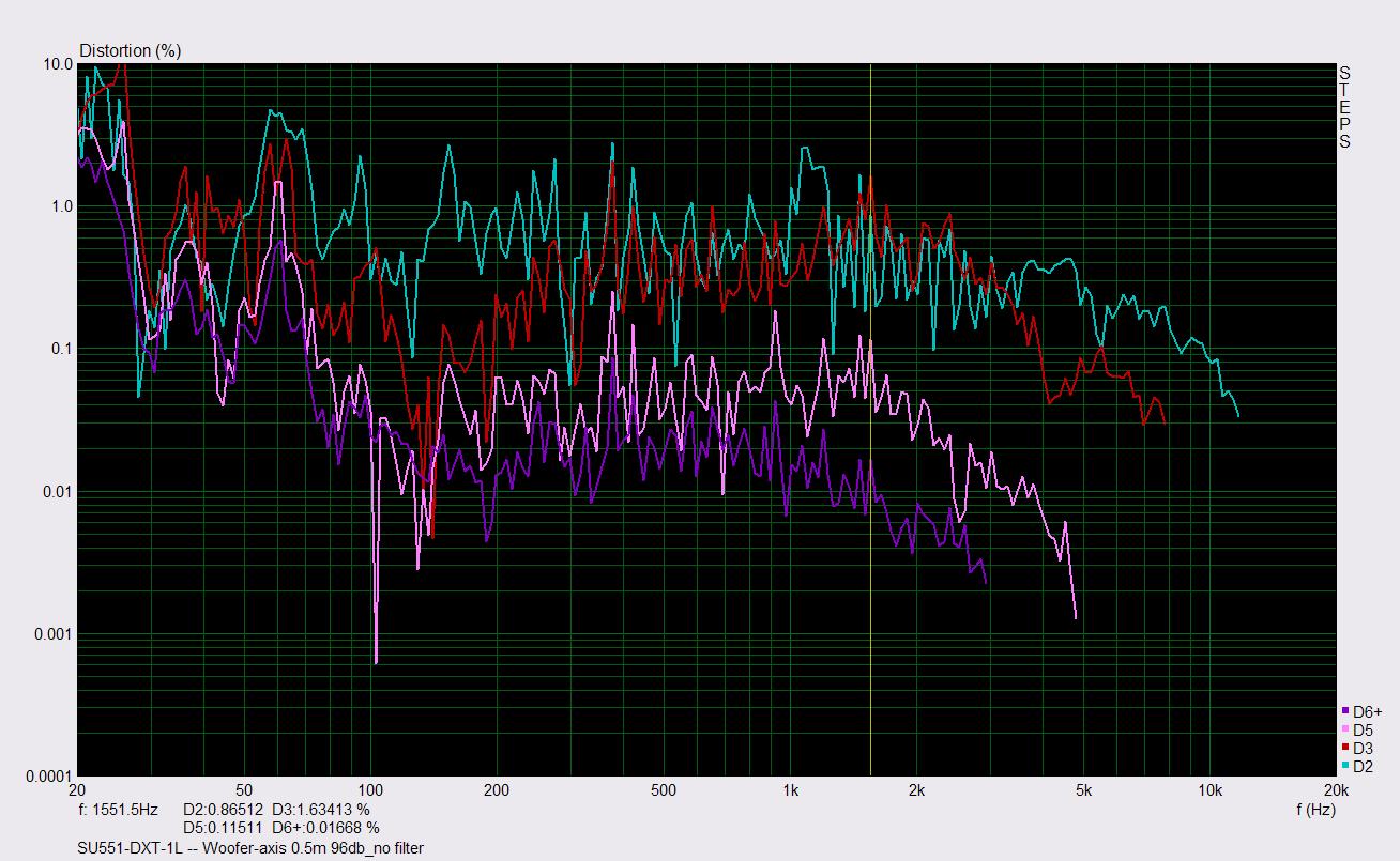

U16RCY/P (H1520)
+ Smooth frequency response without nasty cone-breakups.
+ Extended frequency response with a good dispersion up to 3000Hz.
+ Good bass performer.
+ Good distortion performance in the low bass.
- Ripples in the frequency response between 900-1400Hz
- The ripples between 900-1400Hz also show up in the impedance plot.
- Merely average distortion performance in the midrange.

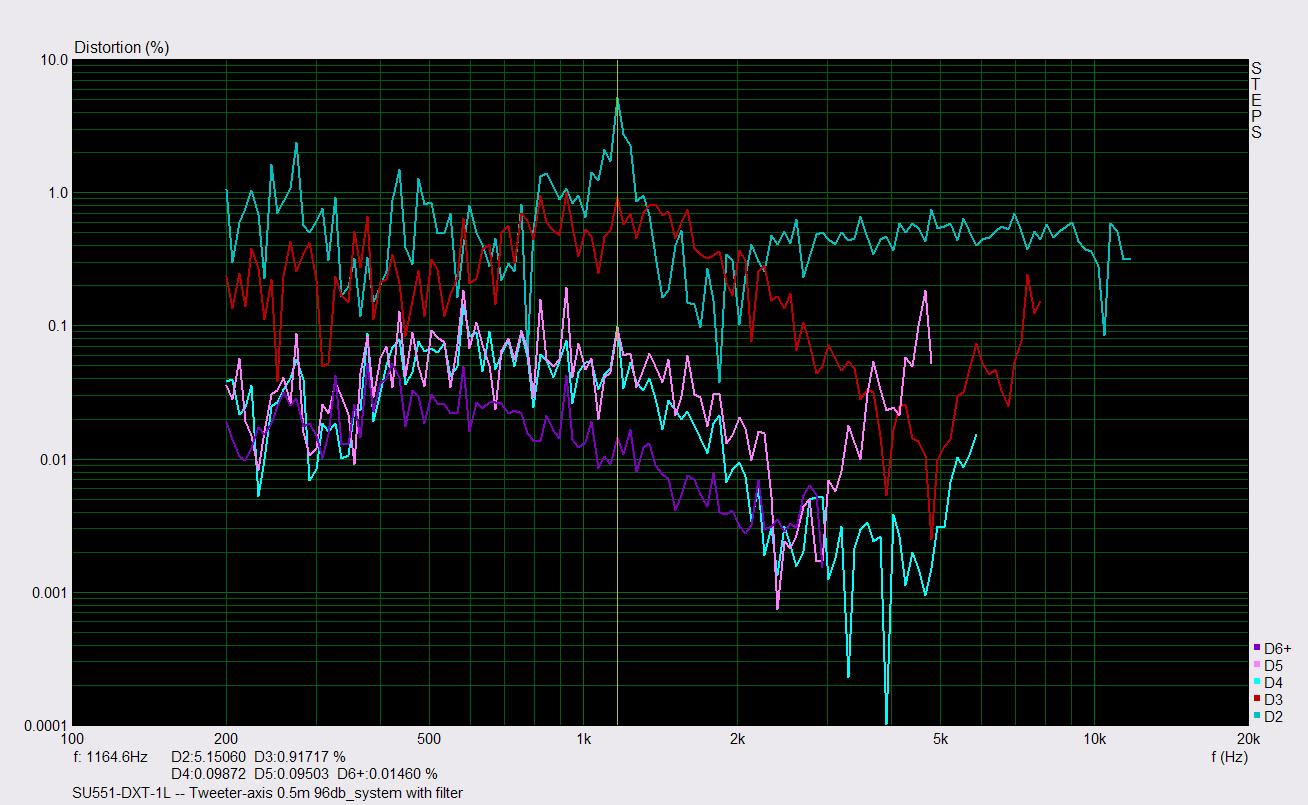

27TBCD/GB-DXT (1499)
+ Excellent off-axis frequency response and dispersion thanks to the DXT-lens.
+ Excellent low distortion performance with a usable range down to 1500-2000Hz.
+ Thanks to the DXT-lens, less noticeable baffle diffraction.
- DXT-lens diffraction issues centred around 13000Hz.
- Has a specific sonic character that lacks the top-end shimmer and sparkle (personal opinion).
- A bit tougher to tame and shape the frequency response than the average tweeter (personal opinion).
To sum it up, I wish SEAS had fixed the ripples in the U16 response and that they had thrown in some copper in the motor to reduce the distortion. I think the DXT-lens concept has a great potential, but I’m not quite convinced that the driver SEAS chosen to mate with the DXT-lens brings out the best of the concept. 😉

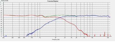

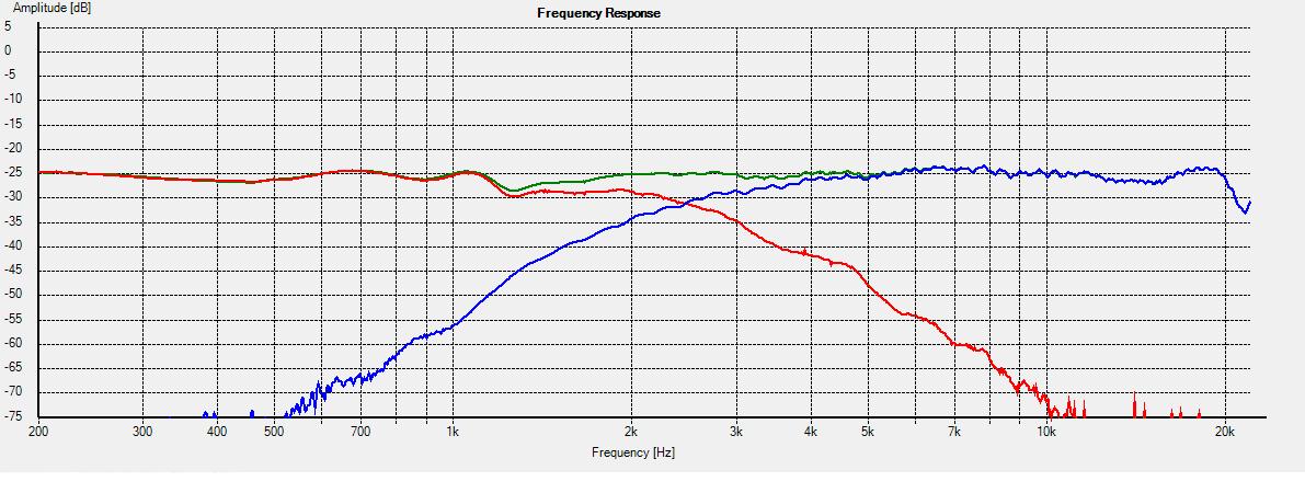

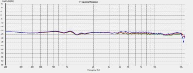

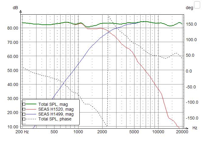

I’m currently working on a completely new cross-over for the tweeter section. The woofer cross-over is the same as before. The cross-over frequency has been lowered a tiny bit to 2400Hz and I have used a different approach to tame the frequency response of the tweeter. The phase integration between the drivers looks as good, if not better an the v7 of the cross-over. The pictures below show the modeled frequency response for the v9 of the cross-over.
Picture1: New v9 cross-over.

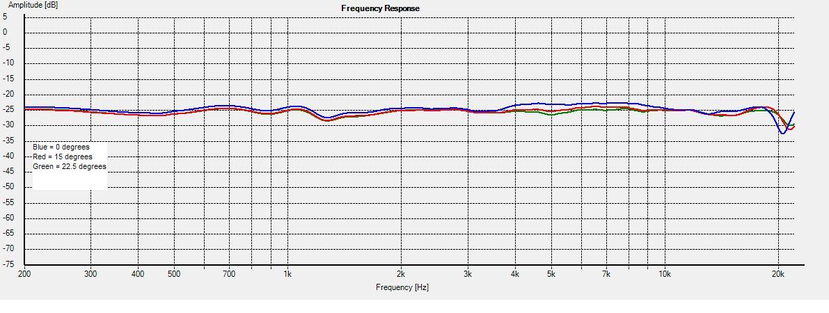

Picture2: Tweeter-axis, 15 degrees, 1/12th octave smoothing.
Picture3: Tweeter-axis, 15 degrees, reverse null, 1/12th octave smoothing.
Picture4: Tweeter-axis, 15 degrees, individual driver phase tracking.

Picture6: Chamfered cut-out on the backside of the baffle.
Notes:
In picture6: I just want to point out the importance of chamfering the baffle backside of the woofer to let it breath properly. The speaker is optimized for a 15-30 degree listening angle. In other words, no toe-in.
I’m also playing around with different bass-reflex tuning options and currently something around 40-42Hz looks optimal. I get back with new distortion and frequency measurement as soon as I have built and listened to the new cross-over and hopefully it sounds even better 🙂
Picture5: Tweeter-axis, 0, 15, 22.5, 30, 45 degrees, No smoothing.
Notes:
/Goran
Cross-over updates:
I’ve built the new cross-over v9.1 (see picture1) with a minor change from v9. The R3 changed from 8.2 Ohm to 6.8 Ohm as the reference tweeter level (see picture2) I’m thinking of implementing a rocker-switch on the backside of the cabinet so I can switch between 4.7 Ohm and 6.8 Ohm (see picture3).
Cross-over v9.1 listening impressions:
I must say wow… 😀 Now everything falls in place with a huge spacious soundstage with a nice tweeter timbre. The tweeter has a neutral top-end and has a non-fatiguing sound characteristic.
It’s strange, amazing and a bit fascinating that two different tweeter cross-over’s (v7 and v9.1) can sound so different, yet have similar response curves. The v9.1 has much more musicality compared to the v7. In my opinion, the SU551-DXT is now an excellent loudspeaker. It’s just a matter of tweeter level adjustments to fit your room and taste.
Observe that the phase integration between the drivers is unchanged when changing the R3 between 3.3 Ohm and 12 Ohm. The impedance from 15kHz to 20kHz is changed from min 4 Ohm to 4.5 Ohm.
I’ll be back by the end of this week with new measurements.
Picture1: Cross-over v9.1 schema.
Picture2: R3 Tweeter level adjustment.
Picture3: R3 tweeter level adjustment 4.7 Ohm and 6.8 Ohm.
/Goran

Cross-over updates and distortion measurements:
I have done a minor change to the cross-over, v9.2 (Picture1). The L3, C5 and R4 are optional and flattens out the system impedance (Picture2) and the electrical phase for those who use tub-amps or have less powerful amps. I cannot say that I hear any difference with my power amps, but I think it’s essential to have it in a tube-amp setup.
I have done a set of distortion measurements of the raw drivers without the cross-over (Picture5-6) and the whole system with the cross-over v9.1 (Picture7). The measurements where done at 0.5m/96db with the drivers mounted in the actual baffle and enclosure. 0.5m/96db corresponds to a 1m/90db measurement, e.g. a normal listening level for most people 🙂
Picture1: Cross-over v9.2 with optional system impedance correction.
Picture2: Blue = with impedance correction and green = without.
Picture3: Blue = 2R, green = 1L, impedance variation between left and right loudspeaker.
Picture4: Blue = 2R, green = 1L, impedance variation between left and right loudspeaker with system impedance correction.
Picture5: Tweeter distortion without cross-over on tweeter-axis.
Picture6: Woofer distortion without cross-over on woofer-axis.
Picture7: System distortion with cross-over v9.1 on tweeter-axis.
Comments:
The impedance variation between left and right speaker is minimal (Picture3-4).
The H1499 is a nice low distortion tweeter down to 2000Hz. It’s probably even possible to use it down to aprox. 1500Hz with a bit elevated D3. There is no problem at all to use the tweeter down to 2400Hz, as in this application. 😉.
The H1520 has an average distortion through the midrange, a bit elevated D3 to be perfect. It has good distortion numbers at lower frequencies. The cone edge resonance at 1200Hz shows up as elevated D2. Overall not to bad, but far from the Excel version (W16) in the distortion department. Though the W16 costs 3 times more 😉
The system distortion shows a spike for D2 at the woofer cone edge resonance. Otherwise the D3 is kept below 1% throughout the midrange. The second order harmonics (D2) should be harmless and the third order harmonics (D3) is controlled. The D3 spikes at 9000Hz and the D5 spikes at 5500Hz are due to the tweeter cone-break up at 27000Hz, but are kept around 0.2% and shouldn’t be an issue.
Comments:

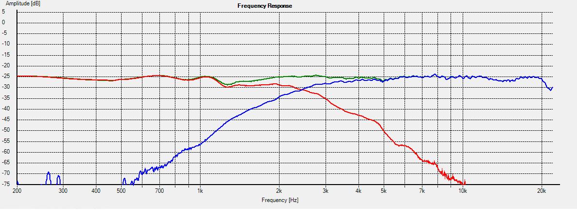

Frequency measurements:
It has been a while since the last post, but I have been busy building and tweaking a new “computer audio transport”. The speaker is finished and sounds great. In this post I will show some of the frequency measurements of the finished design and cross-over and in the next post I will sum up the design.
Picture1: Tweeter-axis, 0-22.5 degrees, 1/12 octave smoothing.
Picture2: Tweeter-axis, 30-60 degrees, 1/12 octave smoothing.
Picture3: Tweeter-axis, 15 degrees.
Picture4: Tweeter-axis, 22.5 degrees.
Picture5: Tweeter-axis, 30 degrees.
Picture6: Tweeter level options.
Comments:
Picture3-5: The speaker is optimized for a listening angle of 15-30 degrees.
Picture6: Tweeter level options. I personally use R3=6.8 Ohm and 8.2 Ohm.
Comments:
