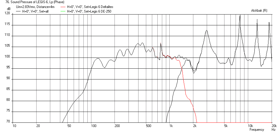

Here is what you get if you add a B&C DE-250 CD feeding a very short 2.5cm long transition duct from the CD throat to a 2.5cm wide x 50 cm tall back vertex. I also added a compression chamber between the Deltalites with an injection port leading from the chamber (formed between driver cone and horn walls) at the same location as before (17.3 cm axial distance). I estimated the chamber volume as 4 liters with a 10 cm dia injection port (or equiv area slot) going through 18mm plywood as the port length. This compression chamber and port increased the mid horn bandwidth into well above 1kHz (vs 500 Hz previously without). This is needed to properly XO with the DE-250 which has a recommended XO point at 1600 Hz. I set the XO freq at 1600 Hz, added 4 ohms of padding to the CD and gave it a 6.8uF high pass shelf to boost upper end response (this can all be done in DSP if run actively).
It is not a bad start given that I threw this together by adding the CD and makeshift transition duct. The CD will appear to have horn "honking" and this can only be solved by having a real horn profile or centerbody phase plug vs. a simple V geometry. A tractrix perhaps? (this may be useful as a point to start a design: http://www.volvotreter.de/downloads/Tractrix_v1.4b.zip )
Here is the Freq Response with 2.83v input at 4 meters away to give space for the mids and highs to integrate (that is some wicked sensitivity there):
attachment.php

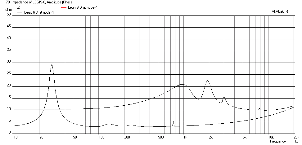

Here is the Impedance:
attachment.php
Here is the code if you want to play with it:

I will still at least try out "Synergizing" these, when they are ready: 🙂

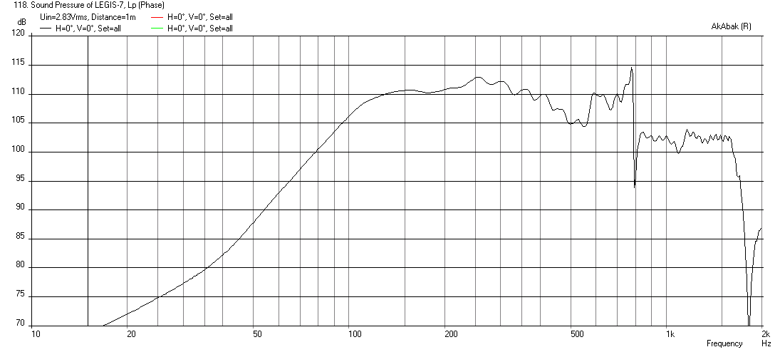

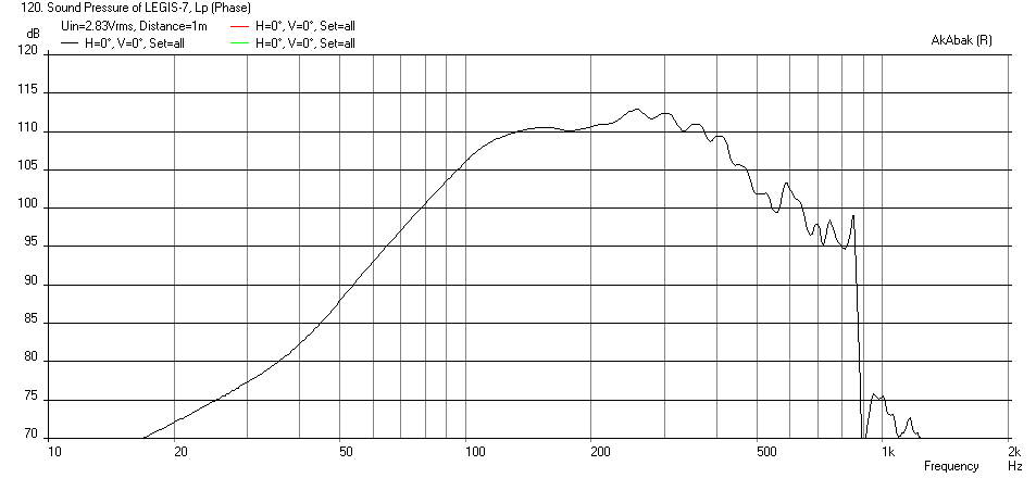

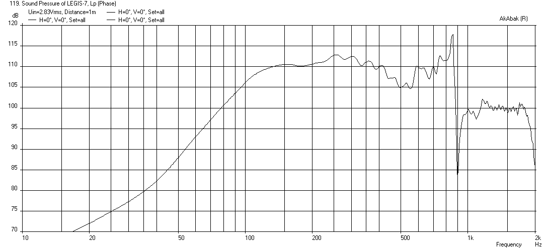

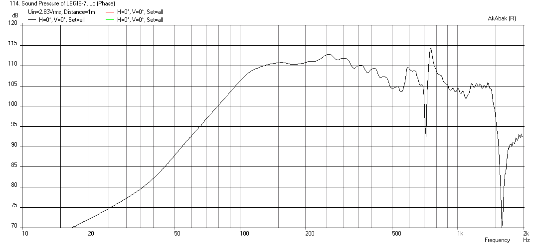

Legis,

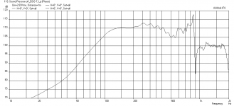

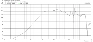

The horn you describe above sims pretty well. I also played with the port injection locations (assuming 12.5 cm dia port and 4 liter driver front chamber). I have it at 17.2 cm, 15cm, and 13 cm and it seems to flatten response to 500 Hz. The 30 liter rear chambers have to be heavily stuffed (aperiodic) to achieve a Q=0.05 to damp out back reflections. No low pass or high pass filters were used.
Here is the prediction for the 17.2 cm port injection location:
attachment.php
Here is the 15 cm port injection location:
attachment.php
Here is the 13 cm port injection location:
attachment.php

Thanks for the sims! I don't quite like those resonances the ports introduce. Does non-circular port reduce thoise resonances? I planned to use "keystone" shaped ports or something quite similar:
I made a quick hack and placed the JBL 2446J behind the horn without any mouth pieces nor transition smoothing, horn placed un-optimally on the floor etc.
Here's the result at ~1,8m distance. I was surprised how well they measured and sounded.
(the last octave resonances are natural for the original JBL's ribbed diaphragm of 2446J, not related to horn itself)
Legis,
The resonances are above the 500 Hz XO you intend to use. If you you apply a -24dB/oct LPF at 500Hz you get this, which I think is very usable:
attachment.php
Or are you concerned about those little 1dB ripples from 250 hz to 500 Hz?
Your CD and horn combo measures very well - looks like it should integrate very well when used with a 500 Hz XO for the other drivers. The overall high sensitivity of the system is probably in the 110dB range is fantastic. Could probably use a 2 watt amp 🙂
Regarding keystone port holes, they may help but Akabak is 1-d model and cannot get that fine detail. V-slit with same CSA as the round port may be useful too. Also, a frustrum (cut away back side wood until a sharp edge remains on the interior wall of horn) has also been shown to help.
Good luck! It looks like it really is taking shape. This will be an incredible system when done.
