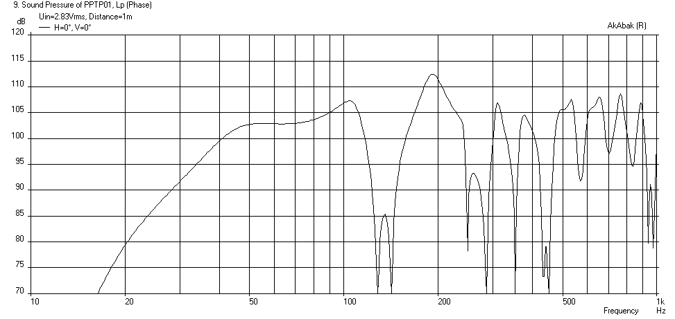

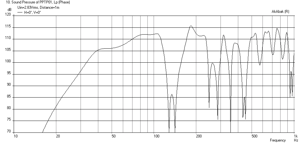

Legis,
I added a front horn with geometry you specified. Here is a before and after result of the sim. There is indeed gain but it is not flat - biased towards the upper end of the bandwidth before the cutoff.
Without Front Horn:
429553d1406033214-study-dipole-cardioid-bass-horn-pptp01-bms-15nw860-spl-2.86v-1m-no-front-horn.png
With Front Horn:
429554d1406033214-study-dipole-cardioid-bass-horn-pptp01-bms-15nw860-spl-2.86v-1m-front-horn.png

Quite good gain though, for the same diaphragm displacement... Around 3db at 20hz and 4-6db 50-100hz(and slightly better anechoic extension)? Did you use HPF? Im not gonna use one...
