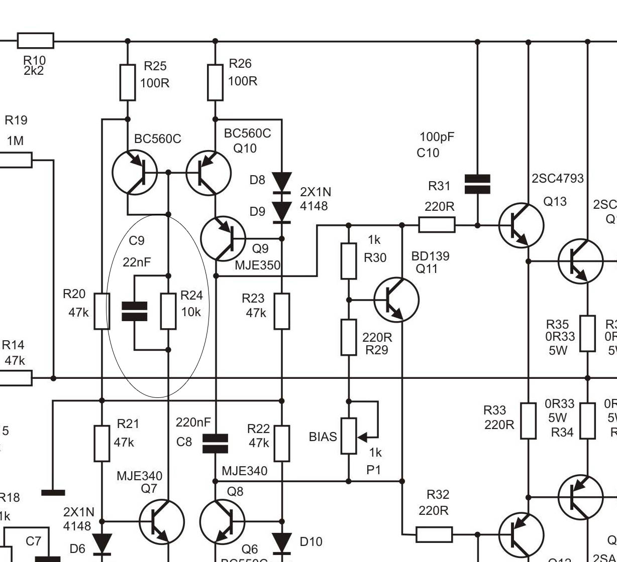

I'm talking about R24 10k & C9 22nF on Apex's SR200V2 schematic.
I'm just test for a while with lower voltage & that resistor quiet warm, you use higher voltage and maybe if it is 0.25w resistor it will burn in second.
Please check :cool:

The omission of the RF attenuation capacitor will have an effect on the way the input transistor sees the outside world.
But I would not expect the amplifier to oscillate (output Zobel overheating) just because the RF cap was missing.
There must be some other problem that is hiding just under the surface.
Please check :cool:
R24 (10k) must be hot and I suggest to use 1W or higher.
Regards

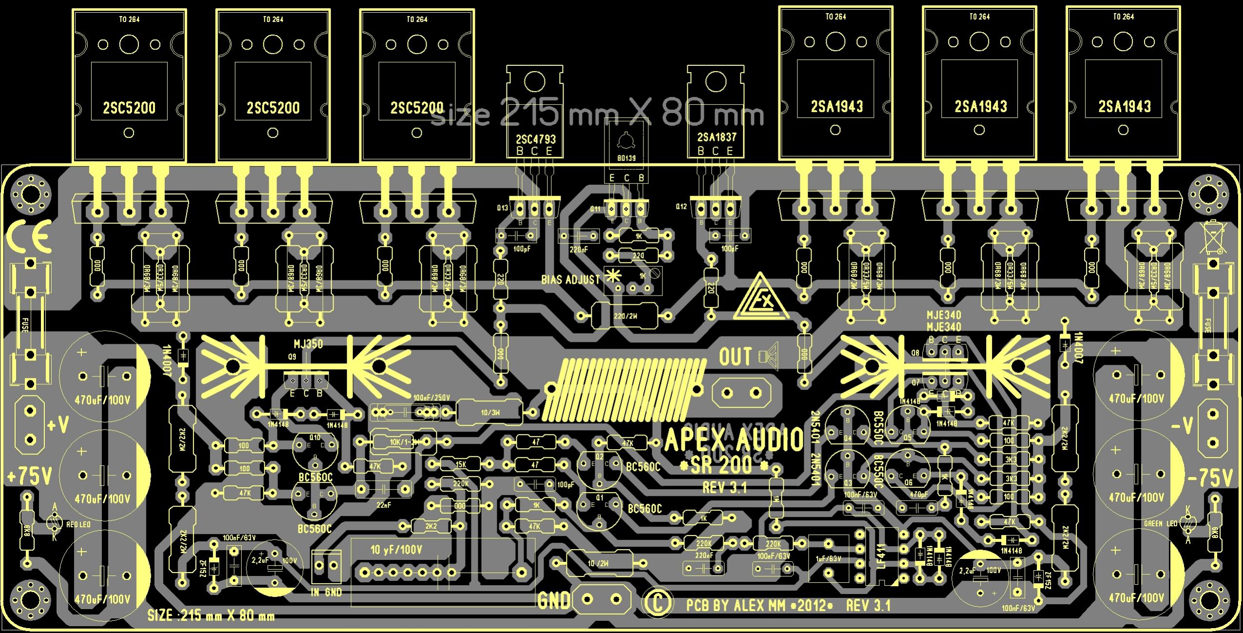

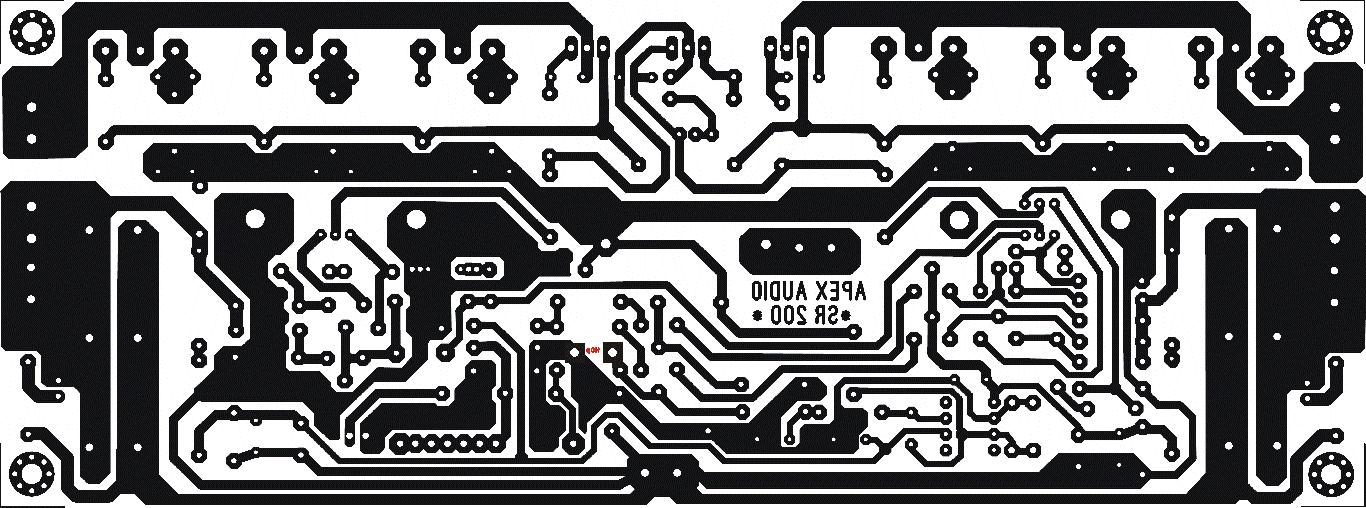

Sir Alex mm, is it possible to revise pcb version 3.1 and add the missing C2=100pf and the C7= 470pf series with R18= 1K, because it is not present in the pcb version 3.1. and my brod Junie got a problem with those which give him instability until he found that those parts are missing on the pcb 3.1.
best regards,
mj777
...... to layout this rev.3.1 I spend days and hours from my free time , all the time I need Q.C and this is your contribution to find mistakes , errors and let me know and corect my PCB . I'm glad to help DiyAudio comunity with my skil ......:)
All the best ,Alex.
